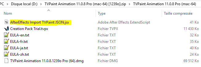

There's a misconception on your part I think: TVPaint creates a JSON file (an universal data storing format), not a JSX file (which is a script file, used in After Effects).
The AfterEffects Import script (the JSX file) can be found on the archive you get when you download the software from your User Account:
That's the file that you should run in After Effects, not the JSON file :)
