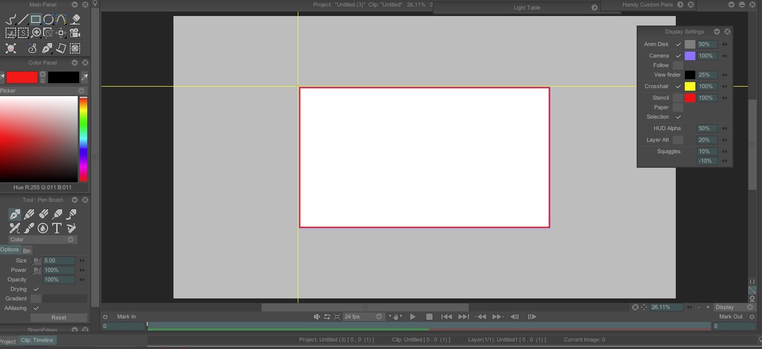

I did it this way: in a 1920 x 1080 project, I filled a layer completely with colour. Then I modified the project to the bigger size, then used Border FX on the rectangle to create the outline.

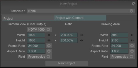

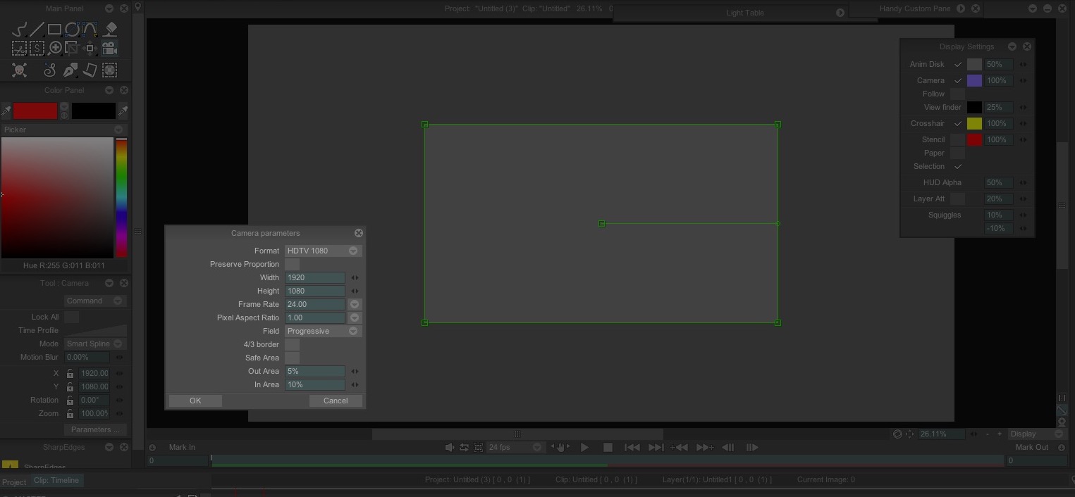

If using TVPaint Pro create a new project , 1920 x 1080, with Camera at 200% overscale , so overall size of project is 3840 x 2160 , but the Camera view will show 1920 x 1080.

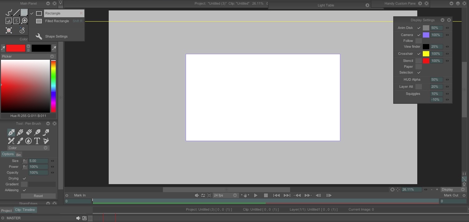

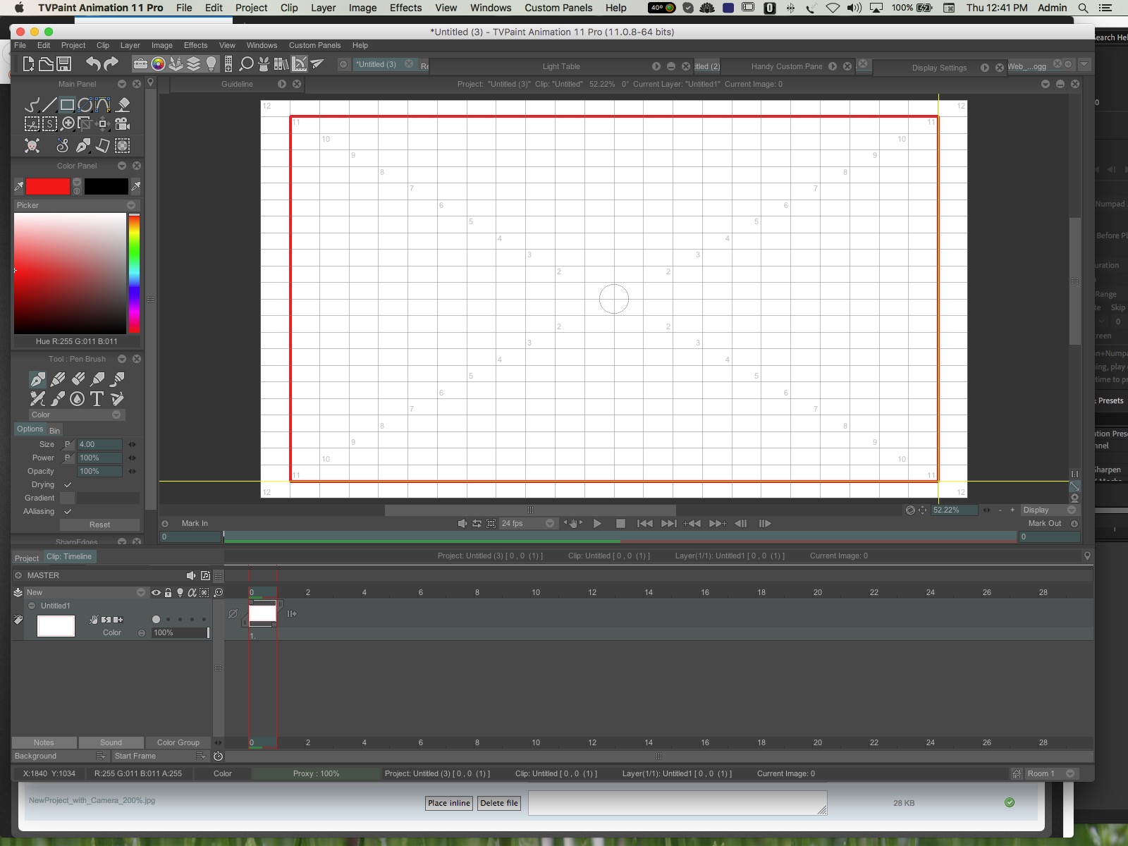

If you want you can take the Rectangle tool and draw a rectangle field guide that matches the 1920 x 1080 camera view. Keep this on a separate layer that you can toggle on and off.

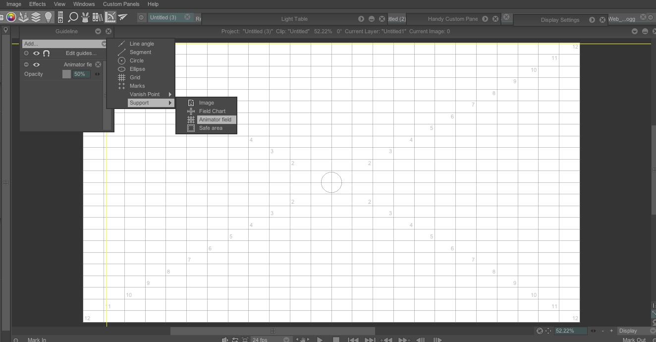

If you don't have TVPaint Pro with the Camera tool , then with TVPaint Standard you could go to the Guides and add the Field Guide , then use that to draw your 16:9 field guide using the rectangle tool.

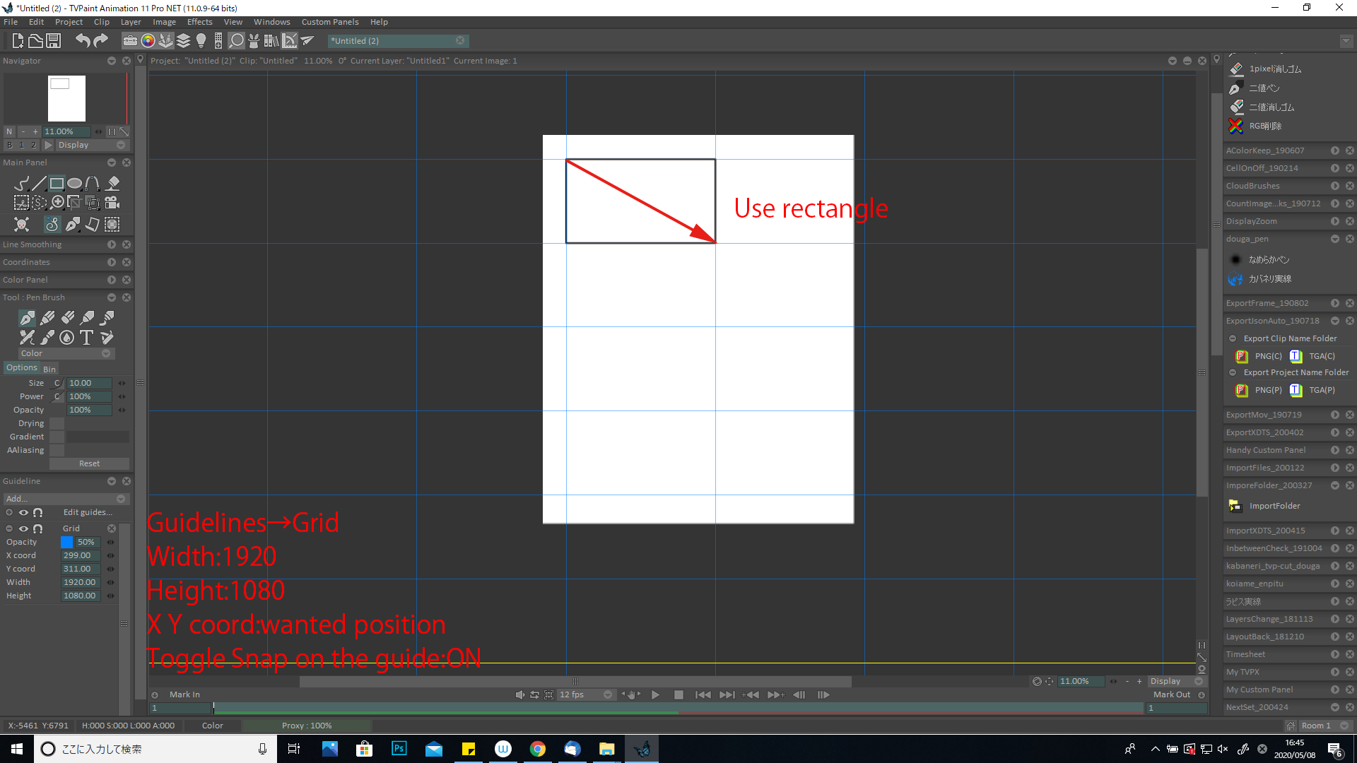

I feel that the Sven method is the shortest way.
I will attach a manual method.
