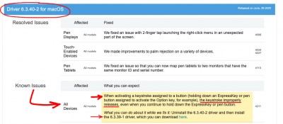

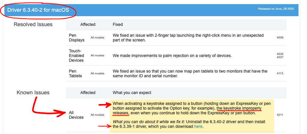

UPDATE: here is the ANSWER to the problem. It is an issue with driver 6.3.40-2.
I went back to read the release notes on the Wacom support site and here is what I found:
When activating a keystroke assigned to a button (holding down an ExpressKey or pen button assigned to activate the Option key, for example), the keystroke improperly releases, even when you continue to hold down the ExpressKey or pen button.
What you can do about it while we fix it: Uninstall the 6.3.40-2 driver and then install the 6.3.39-1 driver.
Now my Flip Manually keyboard shortcuts work when triggered from the Wacom Express Keys . :D
So the solution for people using Mac OS 10.14 (Mojave) and below is to uninstall the 6.3.40-2 driver and use the 6.3.39-1 driver.
(I am assuming for those using Catalina or Big Sur the current Wacom driver 6.3.42-1 should work properly for executing keyboard shortcuts from the Wacom Express Keys.
Driver 6.3.42-1 is incompatible with Mojave , but the older 6.3.39-1 works.)
