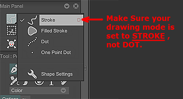

Hi all,
I hadn't been using TV paint for a couple of months , and I did update Monterey to 12.4 recently, so I don't know if that's creating the issue, but all my brushes are acting weird: when I draw slowly it sort of seems ok, but if I draw fast I get a series of dots, and the faster I draw the further apart these dots are.
So this is not lagging but it looks like some sort of spacing issue. Some brushes are hardly visible at all. Note: This happens with pen ánd with mouse!!!

martimiz wrote: 04 Jul 2022, 14:22 Hi all,
I think it is your drawing mode was accidentally switched from Stroke to Dot . Make sure yours is set to Stroke.
Set to STROKE not DOT.png (59.52 KiB) Viewed 3728 times

Yessss!!! That was it - no idea why, I never use it...
Thanks so much for your quick reply!
