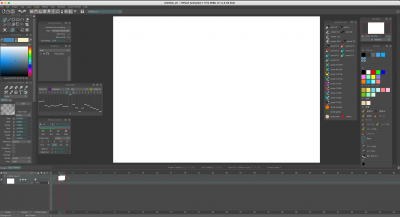

Trying to figure out how I can get you a video, but if you take a look at this screen shot I don't have that button. I think it's something with the canvas setting.
( Screen shot preview doesn't seem to preview, I'll attach also )

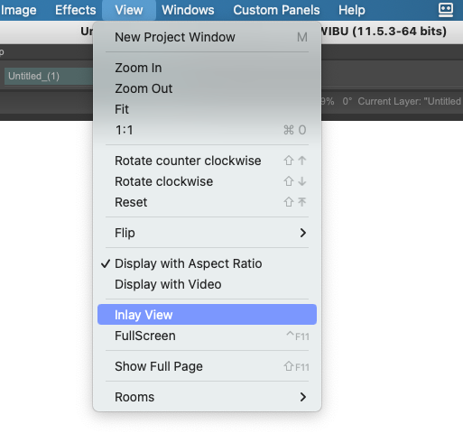

It does appear as if your interface is stuck in Inlay View. As of version 11.5.3 I don't believe that Inlay View has a default keyboard shortcut assigned to it , but you may have unintentionally selected Inlay View under the View Menu. Deselect Inlay View from the View Menu to get back to normal.

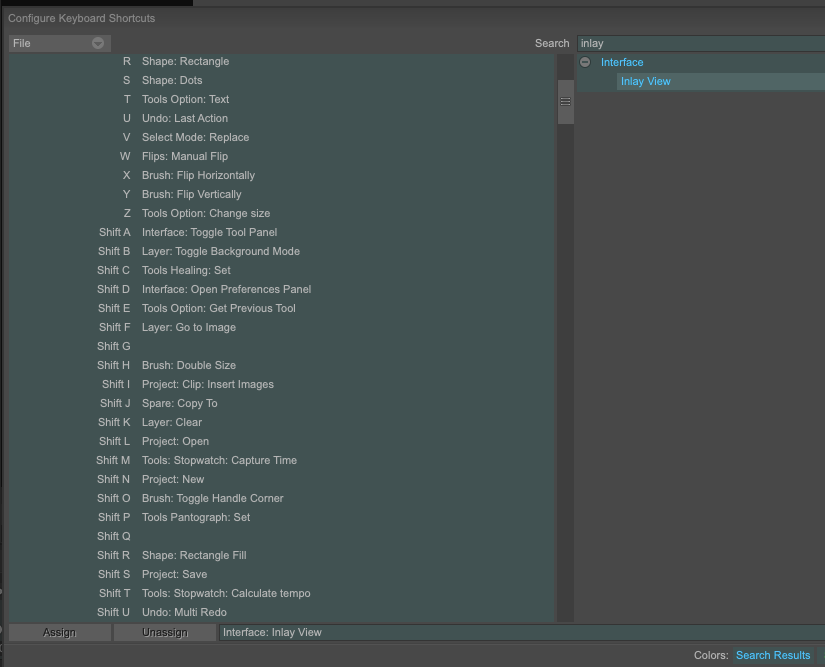

If you wanted to assign a keyboard shortcut to it , go to Shortcuts > Interface > Inlay View and assign an available key to it.
