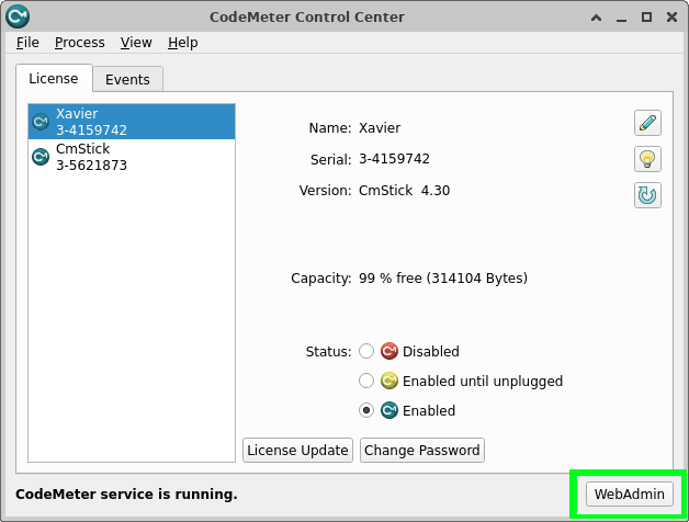

It says "entry not found", meaning the Codemeter driver didn't found any license.
On the client you need to configure the license server IP. Open the Codemeter control center, click the webadmin button (on the client computer) :

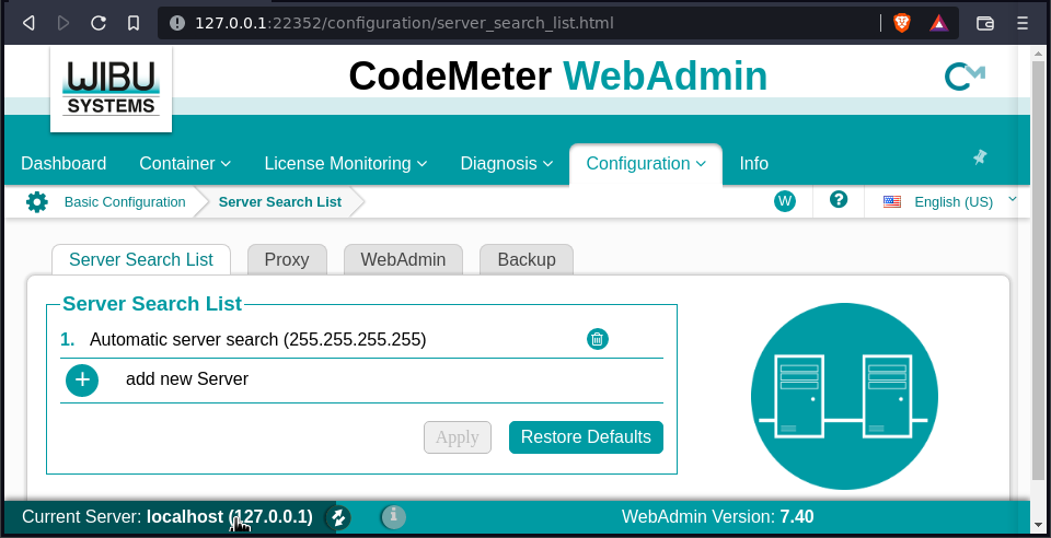

A web page should open for administration. Select the license server from the bottom left on the page :
