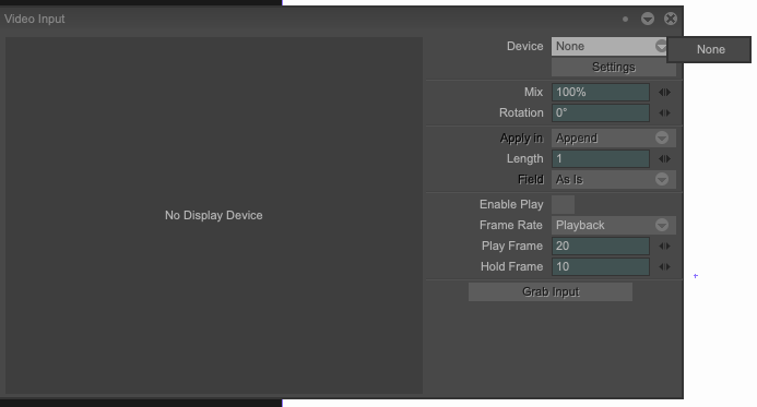

Video-In is not working at all for me. I have my Logitech C930e webcam plugged in to USB port on my computer , but TVPaint Video Input panel does not detect the device.

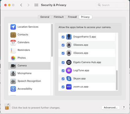

Other applications I have on my computer (iGlasses, Webcam Settings, Dragonframe) can detect and use the Logitech C930e webcam. Only in TVPaint the webcam does not show up in the Video-In panel. The only option shown in the Video Input panel under Device is "None".
The problem exists in versions 11.7 and 11.5.3. I did not notice it before now because I have not been using Video In for frame capture for a very long time, but recently I have been hired to work on a project animated traditionally with pencil on paper and I need a way to capture my drawings for making a pencil test. I have the Logitech webcam mounted on a copystand/downshooter and I was planning to frame capture my drawings into TVPaint using the Video In panel. (then once the drawings are captured into TVPaint I can Scan Clean them and make small fixes/adjustments in TVPaint using Transform/Warp tools without having to re-capture the drawings. It's very convenient). Although not as versatile for my purposes I will use Dragonframe to make pencil tests for my current project , but I hope the Video-In function in TVPaint can be fixed soon.

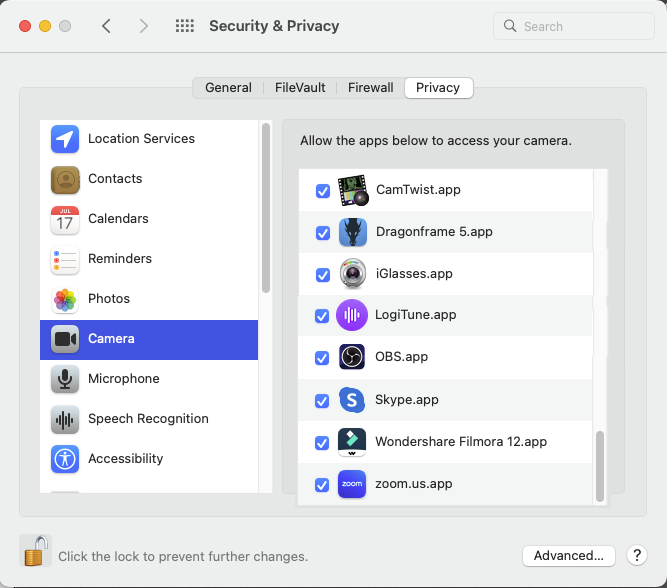

Same for me on MacOS Monterey 12.5, Intel Mac Mini, TVPaint 11.5.3 and 11.7. Under System Settings > Privacy > Camera, I see several other apps that have been granted access to my camera , but as you say, there does not appear to be an option to add a program (TVPaint) to give it access to the camera. I don't recall TVPaint requesting access to my camera.
I suspect that TVPaint video input has been broken since MacOS Catalina was introduced. As I recall , video capture in TVPaint still worked for me (with my Logitech webcam) when I was on MacOS Mojave ... but it's been a while since I needed to use Video-Input , so maybe it was broken before Catalina (?) . I didn't switch from Mojave to Monterey until earlier this year. (I skipped Catalina and Big Sur.)
Re: Video Input not working in 11.7 (or 11.5.3)
ernesttx wrote: 04 Dec 2022, 13:24 I'm not seeing a camera as well. I don't recall if TVPaint or OS prompted a message to "allow" camera connection. Checking System Settings > Privacy > Camera, I see 2 other apps that have access to camera and there does not seem to be an option to add a program to give access. I wonder does TVPaint request access to camera when installed?

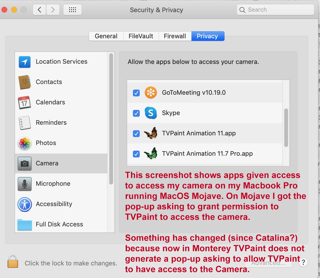

I think you are on to something that may prove to be the solution to the problem.
Because I know that Video-In was still working when I was running MacOS Mojave, I wonder if the problem is that on MacOS Monterey (and Big Sur and Catalina) with the stricter security settings, TVPaint does not present a pop-up to the user requesting permission to use the camera , so in Privacy & Security system preferences TVPaint does not have permission to access the camera ? In my Privacy & Security system preferences I can see a number of different applications that have been granted permission to access my camera, but TVPaint is not one of them and there is no way to manually add it to the list of programs with permission to access the camera.
Access Camera in Mac System Prefs.png (75.5 KiB) Viewed 15779 times

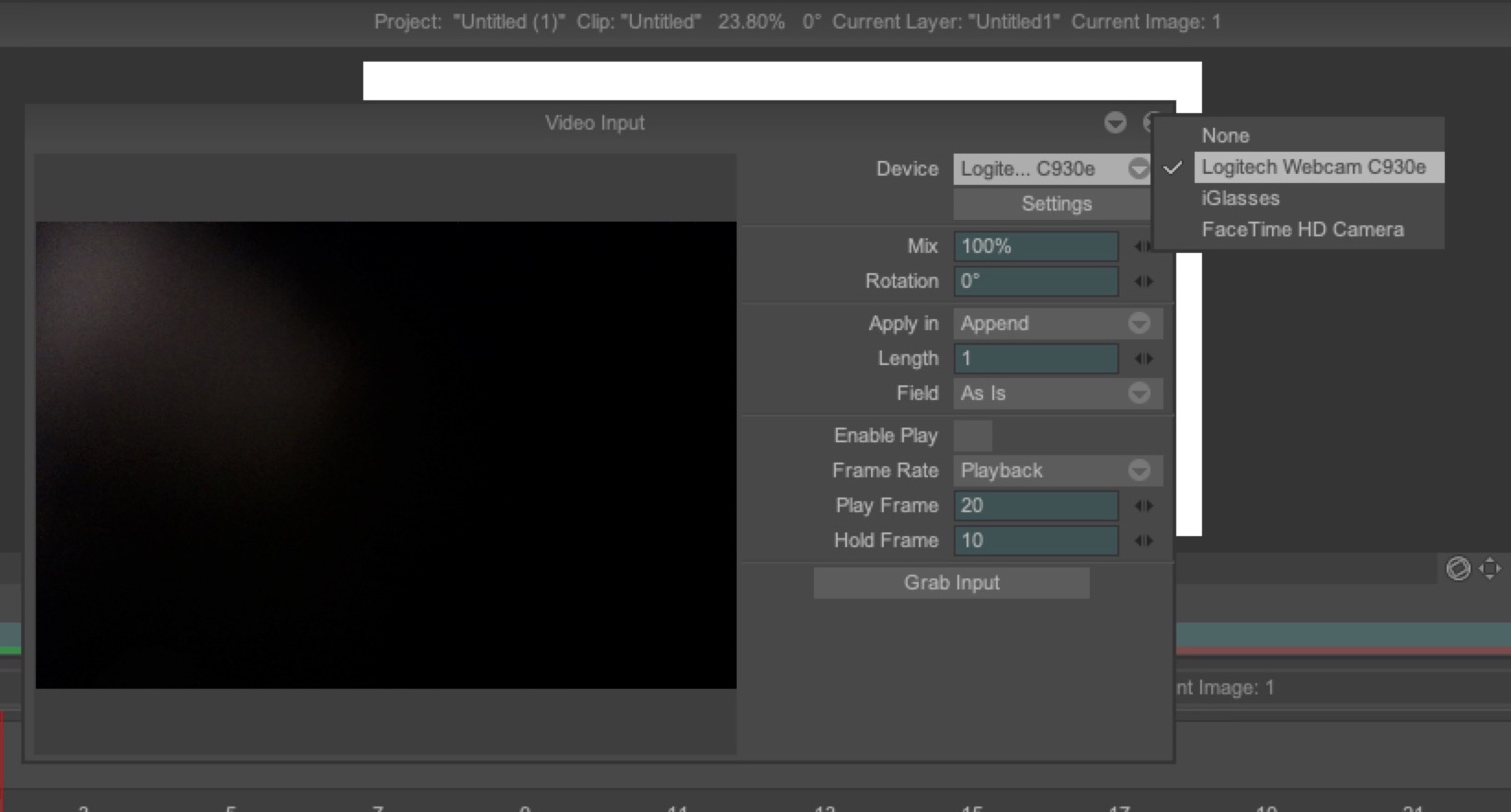

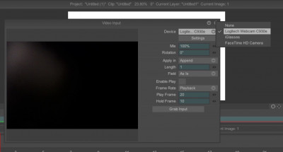

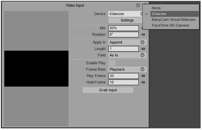

NOTE: on past versions of TVPaint when I was running my webcam through an app such as iGlasses (which allows the user to manually adjust exposure/white balance/focus on the webcam) TVPaint could "see" iGlasses as an available video input device, so I could select iGlasses as the input device. Now Video-In shows "None" as the only choice under device.
Screen Shot 2022-12-06 at 8.46.52 AM.png (27.11 KiB) Viewed 15778 times
This is how it used to appear in the Video-In panel, along with other available capture devices :
Screen Shot 2022-12-06 at 8.56.39 AM.png (53.57 KiB) Viewed 15773 times

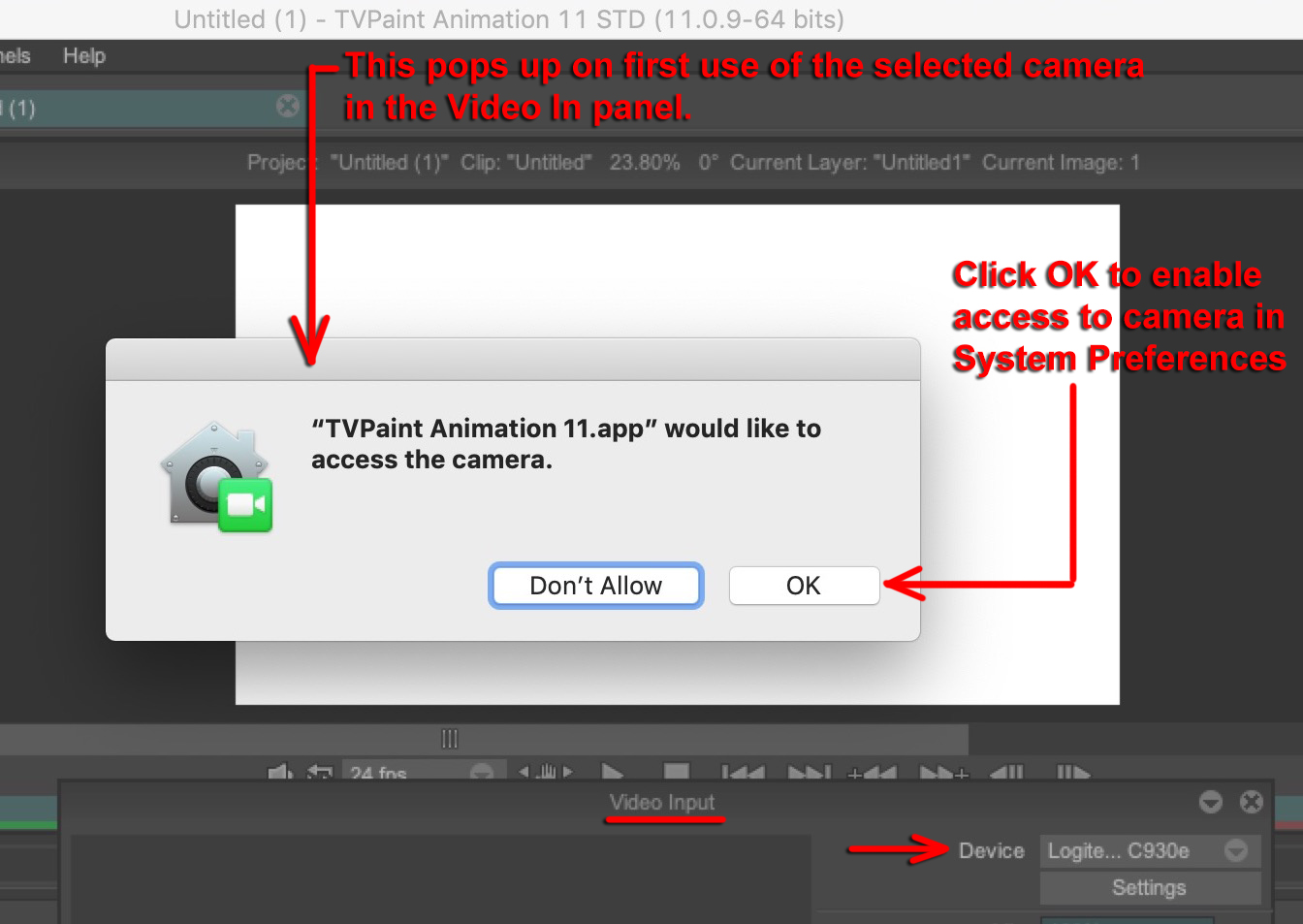

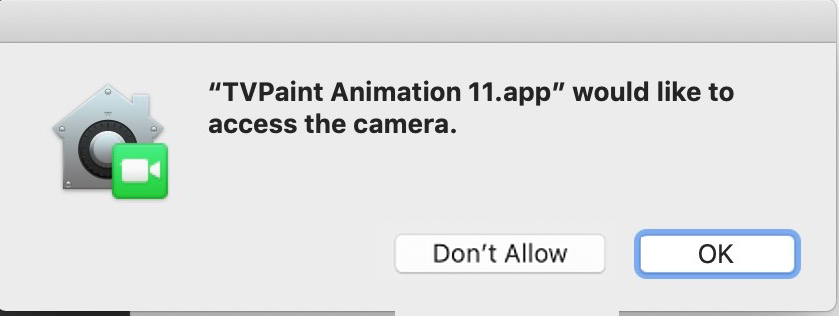

As I understand it, the solution (or, at least, part of the solution) to the problem is to enable TVPaint to request access to the camera through a pop-up notice to the user, so the user can give it permission to access the camera in the System Preferences:
"The app's Info.plist must contain an NSCameraUsageDescription
key with a string value explaining to the user how the app uses this data."
See:
https://developer.apple.com/documentati ... escription
https://developer.apple.com/documentati ... e_on_macos
When the user can add TVPaint to the list of applications that are allowed to access the camera then the issue should be resolved. But if the user never gets this pop-up to click OK to grant TVPaint access to the camera then the camera can not be used by TVPaint.
NOTE: I went back to check on my old Macbook (running MacOS Mojave) to confirm that TVPaint had this pop-up asking to give TVPaint permission to access the camera. It does have the pop-up:
Screen Shot 2022-12-26 at 5.41.51 PM 2.jpeg (58.26 KiB) Viewed 15414 times
This problem seems to be the result of the stricter security system in Catalina/Big Sur/Monterey because TVPaint 11.7.1 has no problem finding and using my webcam on my old Macbook running MacOS Mojave . (and running on MacOS Mojave TVPaint 11.7.1 can also access webcam controller software such as iGlasses , Elgato Camera Hub ,or CamTwist that are set up to use the webcam as a source. On Monterey these webcam controller softwares do not show up under 'Device' in the Video-Input panel like they do in Mojave.) I believe the answer is in the Apple AVFoundation guidelines for configuring the info.plist for the application. https://developer.apple.com/documentati ... ture_setup .
Here are the System Preferences > Security & Privacy > Camera on my old Macbook running Mojave:
Here is what it looks like in the System Preferences > Security & Privacy > Camera on my computer running MacOS Monterey. TVPaint is absent from the list because I never get the pop-up asking me to grant TVPaint access to the camera. All the other apps shown in this list have the pop-up which allowed me to grant the apps access to use the camera.

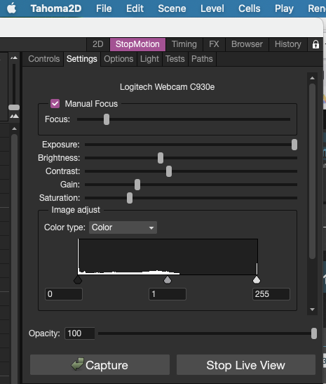

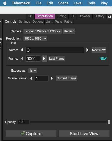

I noticed that the recent build of the open source sofware Tahoma 2D (an offshoot of OpenToonz) now has support for camera capture. Because the source code is open it may be worth having a look at the code to see how they added this function to Tahoma. It might provide a clue to fixing Video Input for TVPaint (?) .
https://github.com/tahoma2d/tahoma2d/tr ... libgphoto2
Screen Shot 2023-01-21 at 10.11.48 AM.png (55.59 KiB) Viewed 15073 times
Screen Shot 2023-01-21 at 10.12.01 AM.png (70.21 KiB) Viewed 15073 times
Screen Shot 2023-01-21 at 10.13.10 AM.png (62.05 KiB) Viewed 15073 times
