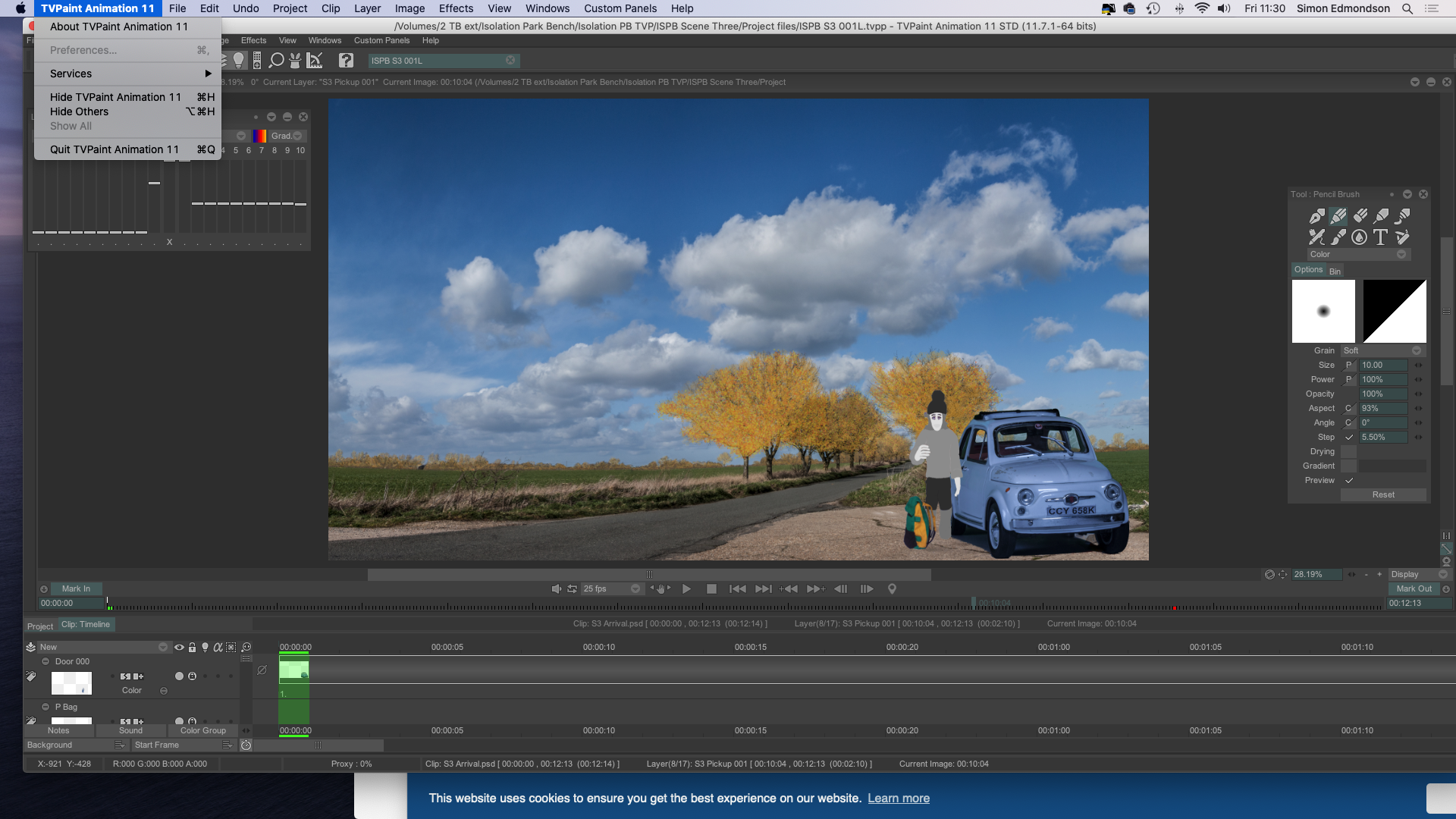

Its not just options within the preferences tab that are greyed out, but the whole preferences option under the menu.
regards

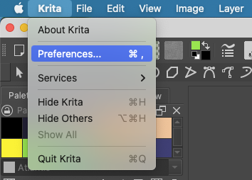

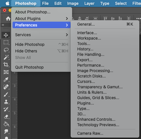

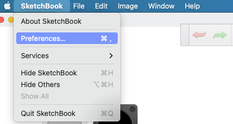

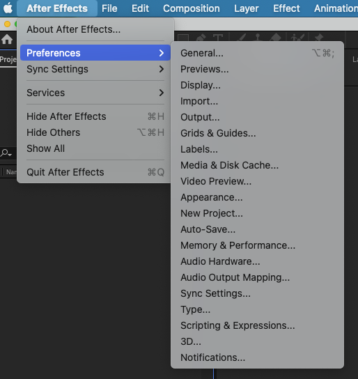

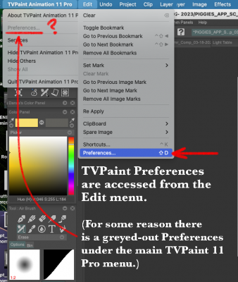

It is strange and confusing that there is a greyed-out 'Preferences' under the main TVPaint Animation menu , but the actual Preferences are accessed from the Edit menu.
So why are TVPaint Preferences confusingly located under the Edit menu instead of in the usual place to access Preferences as in all other drawing and animation programs ? This has always been a mystery to me.

I agree that its behavior should be made redundant with the Edit menu's Preferences item, I just added it to the to-do list.
