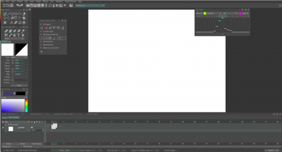

I've attached a screenshot of my current workspace.
How do I get back the control bar/ that bar that has the rotate icon, and mark in/mark out buttons?

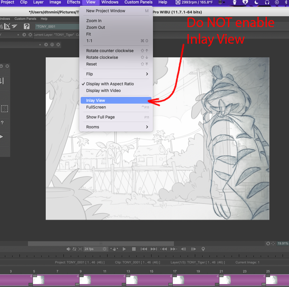

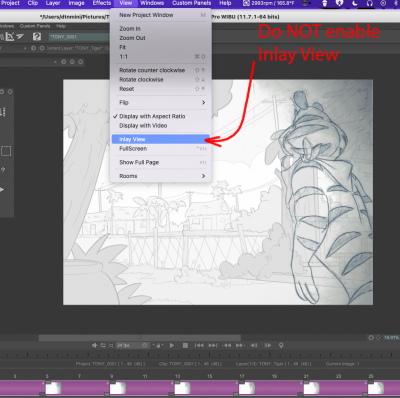

You have fallen victim to the dread Inlay View . Under the View menu , make sure that Inlay View is NOT checked.
See attached screencapture movie showing how Inlay View can happen. (also how the Preview/Play bar will disappear at times if you press certain buttons).

Oh, yes, I should have mentioned that if one intends to use the Inlay View it is useful. The problem is that many people unintentionally activate Inlay View and can not discover how to deactivate Inlay View. (that is why I called it "The Dread Inlay View" , which was meant to be humorous , but probably overstating it !)Peter Wassink wrote: ↑08 Nov 2023, 11:01 Inlay view is actually a nice way to create a bit more screen space for your work area.

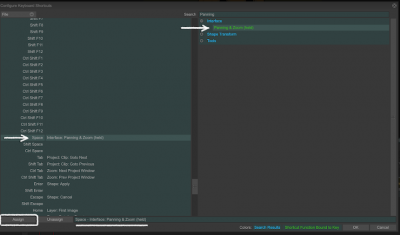

And since 11.7.1 Panning/Zooming can also be controlled by assigning a shortcut to the SPACEBAR, so that Pan/Move is similar to how it works in Photoshop, Harmony, and other animation apps. Rotation continues to be ALT + CTRL.Peter Wassink wrote: ↑08 Nov 2023, 21:39 you can rotate canvas using the CTRL key together with Alt
