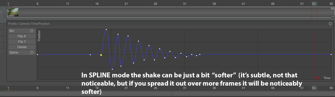

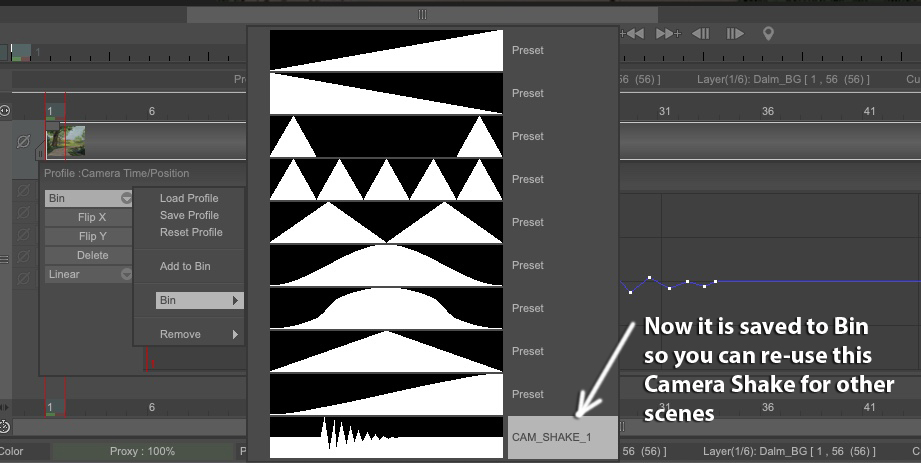

You can set the Camera Time Profile for a "shaking" effect. I will usually set three camera positions: CENTER and Extreme UP and Extreme DOWN. Play around with the number of points and the spacing on the curves on the Camera Time Profile to get the camera shake effect you want. Linear mode tends to give a harder/sharper shake while Spline mode will give a softer shake (especially if you spread out the points over more frames). Adjust the spacing on the points until it looks right to you. The camera tool is getting a major revamp for v.12 and this sort of thing should be even easier to do when v.12 comes out.
[click images to view larger]
The resulting camera shake using the Camera Tool:

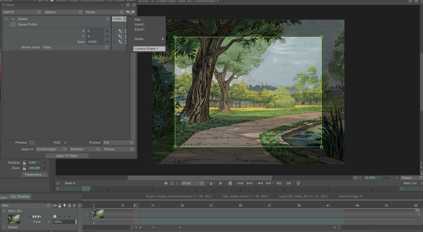

Here is a camera shake keyframed with the Shaker FX -
[click image to view larger]
The resulting camera shake using the Shaker FX:

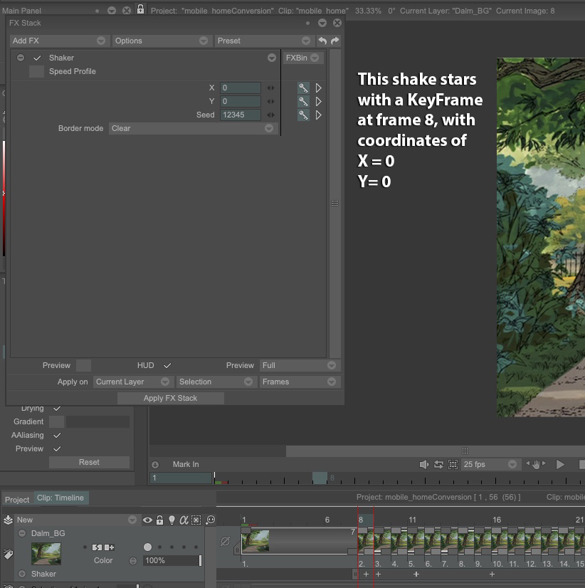

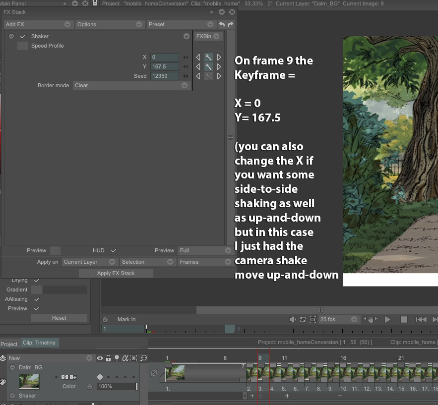

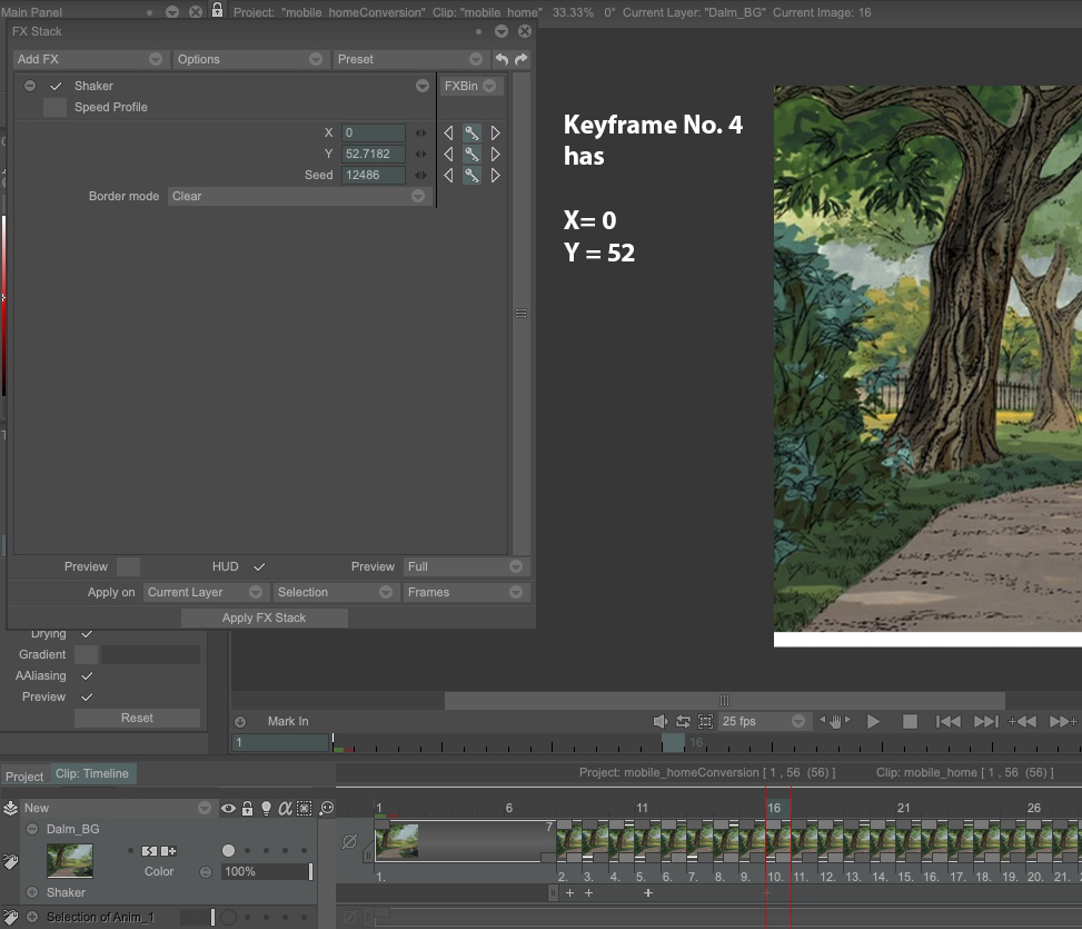

For the Shaker, here are the coordinates I used. I only changed the Y (North-South/Up-Down) coordinate, but if you want some East-West/side-to-side action you can change the X coordinate, too. Again, by playing around with the amount of "shake" on the X and Y (plus you can adjust the "Seed", although I don't really understand what that does!)
and sliding the keyframes up or down the Timeline , you can adjust the shake so you get it just right. I didn't spend much time on this one , so it's just a basic shake. Refining the position of the keyframes a bit can make the shaking taper off more or less gradually as needed.
X and Y start at 0 .
The most violent shaking is at the start on the first frame after the hold , with other keyframes clustered closer to the start , then the amount of shaking tapers off to the end.
X = 0 and Y = 0 at the end.
Screen Shot 2023-12-31 at 12.56.51 PM.jpg (64.47 KiB) Viewed 7038 times
[click on any of the images to see them larger]
Shaker_Keyframe_No_5_returns to 0.jpg (87.1 KiB) Viewed 7038 times
