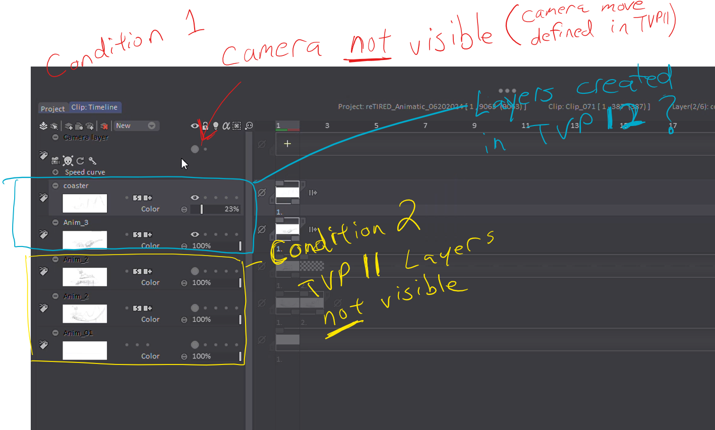

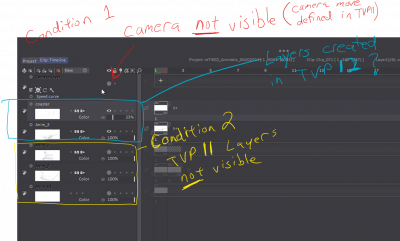

I have been able to consistently reproduce the TVP12 crash with the following conditions:
1) Open a TVP11 project that had a camera move created in TVP11.
2) Play WITHOUT camera View is enabled (camera layer Visibility is turned OFF)
3) Turn Visibility OFF for all layers that were initially created in TVP11.
Below is a screenshot of the video marijaye attached and all the above conditions are met (I'm assuming layers "coaster" and "Anim_3" were new layers created in TVP12).
I tested multiple projects that I started in TVP11 and they all crashed with those conditions.

You're welcome. The video and details you shared provided the hints needed to reproduce the crash, so thank you.
Also discovered another condition that will reproduce the crash. First two points are the same (1)imported project with camera move created in earlier version and 2) camera visibility set to OFF) but the 3rd condition can be if ALL VISIBLE layers are set to exactly one frame, as shown in the video....
