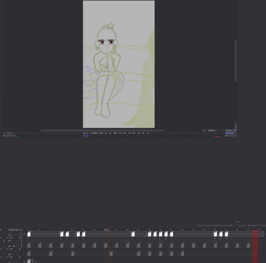

This is what the file looks like when i was drawing it originally in July. When I playback in July it did not zoom in. It looked exactly as i drew it

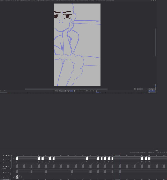

When I play back now this. I do not know why it is zooming in like this when i play it back. There is no camera i think.
I attached my og file for reference in the OG post.

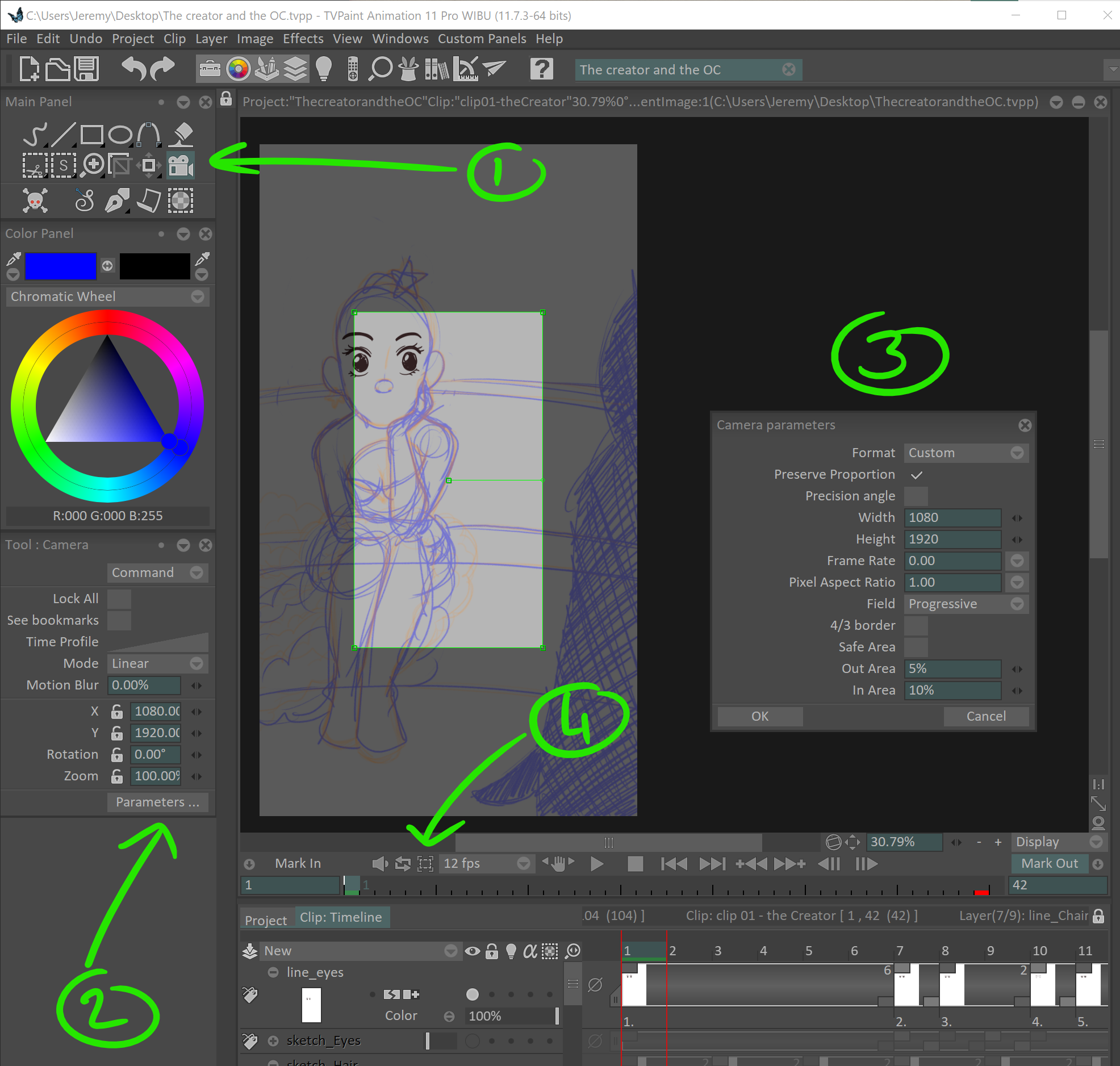

there seems to be a camera in the file you shared, at least when I try with my copy of TVPaint, which is 11.7.3.
I can't see it in the screenshots, but maybe you have the 'Play with the Camera View' button on (located above the timeline). When off it plays with the project's dimensions.

I don't remember putting a camera! At least not for this piece! I did use it in a previous video I made!
So it is possible that the settings did not revert back to the default.
The "Show Camera" was on. And I turned it on when I made a video that required the camera. I didn't think i'd have to turn it off again.
THANK YOU SO MUCH JEREMY!
