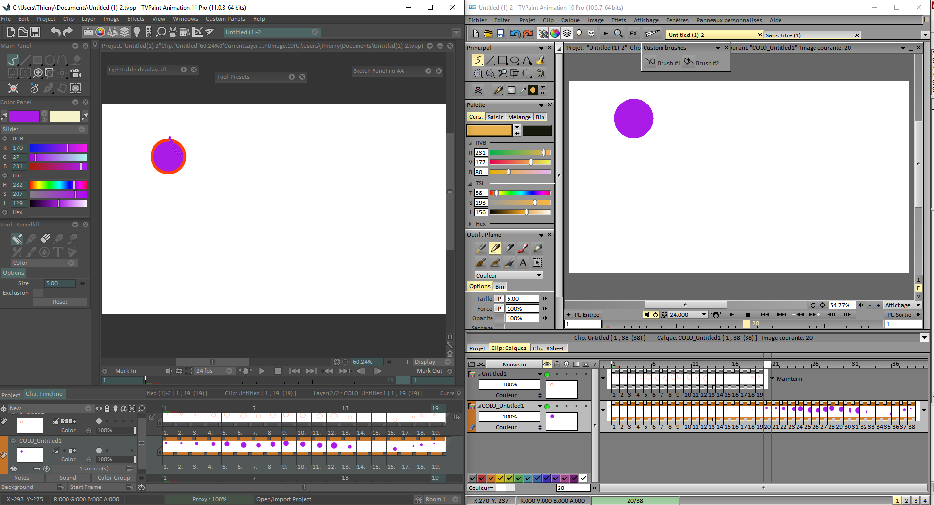

Elodie wrote:• open v11 files with TVPaint 10.5.7 : files are 100% loaded. CTG layers are considered as anim layers, so you will see squiggles first, then the coloured shapes.
Here's an example of what you will see :
On the left, a project in v11.0.3 with a CTG Layer, and on the right, the same project opened with v10.5.7.

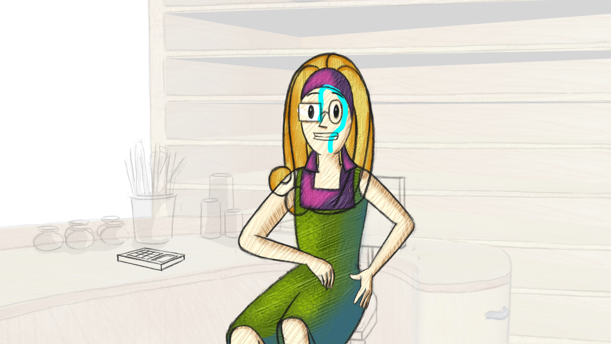

Sorry my previous post was in reference to 11.0 to 10.5.7 compatibilty. My new issue is with 11.0.3 to 10.5.7. See why you thought I hadn't updated but we had done once I read all the posts. We have been having problems going from 11.0.3 to 10.5.7 but I think I solved it. If the CTG layer on the 11.0.3 file is not converted to an anim layer then it comes in wonky on 10.5.7 - or doesn't show up. They (the artists working on 11.0.3) had been forgetting to convert the layer because it looks right on 11.0.3. Does that make sense on your end?

Sure will do - this is what I got in 10.5.7 before she converted it to an animation layer. What should have been a solid paint colour remained a squiggle.

Re: Help! TVPaint 11 files not opening in TVPaint 10?
I think I got it.
In fact, when you open the file in the 10.5.7, the converted CTG layer shows the squiggles at first, then the colored shape (look at the timeline in the exemple that Thierry posted below)

It doesn't in mine - it just showed the squiggle all the way through. My files are huge so I couldn't add it as an attachment - but its all good :) Too crazy busy now finishing this stoopid thing!
