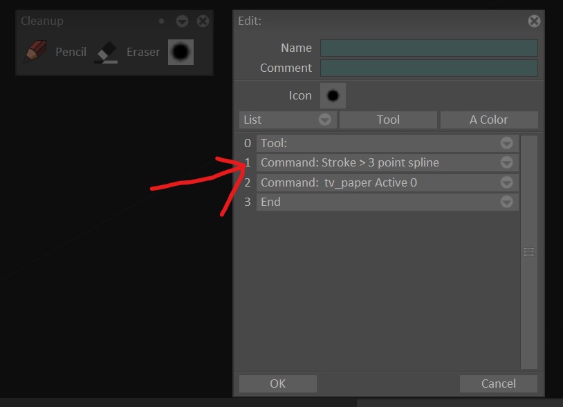

Hi! I'm trying this technique now and can't seem to get it to work. I'm grabbing the current freehand drawing tool and then editing, inserting a command, and typing the custom command as shown above, but still only get the Freehand stroke. I'll try posting a screen grab of what I'm doing. Thank you!

Posts: 1579
Re: how to save custom 3 Pts Spline tool?
You should not insert the line as a "Command". Remove that line.
Instead, insert a "key" by selecting Set KeyStroke, then choose "Shape:Spline 3Pts".
Then save.
This should now use whatever tool is set by line 0 and let you draw that as a 3 point spline line.
Post by kmvassey »
Yes!! That worked great and makes total sense. Thank you so much! :)
