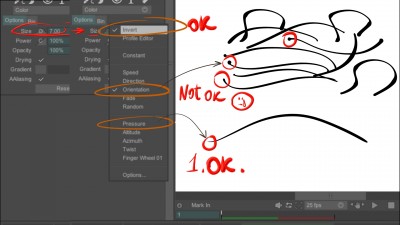

But I can not get rid of the points at the beginning of the line. Can you help me remove them? Here is the brush I am modifying.
- rhuthm brush.tvpx
- (54.5 KiB) Downloaded 1191 times
Re: The Brush for rhythm line.
For starters, turn off invert for size, (the minus sign... it's telling the drawn line to start maximum size... causing the blob at the beginning of each line).
Next, change size so it depends on pressure, not orientation.
Then right-click on size and adjust the profile window so that the lower right corner/start of the line is 0 (or some low value), then add points to the line to make the curve much more gradual.
You can also adjust the stylus "tip feel" setting towards softer, for better control and feel of the line.

Many thanks. This solved some of the problems.Svengali wrote: ↑27 Jan 2020, 01:00 For starters, turn off invert for size, (the minus sign... it's telling the drawn line to start maximum size... causing the blob at the beginning of each line).
sven
BIG THANKS!!!
