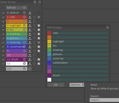

Posts: 4518
Re: extra color groups
Wow! yes very nice! :D
Could you make it that the color settings can be set globally?
Perhaps as a setting in the preferences?
because now every project has its own colorgroups presets.
So if you create a colorgroup[setting for a certain project you would have to load it in for every shot or else it resets to the default.
i can export a color group setting... with names and colors. (see image)
but even if i save as defaultgroups...
when loading a project with another group, i still have to manually load in the customgroup.
and with a series production this is not viable.

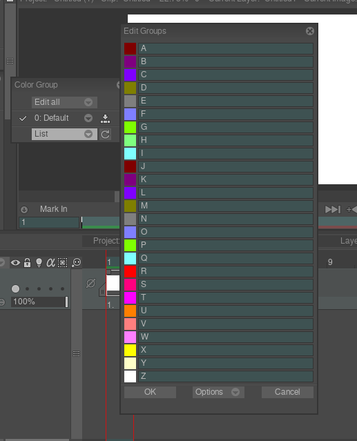

Xavier
Posts: 1855
Joined: 01 Oct 2019, 11:08
Post by Xavier »
I'll have a look, but that'd be in the future release not the one to come.
