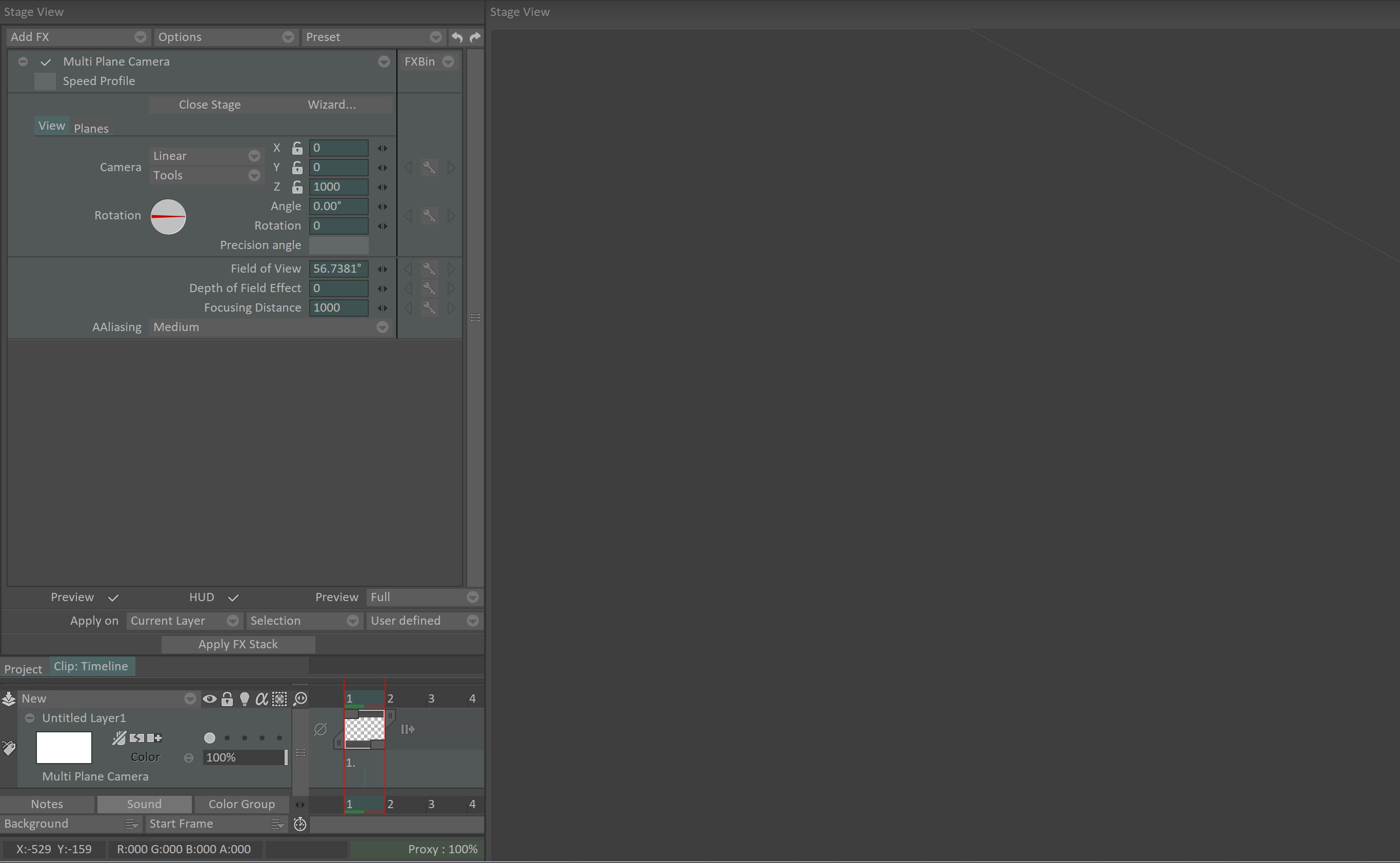

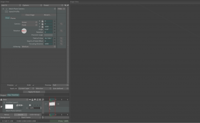

Hello, I have another problem with multiple stages. It somehow zoomed in and I do not know how to zoom out again. As you mentioned, it is each time the way it was set up, so it does not solve by closing the program. what should I do?

esifosil wrote: 09 Feb 2023, 08:01 Hello, I have another problem with multiple stages. It somehow zoomed in and I do not know how to zoom out again. As you mentioned, it is each time the way it was set up, so it does not solve by closing the program. what should I do?
The screengrab you posted above shows the default set up of the multiplane camera. It's not zoomed-in.

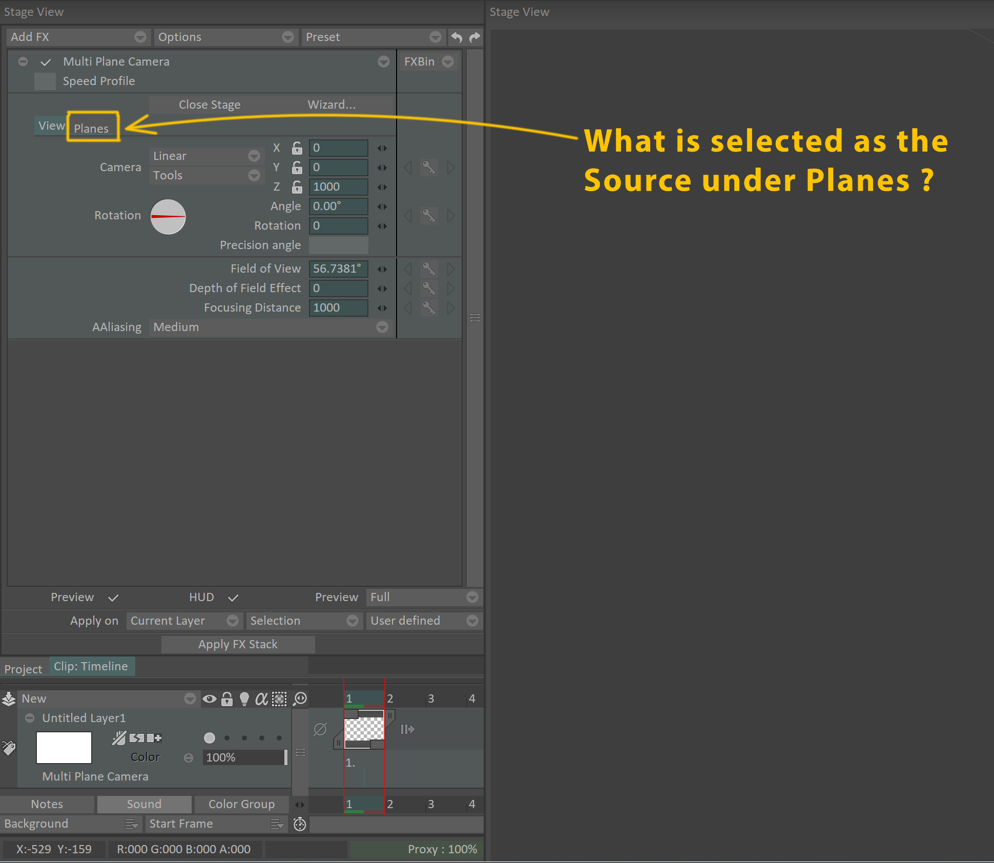

I can see the stage is empty , but I wonder if that is because there is nothing loaded into the Source for the Multiplane ? What is selected in the Source tab under Planes?
But the problem seems to be that on your Multiplane Stage View it is just completely blank, you don't see the Camera interface , is that correct ?
I tried to reproduce the problem by moving the Zoom (Z) button in and out and also grabbing the Camera and moving it in and out , but you can see
in the attached video that even with the zooming-in and out I can still see something on the stage.
I would advise posing a NEW topic under Technical Support so the TVPaint Tech Support are more likely to see it and respond to your issue. (this older topic was about an issue that has been resolved and is less likely to be seen as it has a green checkmark on the topic, which means Resolved. )

On further consideration, I think I can figure out what might have happened in your case. See this second screencapture video attached below.
I hope this helps . Let me know if this resolves your problem.
