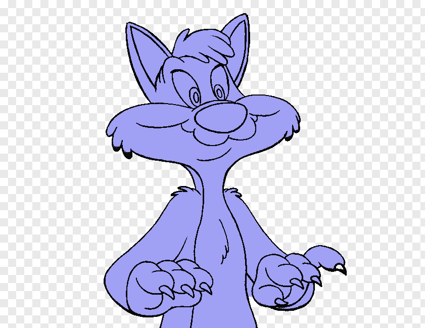

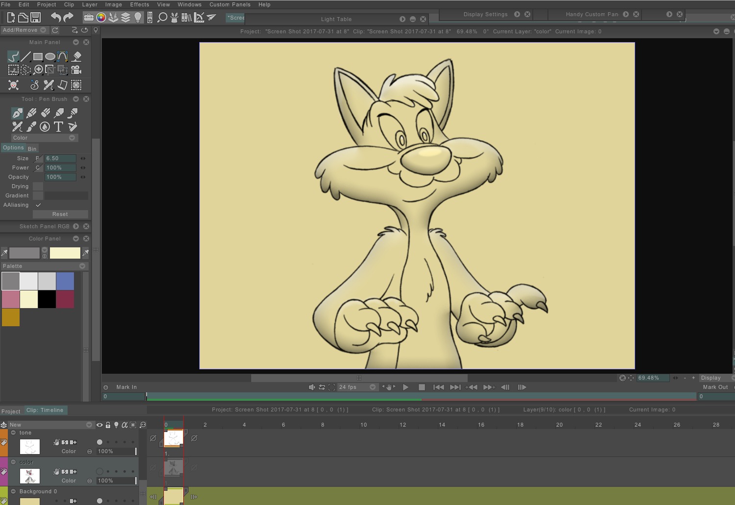

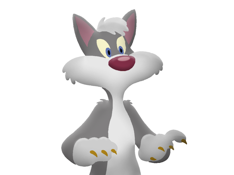

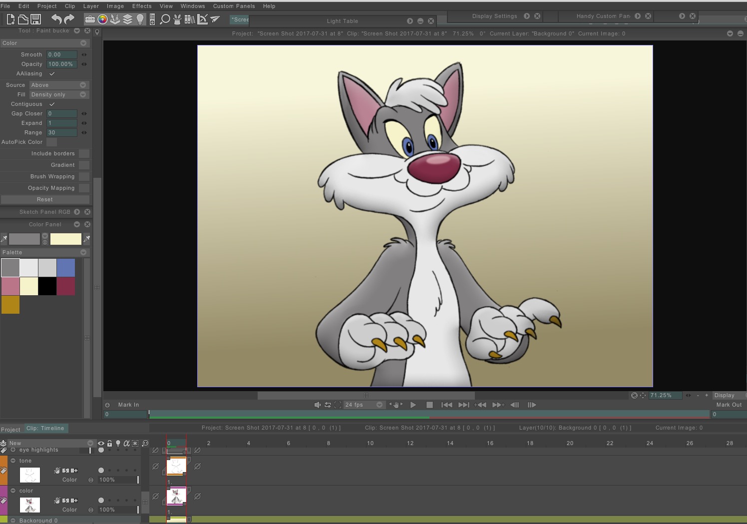

Yes. Here's a quicky . I still think drawn tones and highlights look better for the most part. You can control them better. But the computer "toon shading" works for some situations.
Sometimes it works best to do the flat colors with CTG , then extract each color area to it's own layer , so you can adjust the toonshading direction and intensity for different parts of the character , instead of just one overall application of the effect to the whole character. The eye highlights and nose highlight are drawn on their own layer, not toon shaded, but some gaussian blur applied .

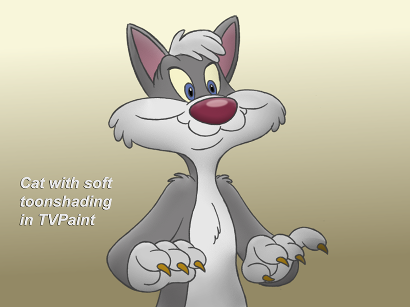

This is very soft , no definite shadows, just an overall soft "airbrushy" tone. Additional tones and highlights layers over this soft tone could make this look better.
(The line drawing of the cat character is not drawn by me. It's from the paper about Lumo by Scott Johnston.
*EDIT: And in fact, as Scott mentions in his post later on in this thread, the drawing is actually by Eric Goldberg. )

Step 1 : get lines good lines quality, if possible, without too much aaliasing. If necessary, you can use the FX Color > Hsitogram > alpha tab.
Step 2 : use CTG layer to quickly fill the whole character
Step 3 : change layer blending mode for line and use "erase" mode

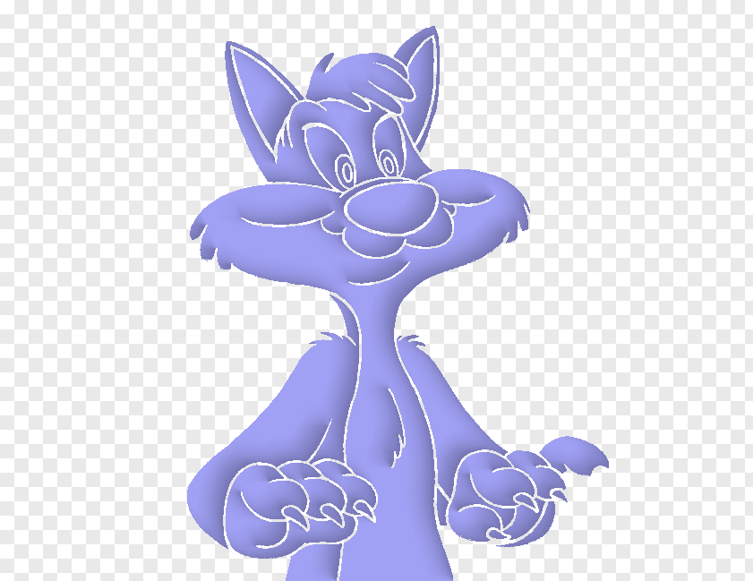

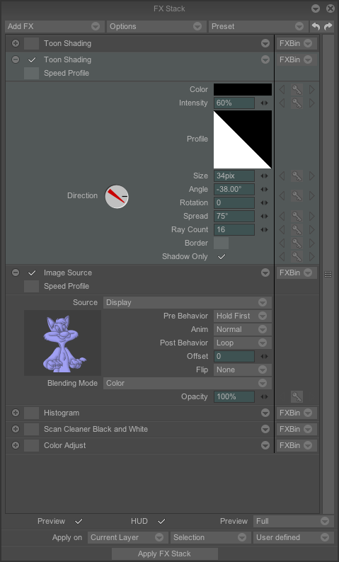

Step 4 : create new layer. Use FX Color > Image source (Display mode) + FX > Stylize > Toon Shading (check shadow only)
04_toon shading-shadow-FXStack.png (64.84 KiB) Viewed 42461 times

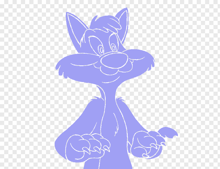

Step 5 : create new layer. Use FX Color > Image source (Display mode) + FX > Stylize > Toon Shading (check shadow only and change color for white)
05_toon shading-light-FXStack.png (63.42 KiB) Viewed 42461 times
Step 6 : change again Layer blending mode for line layer and use "color" mode. Then, use CTG layer to paint your character.
I also attached a video where I play with lights and shadows simultaneously.

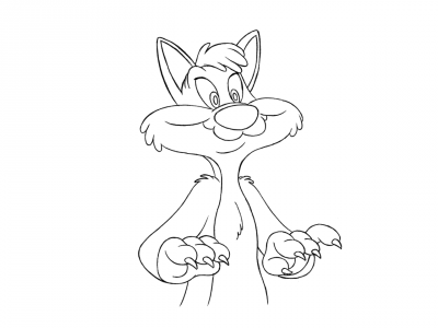

Here's the clean one I used (copied from Scott Johnston's paper on his Lumo system) , in case UsaMiKo or anyone else wants
to play around with it following your tutorial .
(drawing will need Scan Cleaner B & W FX applied after importing it to TVPaint,
before starting the procedure shown above by Elodie.)

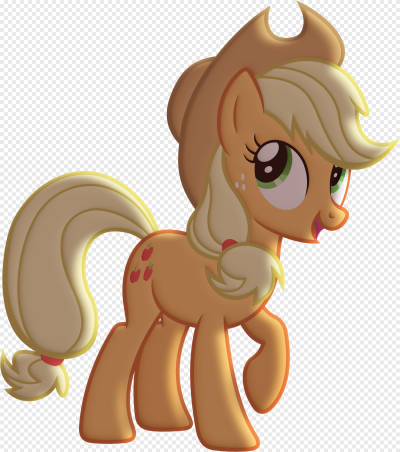

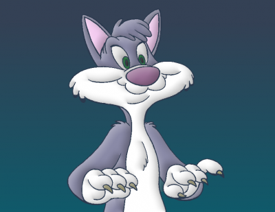

I pushed tests further and used some new FX that will be available in next update and tried to imitate this result :
colours
colours
drop shadow FX with colour layer as a mask
new FX to be released in version 11.0.7
Toon shading FX with white colour

Elodie wrote: 01 Aug 2017, 07:27 I pushed tests further and used some new FX that will be available in next update and tried to imitate this result :
Very interesting . Thanks for the ideas.
The last image is titled:
I had never thought of using the Drop Shadow from the Stylize FX with the colour layer used as a mask. Although, from the results I'm not entirely sure how you did it . Is the colour layer acting as a mask by selecting that layer as Image Source in the FX Stack ? If you get time to show a more detailed tutorial (like the earlier one with the screen captures of the FX stack settings) I hope you will post more .
To me the main test for any of these methods of making shadows/tones is to successfully apply it to a character animating , when the character moves and changes direction during the scene . (not always positioned on the same angle). What works on a still image is one thing , but it gets much more complicated when trying to make it work for animation.
But even for still images , these are useful techniques.
Me neither until yesterday ! I had this idea after watching "Roger System" process : when I looked at the second picture, I realize it looked like a drop shadow, applied within the character's shape.
I will record a short video as soon as I arrive in the office.
Re: Have any of you ever heard of/worked with LUMO?
So, this is the video how to inlay "drop shadow" FX :
Inlay drop shadow FX.mp4
(8.18 MiB) Downloaded 1497 times
