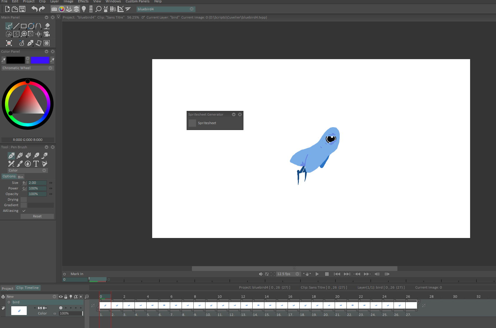

Here is a script that I created that can generate a spritesheet of your animations.
spritesheet-generator.tvpx
(11 KiB) Downloaded 494 times
Here's a short example:
Click on the button in the panel:

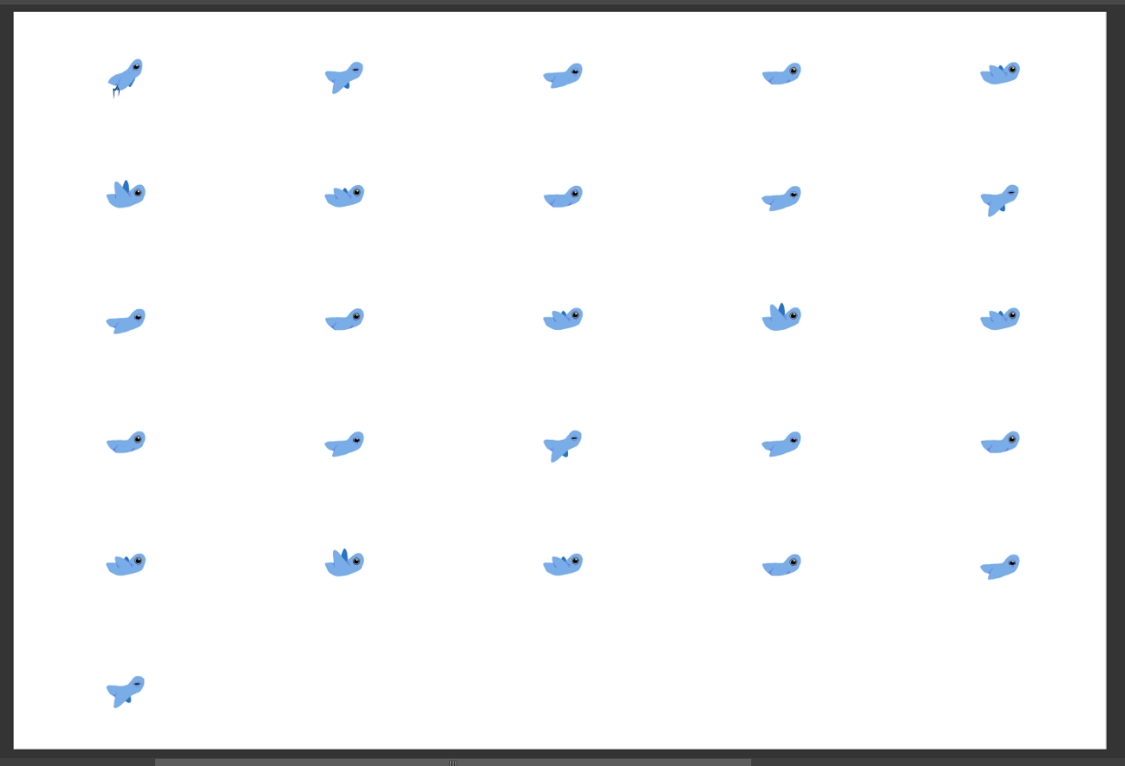

The script will run and generate this spritesheet:
A png file containing the spritesheet will be saved in the folder in which your project is stored: my project is named "bluebird4", so the png file will be named "bluebird4_spritesheet"
Aaaand... that's it :)
As you've noticed, there are 5 images per line. If you have less than 20 frames in your animation, there will be 4 images per line.

Nothing relevant, but after running the script, I got a new and perfect (generated) project featuring the spritesheet, while the automatic saved picture is empty but at the right size.
