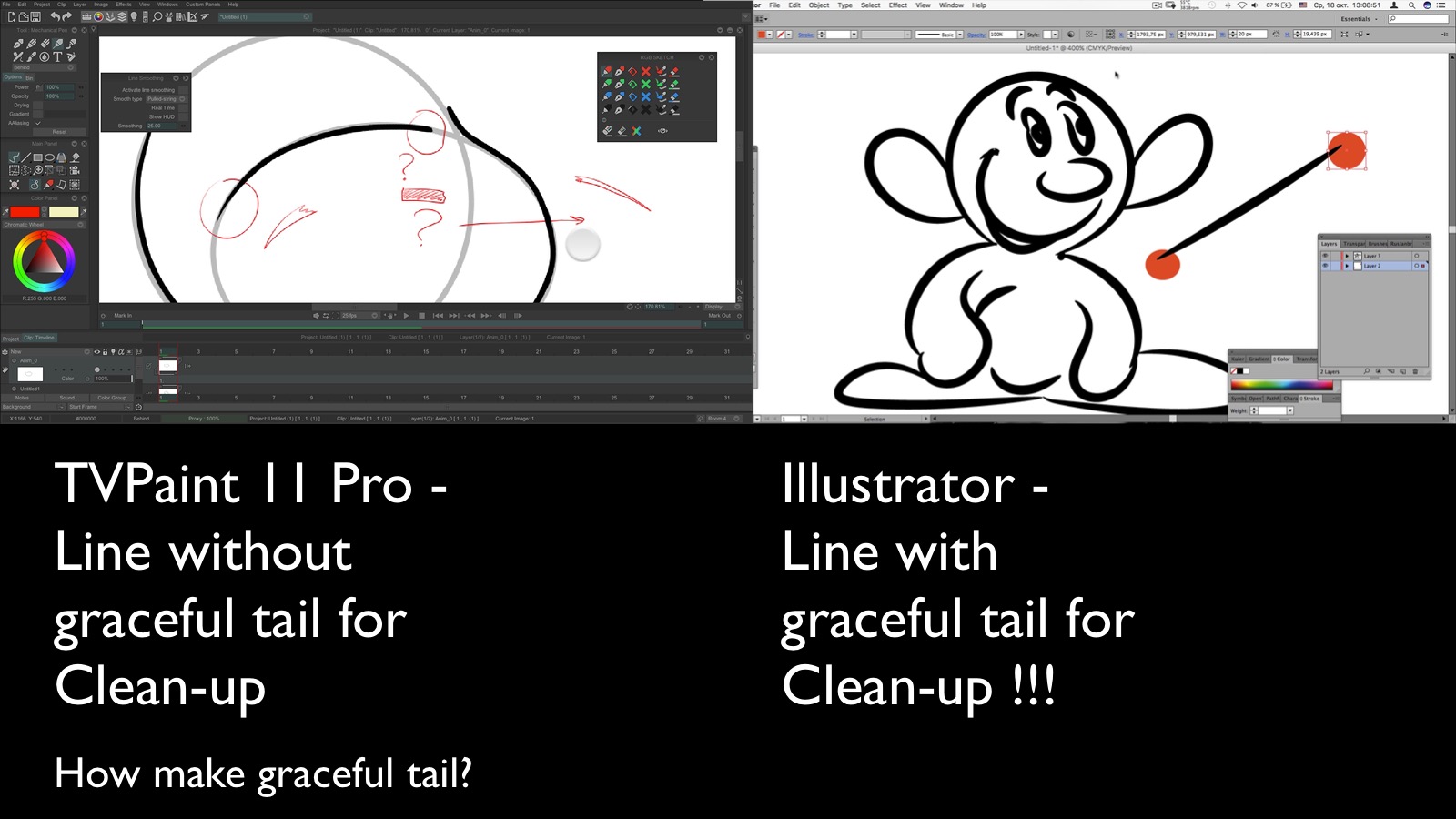

How to make a perfect stroke line for clean-up? :)
(CONVENIENT for the work... like in Illustratore)
Look video please. :)

I understand you Slowtiger. I drew a clean line in TVPaint for the scenes. I fully know the work of the instrument. But believe me, drawing an equal line in the illustrator is very convenient. And I have to leave tvpaint for CLEAN-UP, and then come back. Only for the task of CLEAN-UP-tvpaint today - weak .. I'm interested: Developers stopped? The tool is complete or it is worth hoping for development to the level of convenience as in Illustrator ???

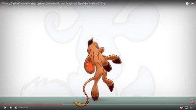

TVPAINT CLEAN-UP
[youtube]https://youtu.be/sV1imtczc0w[/youtube]

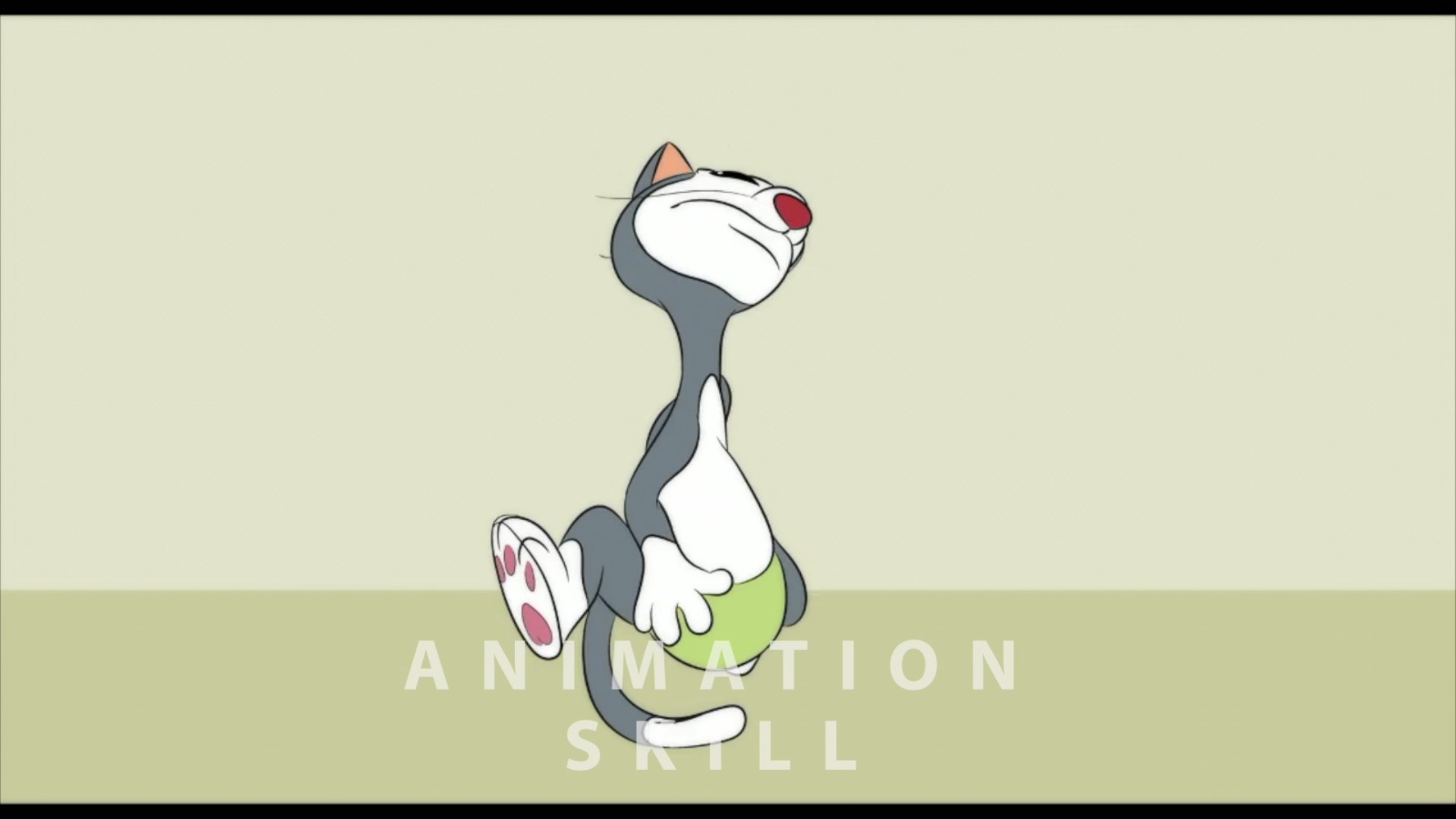

Illustrator CLEAN-UP
[youtube]https://youtu.be/JY9S-Rf2Fpg[/youtube]

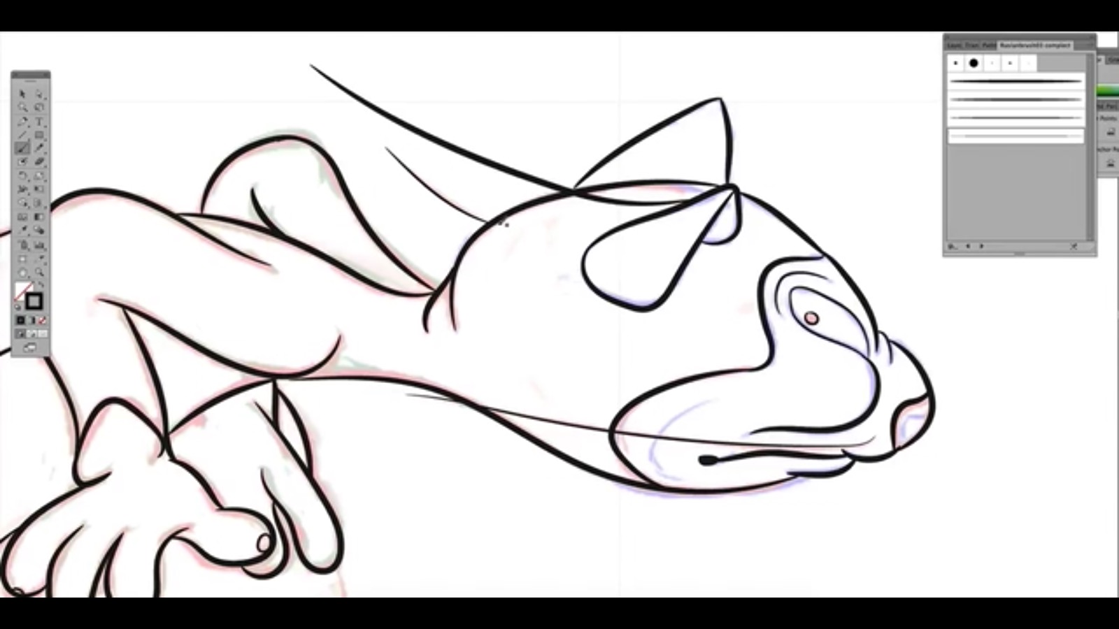

illustratore clean-up.mp4
(29.31 MiB) Downloaded 1306 times

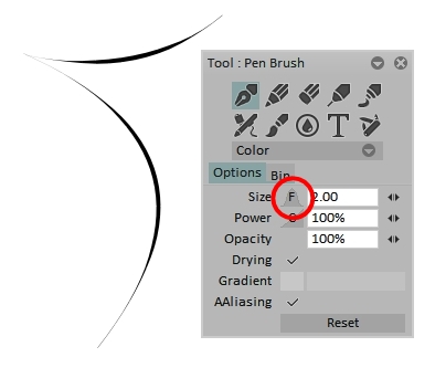

you can get this, using the spline tool in tvpaint
set the drawing mode of your pentool to "fade"
this is in the connectionsettings (red circle) and here you also choose the profile for the line , in this example a sinus shaped curve
so all this in the red circle...
the drawback is that you have to make a seperate spline for each line/curve
Animationriver

But the lines using these settings come out very short.
The line does not hold density all the way, it becomes transparent, it does not meet the requirements. :roll:

no, you can also make very longe lines using this method
but the tapering will athen also be longer. according to the profile
so you could consider setting up a couple of different taper-preset buttons in a custompanel for short/medium and long lines.
the transparency can be switched off if you set the power connection to constant
