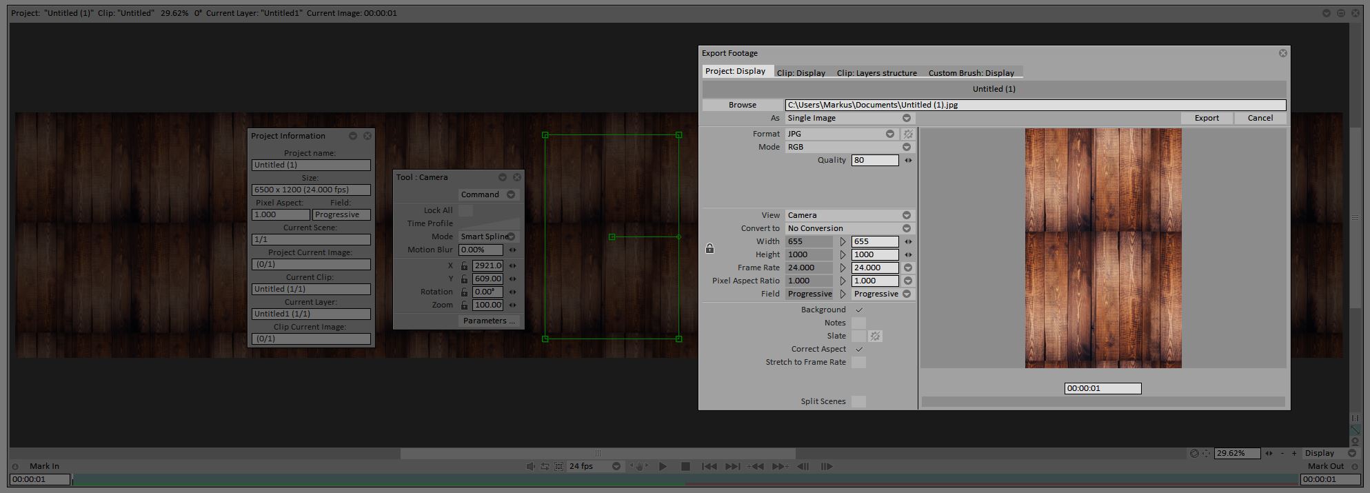

Hey David, for your second question please try to understand my last answer. If you do so you will get exactly that part of your project which is framed by the cam. And its in the projects native resolution. I know, it's a bit difficult and I also needed some time in the past to understand.
Animark wrote: 10 Jan 2018, 09:07 1. take the value of the zoom (let's say 120%) and set the zoom to 100%
2. recalculate a new cam resolution: 1920 x 1.2 = 2304 px
3. set the cam resolution to 2304 px
4. render this frame and it should be in the native resolution of the project
When the camera zoom is exactly 100%, then it has your native resolution.
Good Luck!

No, the cam is not exact the size of your project. It has the size you gave her by your own hand. In my opinion this is the only way to get what you want. But I would do it with the cam and it's 100% possibility rather than doing the math in the output - cause of possible decimals and rounded conversation. As said before, as long the cam has 100% and as long you don't do a conversion, you will get a native resolution when exporting. You are free to give the cam every size you like. With my little math you're able to keep your cameras scene design. It doesn't matter which size your project is. It's so easy to try it out and to see what is happen.
Here is an example that shows how to get native resolution. Cam and project size can be total different.

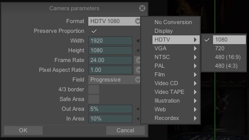

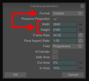

David_Fine wrote: 12 Jan 2018, 22:36 Thanks for the thorough info. I do understand the principal of resolution, but what I am not understanding is what the camera parameter settings have to do with the output because I set the output when I use the export feature. If the Camera is set at 1920 on a scene which is actually 3840 wide and the output setting on export is set to 3840, then I will get a file which is 3840 wide, so what is achieved by changing the camera parameter settings? Currently, they seem to default to 1080. Do I need to change that? Will changing that have any impact on the output quality or is it entirely determined by the chosen resolution setting in the export dialogue? I hope my dilemma is clear. What is the Camera Parameter setting used for if I choose the output resolution in the export window?
It doesn't have to default to 1920 x 1080. There are a number of presets for the camera parameters , including HDTV 1920 x 1080 , but you may set the camera parameters to a custom size. So instead of setting it to the preset 1920 x 1080 set the camera to 3840 x 2160. This will now be the size the project is output to with the Camera View enabled.
As long as the project dimensions are equal to or smaller than the Camera dimensions the quality of the image is not impacted . So if your Camera dimensions are 3840 x 2160 and your project dimensions are 3840 x 2160 (or larger) then you're good. If your project dimensions were 1920 x 1080 and your Camera is set to 3840 x 2160 then you will be enlarging the image when you export with Camera view set to 3840 x 2160 , so that would impact the image quality.

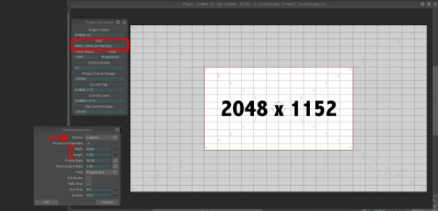

David_Fine wrote: 12 Jan 2018, 23:38 Given that I have scenes of varying resolution depending on the character detail and how tight I want the field, how can I accurately output 1:1 resolution when the camera is not full frame, but say, cropped in a little? That is, a project which is 3000 pixels wide but composed a little tighter. It might be about 2800 pixels wide, but I can't see anyway of confirming the exact pixel dimensions of the frame I choose so that I can output without recalculating the size, but simply at the maximum 1:1 resolution. (Don't ask me why I want to do that, but I do. :) )
Ok, but even if you have TVPaint project files composed at sizes of varying dimensions depending on how tight you want to field in , the OUTPUT dimensions must be exactly the same for each scene or it will be impossible to edit the scenes together consistently . So upfront you decide on the aspect ratio and dimensions you will use for the final output , let's say 16:9 aspect ratio
at 2K = 2048 x 1152 . This means no scene will be composed smaller than 2048 x 1152 (for scenes with locked-off camera) but some may be composed larger , in the cases where you will field-in tighter , so in some cases if you were going to zoom-in as much as 200% (equivalent of a move from "12 Field" to "6 Field" with reference to ye olde "12 Field graticule/field guide" ) your scene would be composed at 4096 x 2304 to maintain maximum image sharpness over the entire range of the zoom-in ... if it was a more extreme zoom-in of 400% (equivalent of "12F" to "3F") then the scene would be composed at 8192 x 4608 ... however in each case the Camera size would be set to the final output resolution of 2048 x 1152. So then every .mov file delivered to the editor will be 2048 x 1152 and all will cut together consistently.
In this example , the project size has been scaled up 200% to 4096 x 2304 , but the Camera parameters are 2048 x 1152 (the intended output size) . Any camera fielding from "12F" to "6F" will maintain sharp image quality in this set up. When it's exported it will be exported with the Camera View of 2048 x 1152 :
