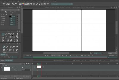

Hi there,
i am using TVP 11.0.8 and i am looking for a possibility to save my grid settings.
I ad in the guideline panel a grid and do some adjustments. Everthing is fine.
But if I open a new dokument, i have to do it again. The same adjustments for each new dokument.
Does somebody know how can i save this grid adjustments to ad my own grid in a new dokument?
Thank you.
Jens.

One way is to make a button with the following embedded script. Note that you will have to enter your own Xcell and Ycell dimensions.
sven
Code: Select all
Xcell = 8
Ycell = 6
msg = Xcell " by " YCell " grid|display|erase"
tv_Request msg
IF result = = 1
tv_GetWidth
Width = result
tv_GetHeight
Height = result
GW = Width / Xcell
GH = Height / Ycell
tv_GuideLineAdd GRID X 0 Y 0 W GW H GH
ELSE
tv_GuideLineRemove ALL GRID
END

Re: Grid & Guideline save
I've modified the script adding the tv_GuideLineSnap command and the tv_GuideLineColor command.
Everyone finds their own way to scripting, usually by reading docs like those found in the Wiki, watching tutorials and looking at scripts written by others to decipher what each command line does. GEORGE scripts are totally accessible, written in plain text form. Start by making simple changes in a script like this one: Try to make a new button that generates a red grid and another button that generates a green grid with different dimensions. You can make another button with a one-line embedded script that will let you Toggle the Snap-to-Grid-state on and off (hint instead of using ON or OFF, use TOGGLE as described in the documentation). Experiment - its hard to break anything with GEORGE scripts and GEORGE will often tell you exactly which line in your script is the problem. You'll quickly understand how it works. Where it takes you is up to you.
With Guidelines, the interface is wonderfully designed for interactive use. But GEORGE provides GuideLine script commands that users can combine in scripts, for example, to store and retrieve user defined-grid dimensions, user-defined grid states like color and snapping, etc.
sven
Code: Select all
Xcell = 8
Ycell = 6
R = 0
G = 0
B = 0
A = 255
tv_Request msg
IF result == 1
tv_GetWidth
Width = result
tv_GetHeight
Height = result
GW = Width / Xcell
GH = Height / Ycell
tv_GuideLineSnap GRID OFF
tv_GuideLinecolor GRID R G B A
ELSE
tv_GuideLineRemove GRID
END
sven
