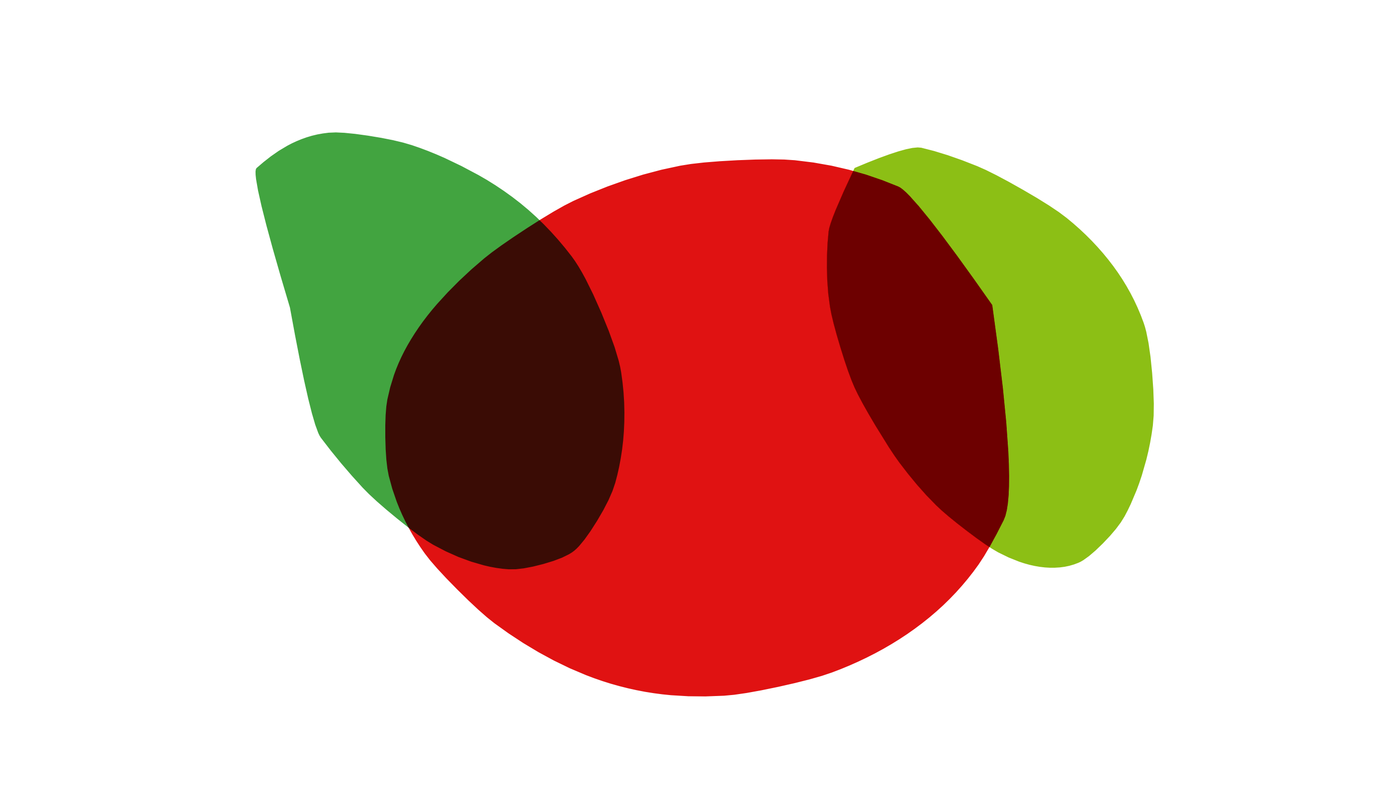

Spoiler : my before/after merging my layers with blending modes, i lose everything outside of the plain circle. Exporting works however when i export with a white layer underneath :

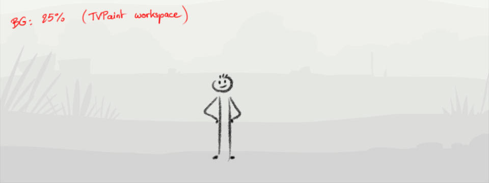

Here is how I work inside TVPaint (anim layer: 100 %; BG layer: 25%) and also how I actually would like my export to look like:
Spoiler : :

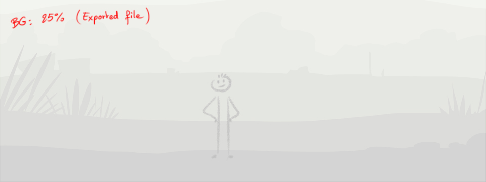

And here is what I get after exporting with tv_SaveDisplay:
Spoiler : :

Thinking about it, seems normal to me that saving a display with transparent pixels on the background doesn't work because there is nothing for the pixels to blend with if you have an unusual blending mode. When exporting with the tvpaint UI you have a "background option" that creates a background to help with blending modes, so you have to do the same with your script.
Just wrote this script for you. It should work for what you want and be lightning fast, indeed it creates a white BG layer and deletes it afterward. I put some hints in it about how it works and ways to tweak it a little, hope it helps.

For your question I guess that multiply mode has some maths going on using also alpha, so if it blends to a 50% opaque pixel you have a 50% opaque layer if in multiply mode. When it uses a 100% opaque background you don't notice anything but when it is transparent, as in our case, and you lower the opacity of your own background layer the layer with a blending mode uses your background layer opacity instead of using 50% your bg and 50% your background color. Does it make sense?
