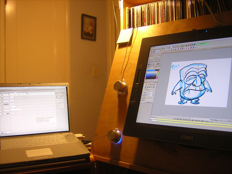

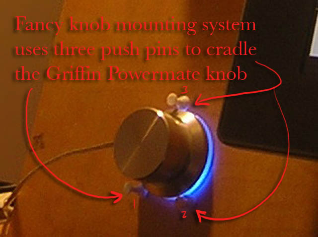

I use two Griffin Powermates . One Powermate is set to Rotate the virtual animation disc and the second Powermate is set to the right and left arrow keys so I can scrub back and forth over the drawings in the timeline to simulate "flipping" between the drawings like in traditional pencil & paper animation.
My Cintiq is retrofitted into my animation desk, so I have the Griffin Powermate knobs mounted to the surface of the desk with "high-tech" method ... push pins :wink:
See photos.
Powermate knob held to surface of desk with push pins
Griffin Powermate knobs . One used for rotation function of virtual animation disc , the other used for "flipping" drawings by scrubbing back-and-forth over drawings in timeline.

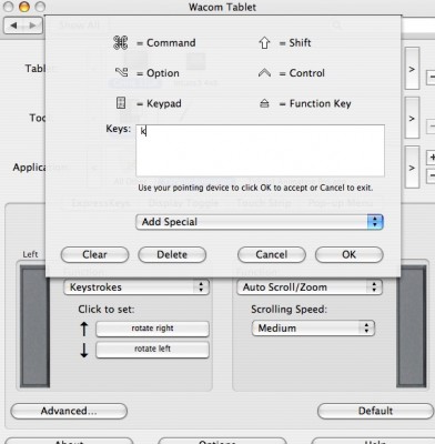

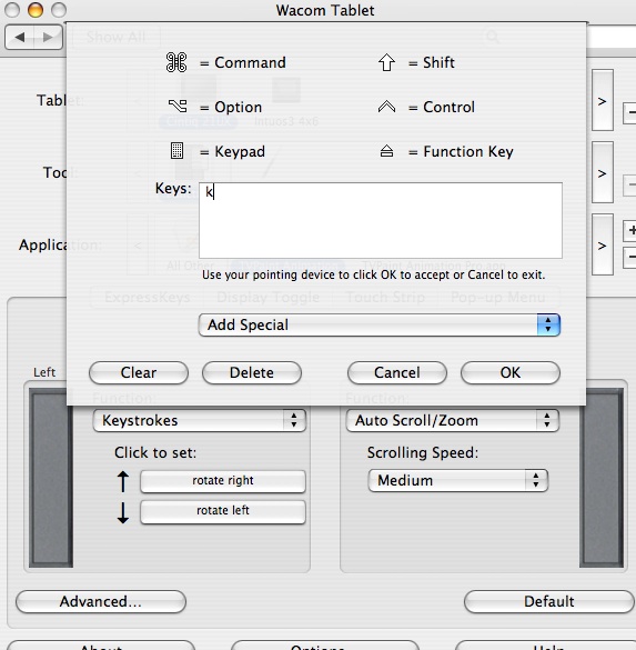

I had hoped I could use one of the touchstrips for rotating the canvas - as I don't always feel like rotating the Cintiq. Is that possible at all?
Thanks
John
Jbotofte wrote: I had hoped I could use one of the touchstrips for rotating the canvas - as I don't always feel like rotating the Cintiq. Is that possible at all?
Yes, absolutely. You can set up one of the touchstrips for keyboard shortcuts K and L and use the touchstrip to rotate the canvas.
I use the Griffin Powermate wheel because I like the feel of it more for rotating and scrubbing through the timeline , but the Cintiq touchstrip will do that , too.

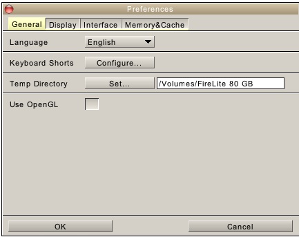

It also helps to set up a Temp File Directory in the Preferences .
I have my Temp directory set to an external firewire drive.
