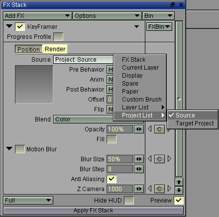

here, just use the KeyFramer FX, 2 keys with ease-in and ease-out,oliveuk wrote:... but there are few features I am not sure are available in TVpaint like translating a layer on the screen over few frames by setting up 2 keys like I have on shot 8. and what about scaling?
for panning and/or zooming, use a larger project as Source (in Render tab).
feel free to ask anything else if you need some more helps.

your Source Project and Target Project both open, go to your Target Project,oliveuk wrote:...
Zigotto "or panning and/or zooming, use a larger project as Source (in Render tab). "
where is the render tab?
Olive
in the FX-Stack panel, Add FX/Motion/KeyFramer, you have now 2 tabs,
the 1rst one, "Position" for setting the positions (X, Y, Z, ...),
the 2nd one, named "Render", where you can set the source for the KeyFramer_FX. (see pict.)
