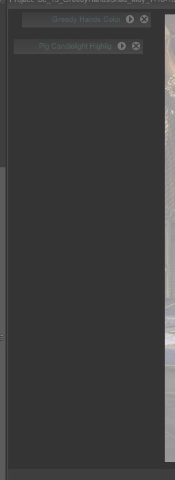

When I save my .tvpp file I save it with the custom panel(s) minimized(compacted) , like this :

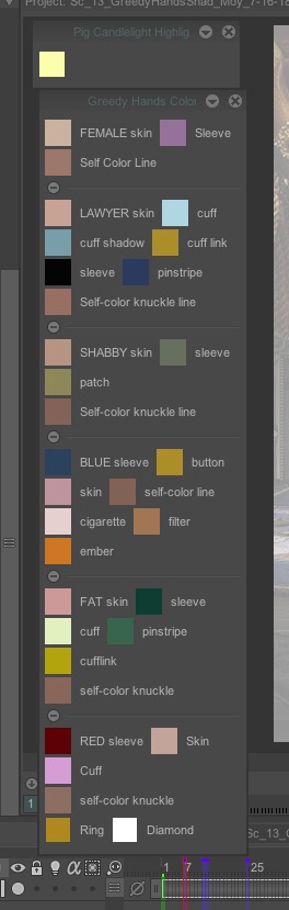

However, when the .tvpp file is opened again (by a colleague or by me) the embedded custom panels automatically are expanded . The request is that embedded custom panels will remain minimized if that is the state that the user had them when the .tvpp project file was last saved . So opening up the scene the panels should still be minimized as in the first attached image, not expanded as in the second attached image.
