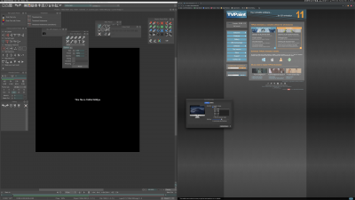

i'm using an imac with the resolution of 5120x2880. I created a screenshot for you with TVP and Photoshop showing the same file at 100% zoom. TV Paint does not use the full resolution instead the whole interface including the file is pixelated. This is not the case when i boot into windows and use the same monitor.

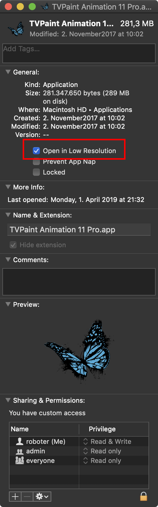

I already tried to tell the OS to run the App in low and hi resolution – no fix. please see the attached screenshots.
Interface pixelation and scaling up file:

Low / high res settings

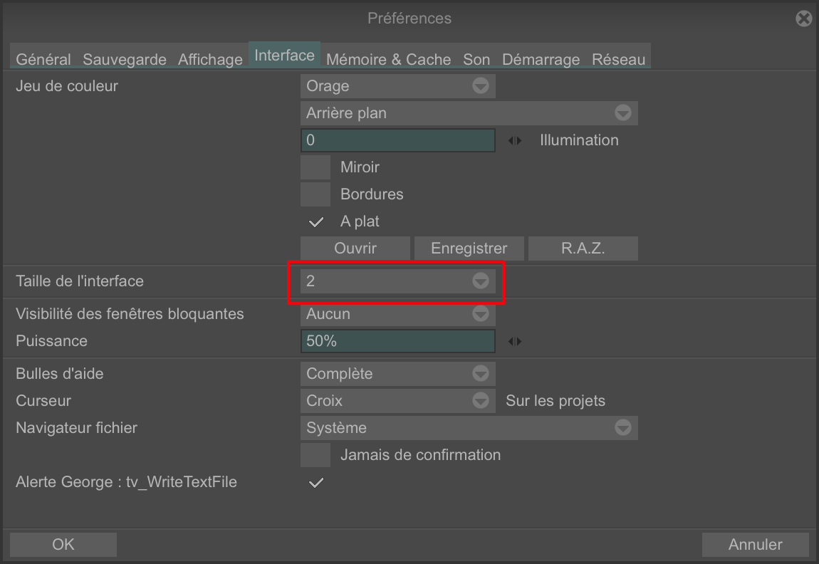

Hi, I have an iMac 5K at the office and TVPaint is not pixellated when I run it.
Did you try to upscale the interface ?
This screenshot has been made on a 5120x2880 screen with an interface scale of 2
Please,
go to preferences -> interface -> interface scale and change it to 2 (or 3 but it will be really big in this case !)
And be sure to not run the software in "low resolution".
Feel free to say if it's better or not for you.

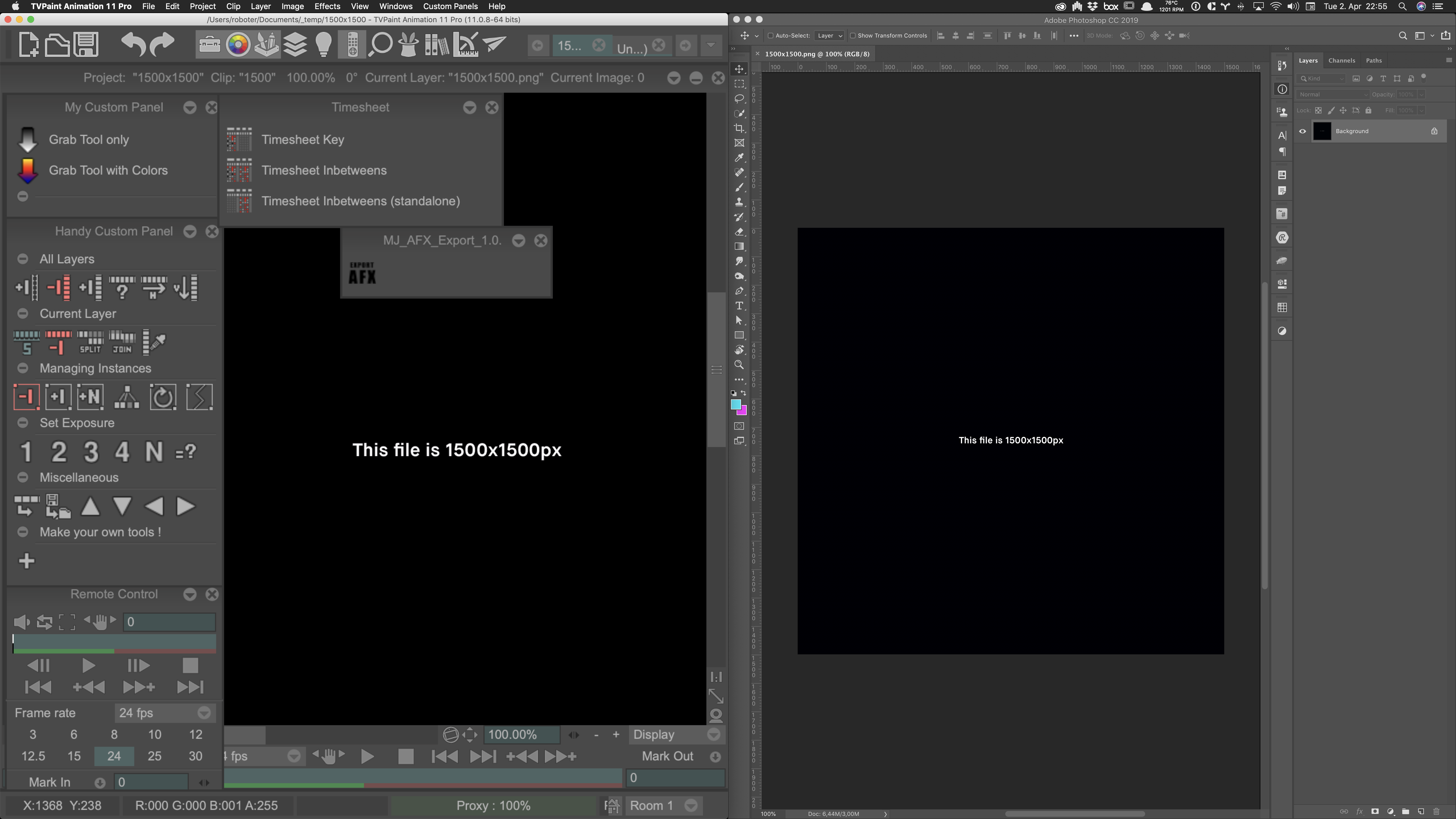

i set the interface scaling to 2 and ran the software in low resolution and in 'not low resolution'. The interface is scaled but that does not help anything. Can you post a screenshot of two apps side by side from your 5k iMac at work?

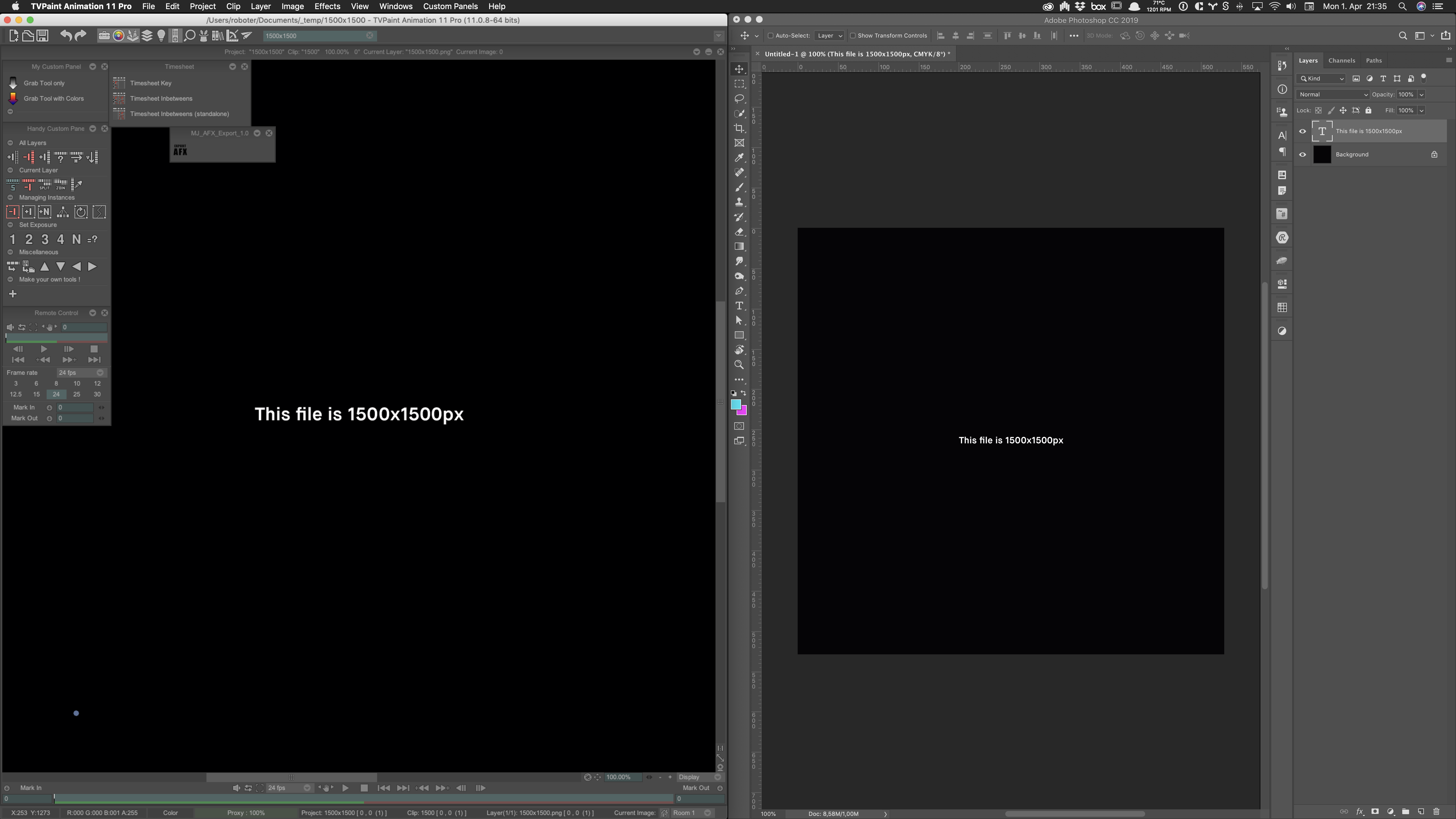

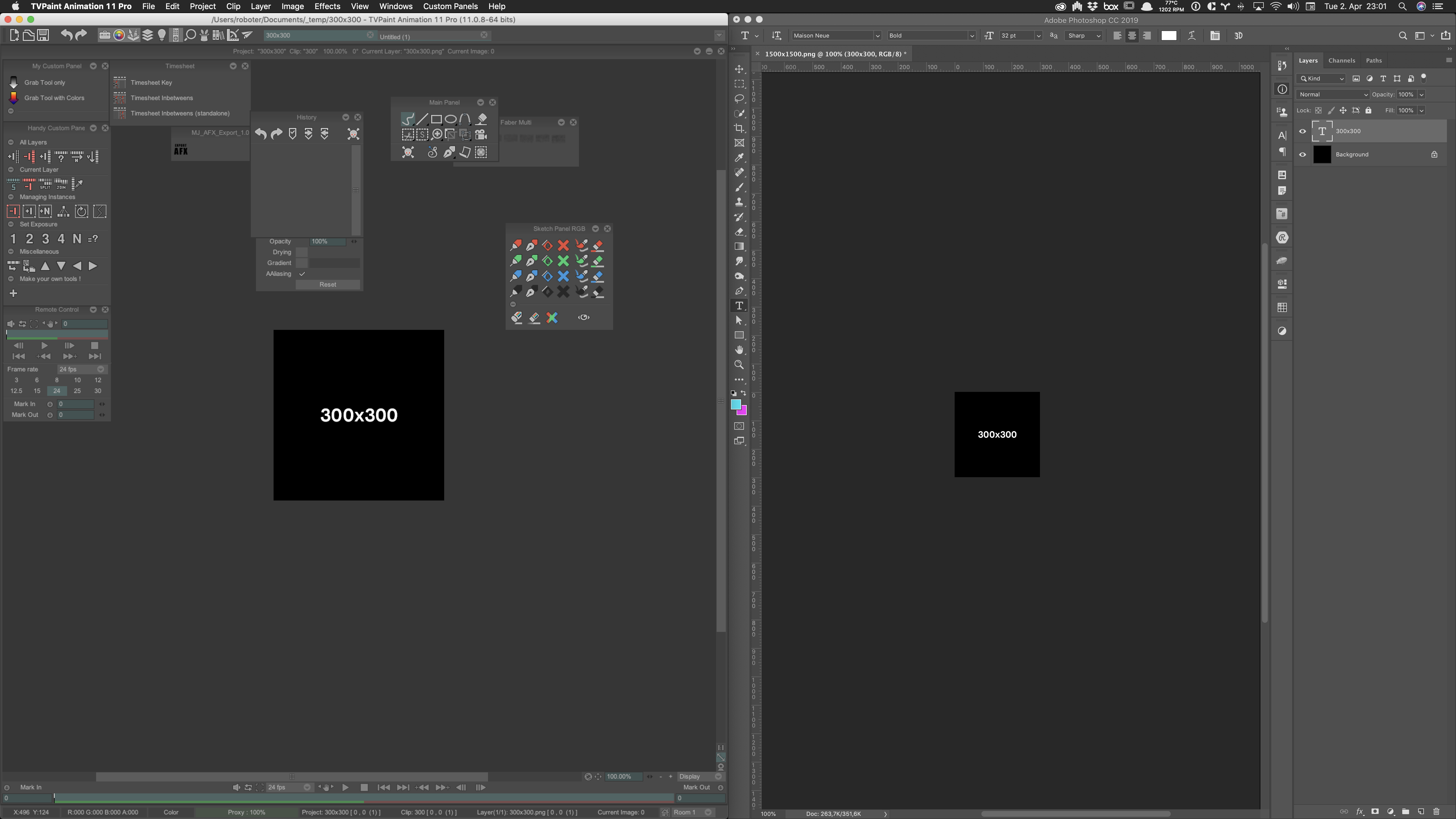

I made another screenshot. Photoshop and TVPAint are at a 100% zoom in Photoshop the file takes up 300x300 'physical' pixels in TVpaint 600x600 so you never get a crisp 100% view which uses the available pixels.

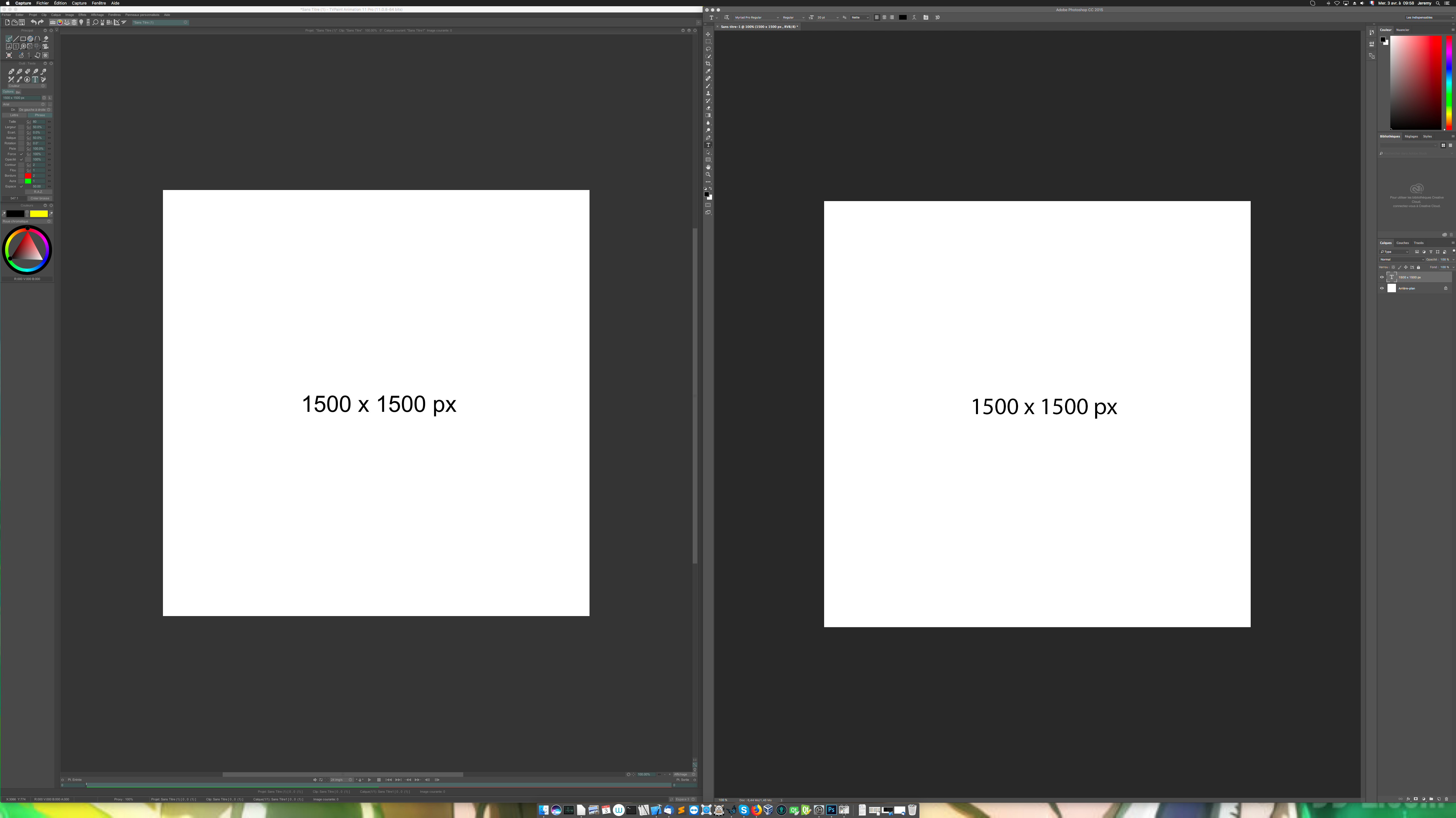

Hi, here is a screenshot of my desktop with TVPaint (interface scale is 1) and photoshop. Each project is 1500x1500 and each zoom factor is 100%.
Strange your 1500x1500 project is "bigger" on your screen than mine.

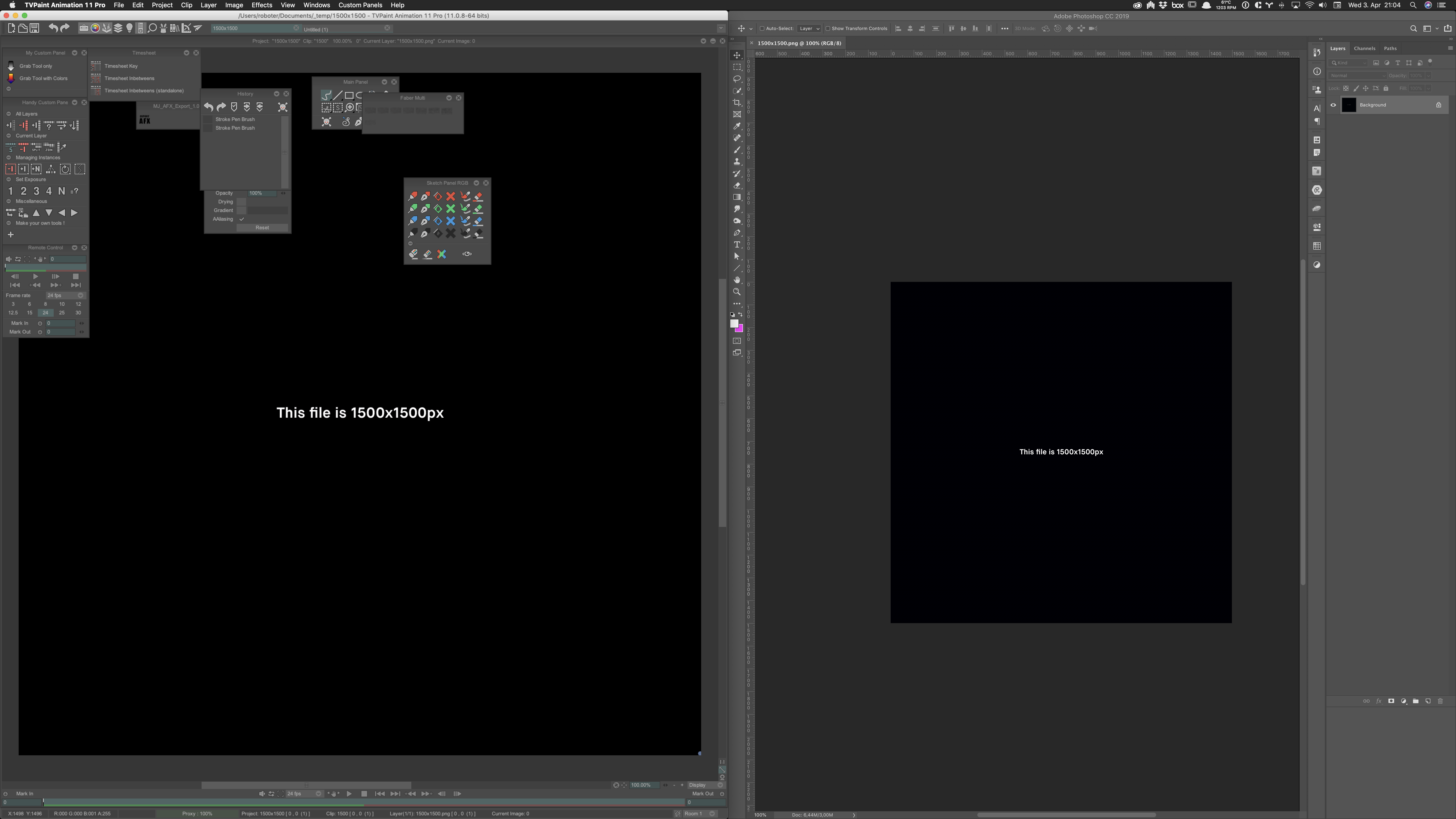

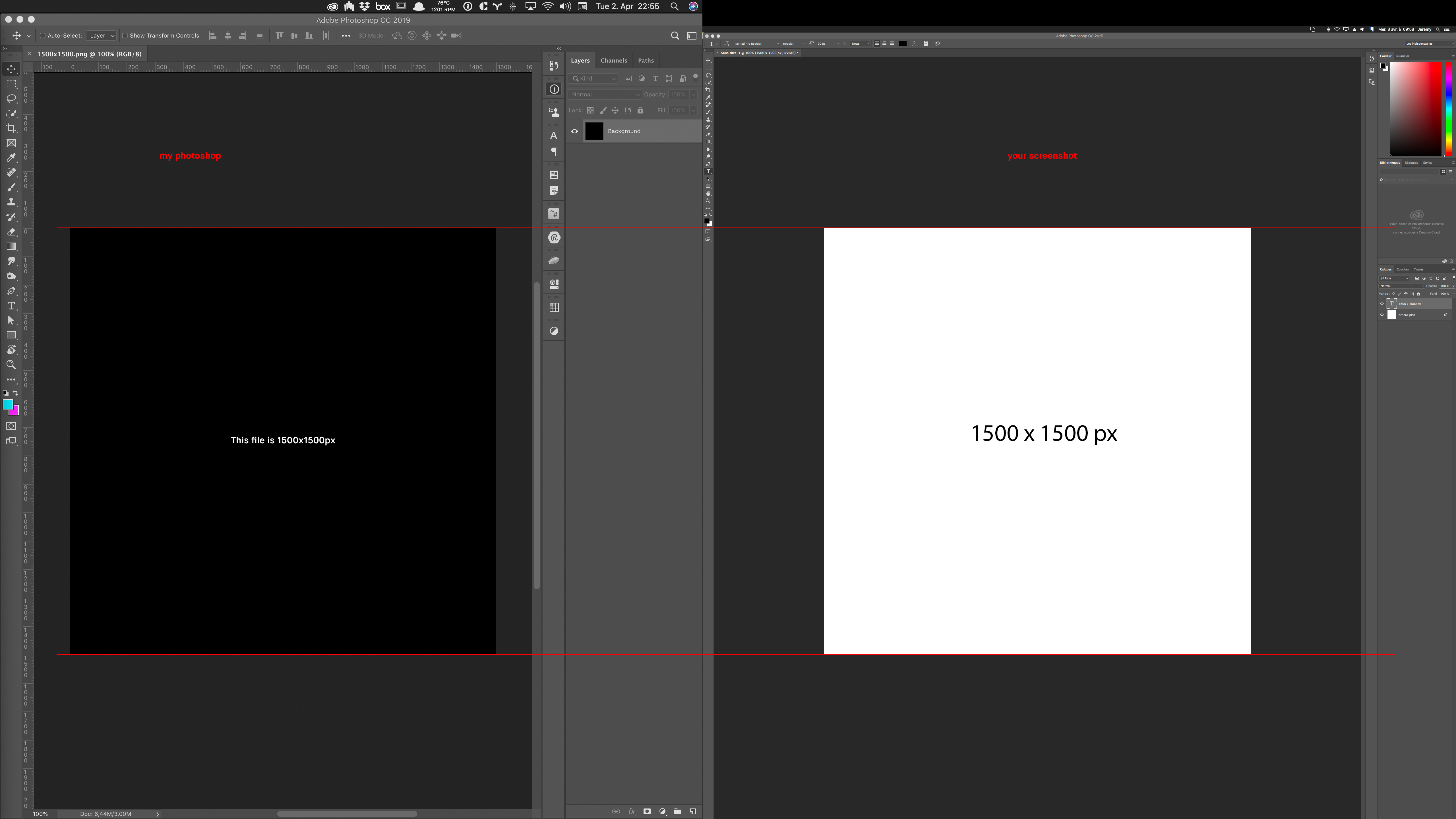

Here is a screenshot of my computer. Photoshop looks so crisp and clear on my computer, much more crisp than JeremyN's screenshot. I don't understand what is going on since we're all using 5k iMacs. TVPaint looks fuzzy compared to my other software.

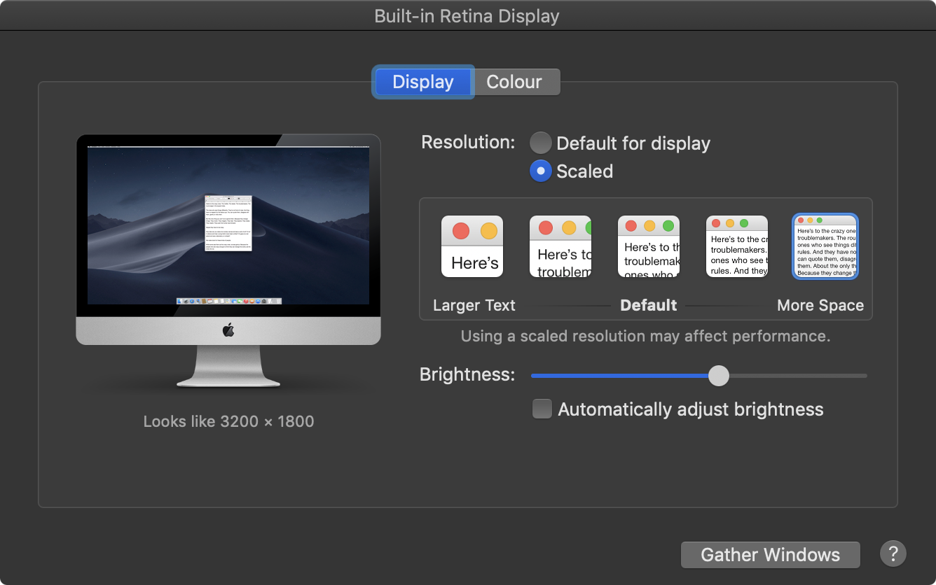

Hi jeremyN, i just noticed that all you interface, even the menu bar is much smaller than my interface, so it seems to be a MacOS setting. But even if i change the scale in system settings i do not get the result you have.
Menu bar compared:
Setting scale to 'More space'
Result:

Johannes wrote: 03 Apr 2019, 20:01 Hi jeremyN, i just noticed that all you interface, even the menu bar is much smaller than my interface, so it seems to be a MacOS setting. But even if i change the scale in system settings i do not get the result you have.
Menu bar compared:
Result:

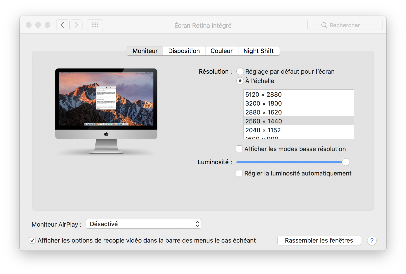

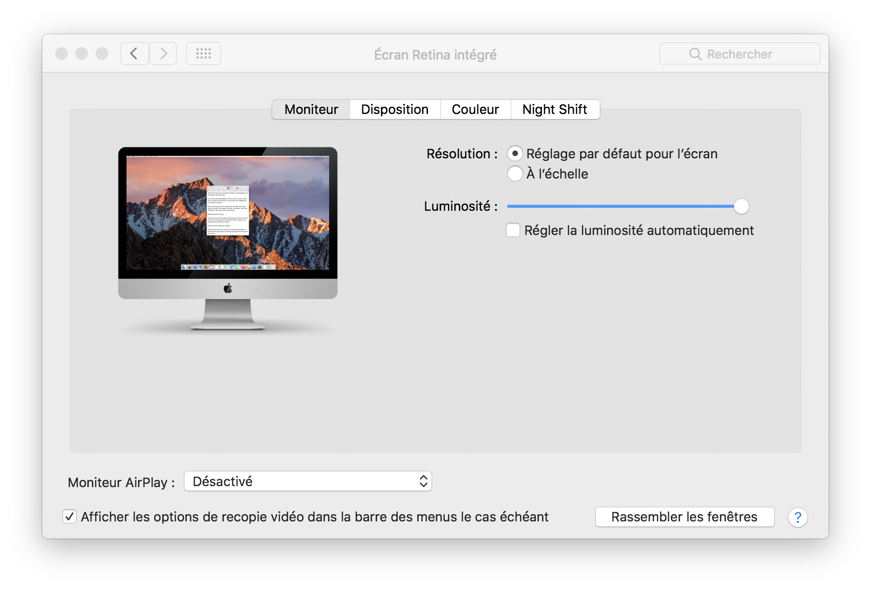

Hi Johannes.
Well, before selecting a setting on this panel:
Press "Alt" then click on scale and you will get this:
Press Alt before selecting "scale"
It's, to my mind, far more convenient (and clear) for selecting a screen definition. For me, Apple settings (like "more space") means nothing so I always use the "default" setting and use the workaround described above to change the screen definition.

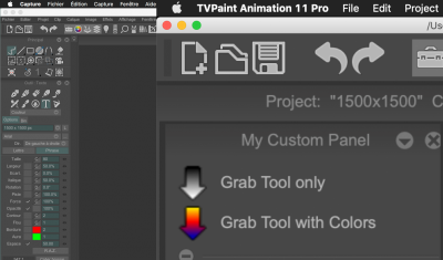

JeremyN wrote: 04 Apr 2019, 07:41 It's, to my mind, far more convenient (and clear) for selecting a screen definition. For me, Apple settings (like "more space") means nothing so I always use the "default" setting and use the workaround described above to change the screen definition.
This way TVP indeed uses 1:1 pixel. But this settings make every other app and the OS a pain in the a**** to use. So i'd rephrase my question: Will there be an update to use 1:1 pixel like for example photoshop or most apps besides TVP? It would be okay for me if just TVP is using this tiny interface but when everything is that tiny i get headaches very quickly:
