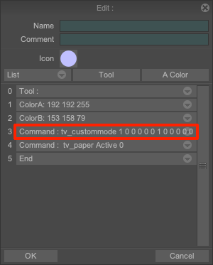

Re: Bug: Unable to Modify "Magic Blue Eraser" Tool from Sketch Panel
Once you have saved your brush with the desired size, edit it, and insert a new command:TheQuestionMark wrote: ↑15 Dec 2018, 19:31 So I've been using sketch and I discover a bug. When you try to copy "Magic Blue Eraser" tool from Sketch Panel, paste to another tool bar, and try to modify the size, and save the tool. It sets back to "color" mode and doesn't set back to "custom" mode that it won't erase BluePen Brush.
tv_custommode 1 0 0 0 0 0 1 0 0 0 0 0 1 0 0 7225 7225 -10881 1 0
You should then get your custom mode back every time you click on the brush.

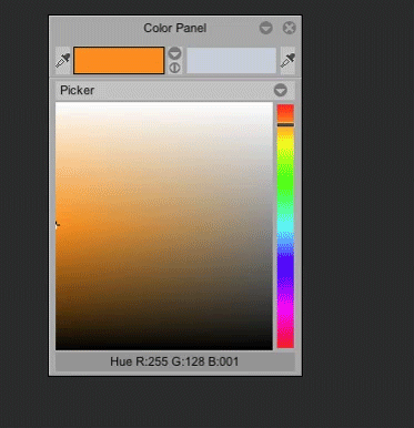

I don't see the color code for RGB. The numbers that melanie gave goes up 7225, four digits.
Have a look at the User Manual:TheQuestionMark wrote: ↑28 Apr 2019, 06:40I don't see the color code for RGB. The numbers that melanie gave goes up 7225, four digits.
https://www.tvpaint.com/doc/tvp11/index ... der-picker
"Each option of the Color panel has a line called Status bar at the bottom of the Color panel. Its purpose is to indicate the RGB, HSL or hexadecimal values of the A color.
Click on this bar to change this display."
The Color Slider option shows RGB , HSL and Hex all displayed at the same time:
I guess I misunderstood what you are asking for . It looked like you said you did not know how to view the RGB number codes .TheQuestionMark wrote: ↑01 May 2019, 12:35
But how do you enter script code for the magic eraser. Look at melanie's post it more complicated than typing in the RGB code of what your showing.
I see now what you're asking about . Sorry, I know nothing about scripting .
But looking at Melanie's post , I don't think the four-digit numbers have anything to do with the RGB codes , because in the image she posted the RGB numbers are in
the two lines above the line of script that is under discussion , unless I'm missing something.
You had written:
referencing Melanie's line of script:"I don't see the color code for RGB. The numbers that melanie gave goes up 7225, four digits.
7225 7225 -10881 1 0"
But I don't think that line of script has anything to do with RGB codes (?) . (but again, I know nothing about scripting , so maybe I just don't get what it is you are asking .)
