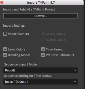

Bumping this up from David Meslin's unanswered post on Feb. 04, 2019 .
I have recently updated my After Effects to CC 2019 (v16.1.1 - Build 4) and I am sorry to report that the TVPaint JSON import script does not work in AE CC 2019 with Mac OS 10.12 Sierra.
I am using version 5.7 of the After Effects Import script.
Screen Shot 2019-06-18 at 3.57.46 PM.jpg (23.7 KiB) Viewed 16817 times
Could someone from the TVPaint Development Team please respond to confirm that this is a known issue and is there any fix in the works ?
Thank you.
-David N.

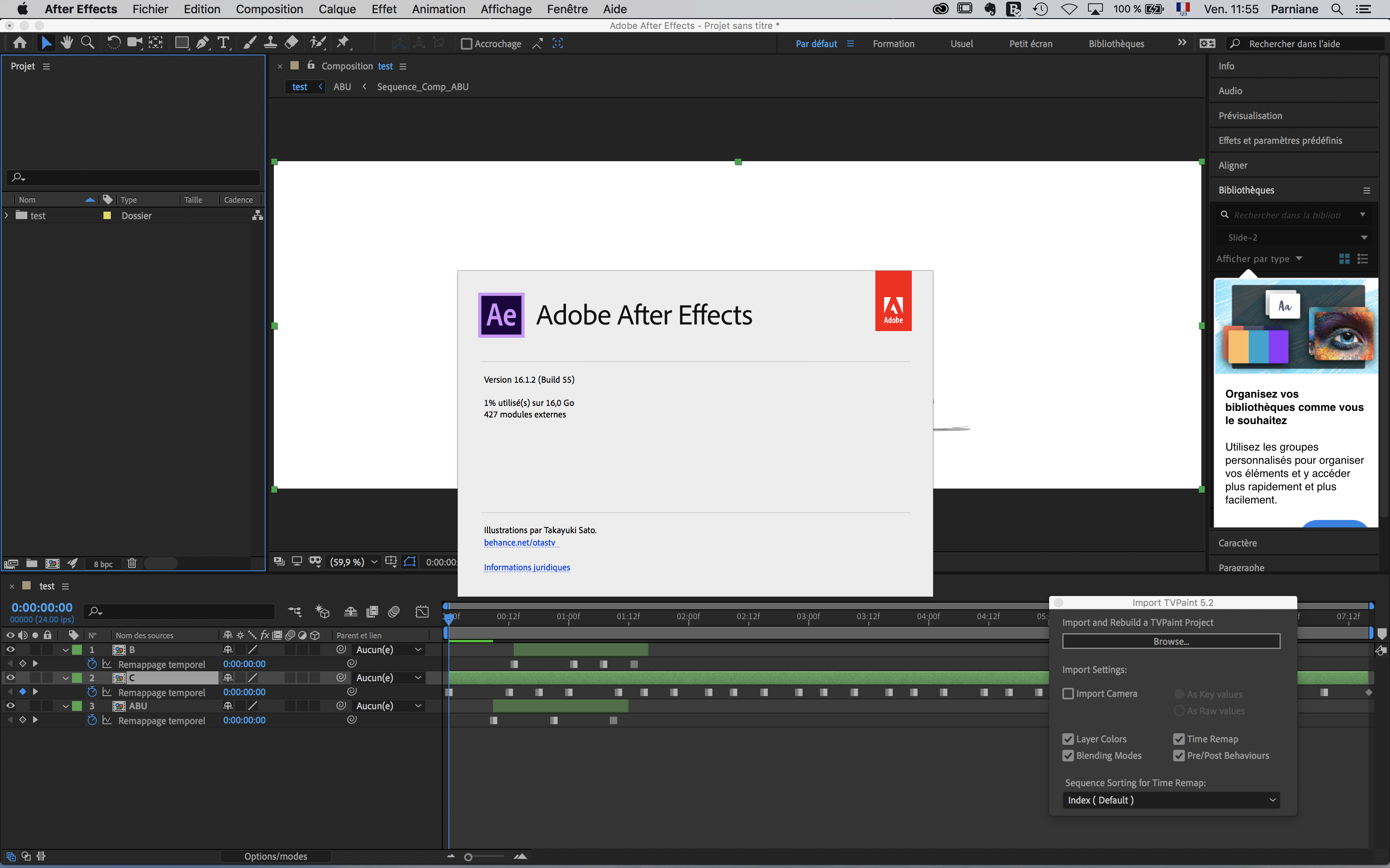

I've run some tests on both Windows 10 (I don't think we have any Windows 7 left, we all made the swtich to W10) and macOS Sierra 10.12.6.
The After Effects version used for the test was AE 2019, v16.1.2, Build 55. I used the JSOn export in TVPaint 11.0.8 to export one of my tvpp files so the JSON file is a newly created one.
On Windows 10, no issue: the Import panel is there, I can browse and select a JSON file, import it, and have the TVPaint structure re-created in After Effects.
On macOS Sierra, it's the same, it works:
@David:
It seems that we are not using the same AE version: you are using v16.1.1 and we are using v16.1.2. Can you update to this version and try again?
