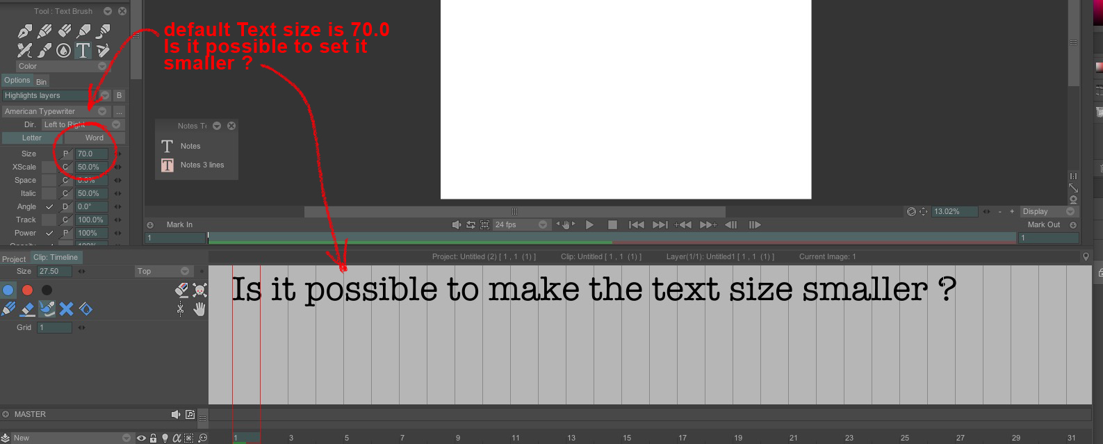

Would it be possible to make the text size adjustable , so it could be smaller text ?

D.T. Nethery wrote: 16 Aug 2018, 14:46 Would it be possible to make the text size adjustable , so it could be smaller text ?
This will make it so the text tool is not changed to the parameters specified in the original code. So the settings you had before you activated the function will persist.
Steps to get to the window above are in the spoiler
Spoiler : :
Right Click on the icon[/b]
Hit the drop down menu on line zero and select "Embedded George Script"
You can change the font size here
