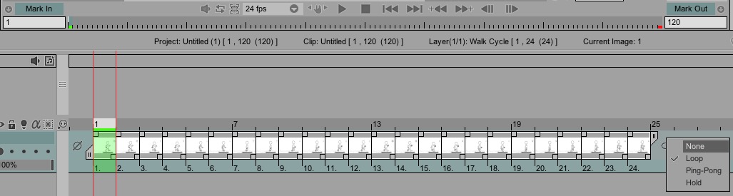

Re: Export looped clip
martimiz wrote: 13 Jan 2020, 16:21 wel... eh... and oops... :oops:
Found out that it is actually soooooo easy, and I knów I tried it before but I must have made a mistake then, because (and here it comes):
- set all layers to loop
- set outpoint to some frame in the future
Good.
This should be added to the User Manual under Exporting. Because I think people do frequently have looped animation (such as a walk cycle) they would like to export so that on the .MOV file it will repeat , but without having to copy & paste the animation numerous times on the Timeline.
To export a repeated/looped action:
-Set all Layers to loop
- Set Mark-Out frame to however many times you want the animation to repeat.
(for example , a 24 frame walk-cycle, Set the walk cycle layer to Loop. Now set Mark-Out to 120. This will mean
that it repeats the 24 frame cycle 5 times upon exporting. Set Mark-Out to 192 means the 24 frame walk cycle will repeat 8 times, etc.)
Screen Shot 2020-01-13 at 1.18.03 PM.jpg (64.47 KiB) Viewed 213919 times
