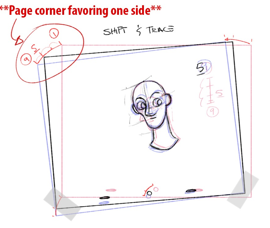

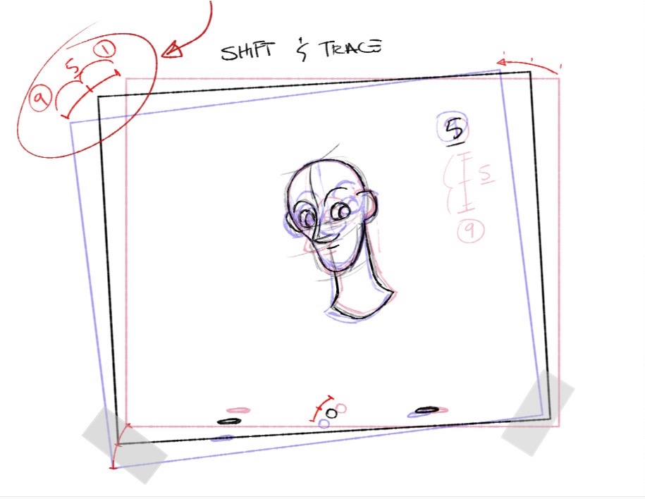

I realize this has been discussed before , but it's been a while since the topic came up and I think it is time to talk about it again.
For inbetweening "out of pegs" (aka "off pegs" ... for "shift & trace") if I do it on paper with drawings shifted off the pegs
inbetween off pegs.jpg (77.25 KiB) Viewed 31456 times
when I put the drawings back on the pegs, the inbetween drawing will be in registration with the other two drawings , half-way in the middle of the other two drawings, because of the pegs.
But in TVPaint when the drawings are returned to their original position the inbetween drawing position is still shifted out of place (not positioned in the middle) and then it must be manually re-positioned using the Transform Tool. (which is not ideal for clean-up inbetweening because Transform Tool subtly degrades the line quality, especially if the drawing has been shifted out-of-pegs and transformed several times). What I would like to request as an improvement for the Out Of Pegs feature is that when the drawings that have been shifted "out of pegs" are returned to their original position, the newly created inbetween drawing will automatically snap to the correct position between the other two drawings. Could this be done by using the peg holes symbols as a tracker that aligns the drawings ?
(in my note on the screenshot, where I wrote: "#7 also has peg hole symbols which are
aligned to the other two drawings"
I meant to put it in the from of a question:
"Could #7 also have peg hole symbols that are aligned with the other two drawings ?" )

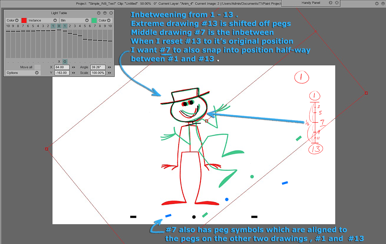

Then when the drawings are returned to their original position, the new inbetween drawing should snap
into position , half-way between the other two drawings -

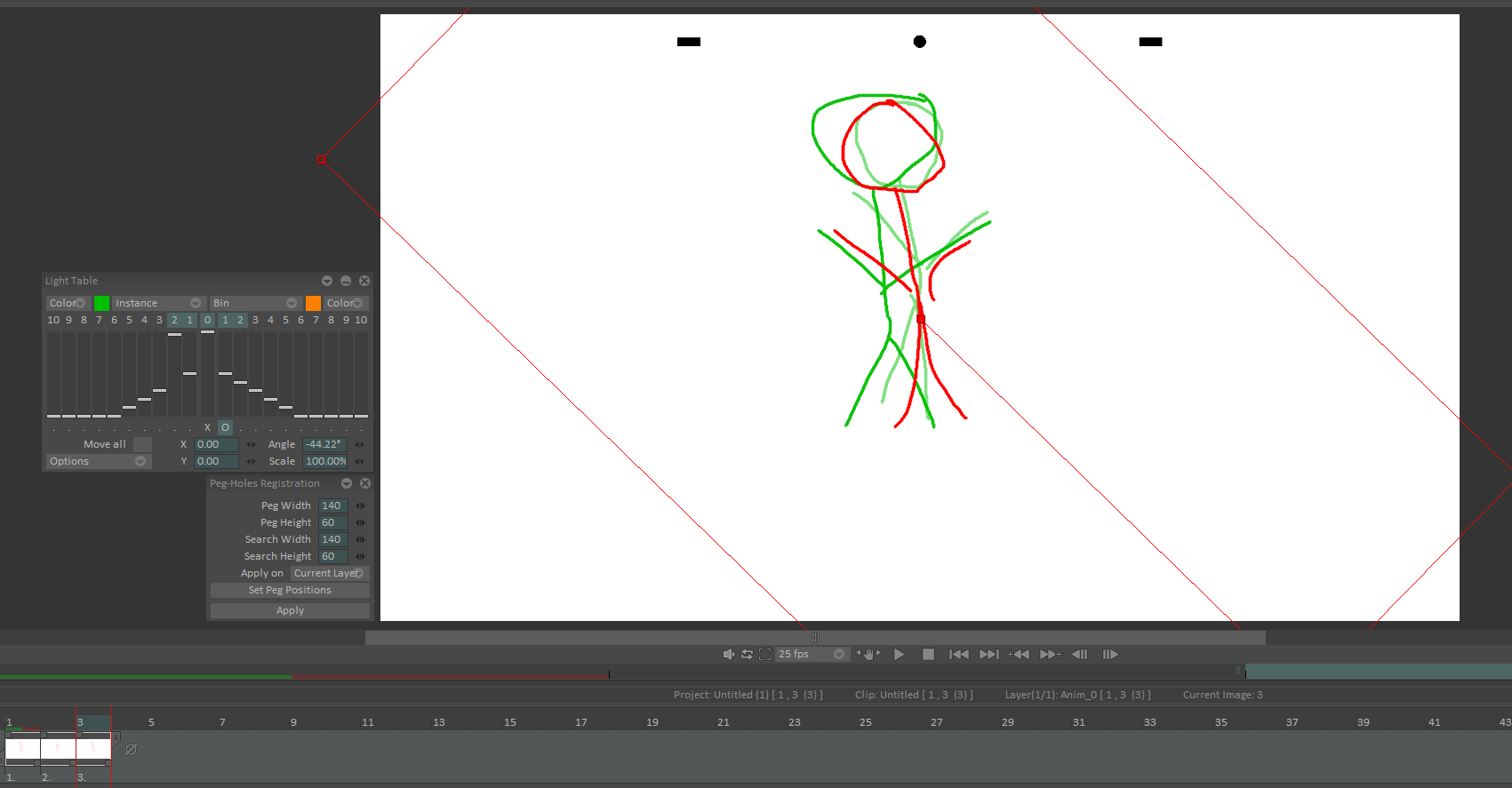

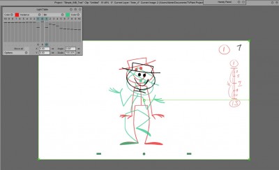

Ok, so I'm in the same situation:
My image on the right is tilted, like yours.
But when I go to the next image, the image is no longer shifted, even if the tilt parameters (the angle) are still in the Light Table, as you can see in the screenshot:
I'm not sure I understood the problem correctly :|

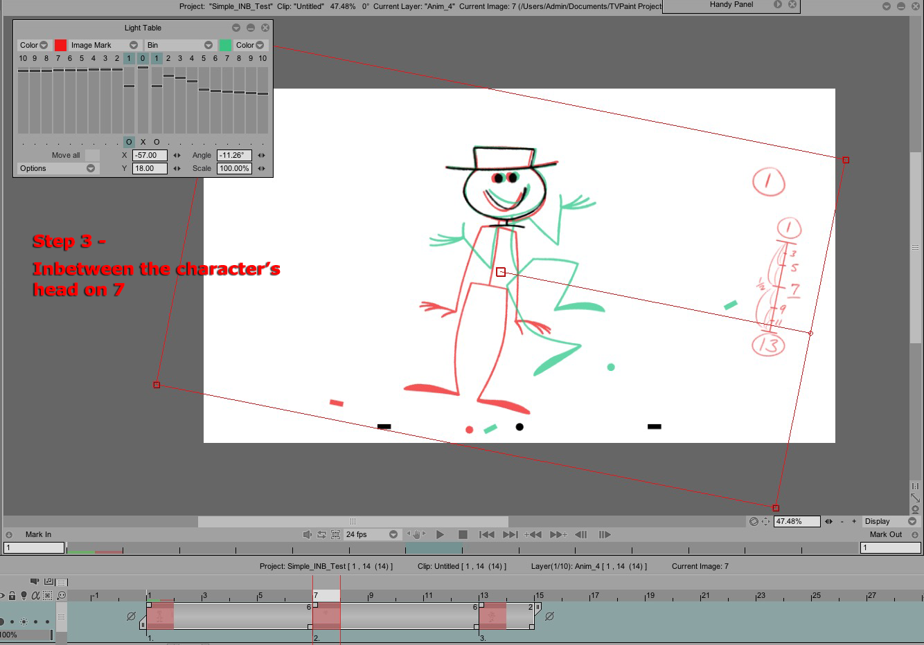

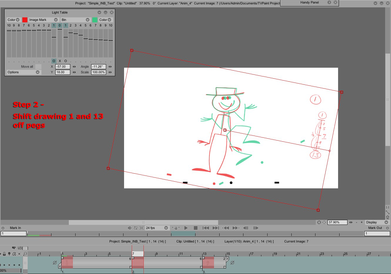

So I'm trying to it exactly as you say, but I don't understand what you mean by you "indicate the position of the inbetween" ... the inbetween frame is blank , so how do you mean you indicate the position of the inbetween ?
When I shift drawing 1 and -1 and do the inbetween, then click the X under frame 0 the two outer drawings snap back to their former non-shifted positions, but the inbetween is not in the middle , so I have to manually shift it using the Transform tool to get it to be in the middle.

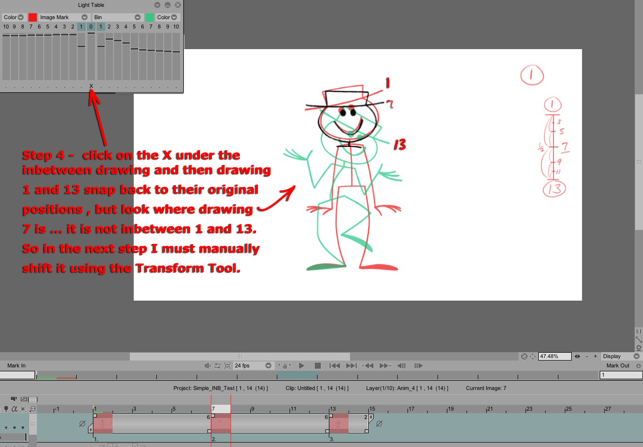

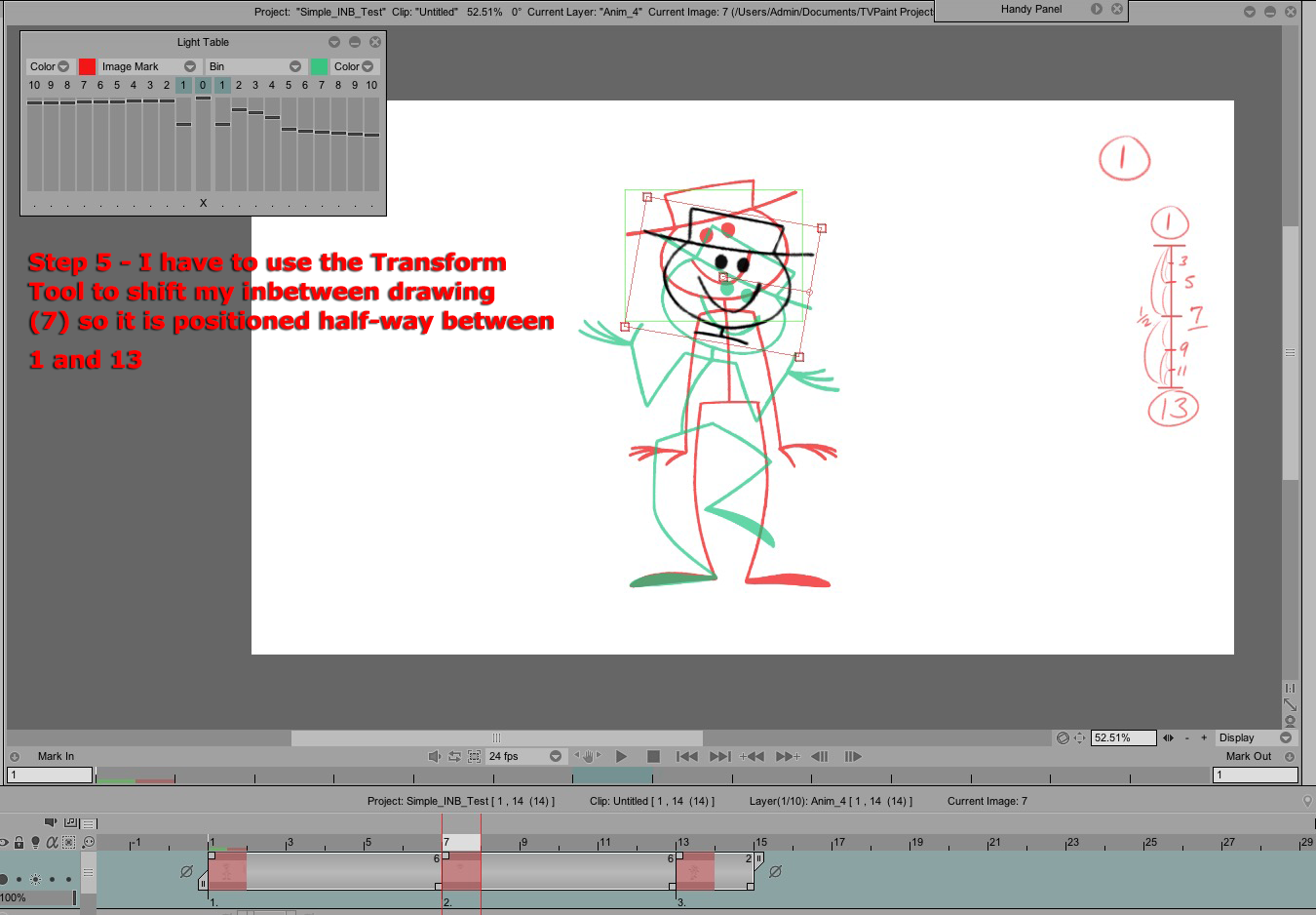

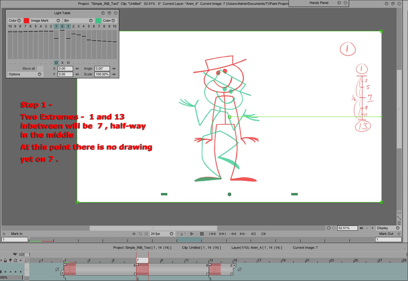

Here is the process I'm following . Where am I going wrong ? ---
STEP 1 -
STEP 2 -
STEP 3 -
STEP 4 -
STEP 5 -
Posts: 2982
Re: Improving Out-of-Pegs inbetweening system

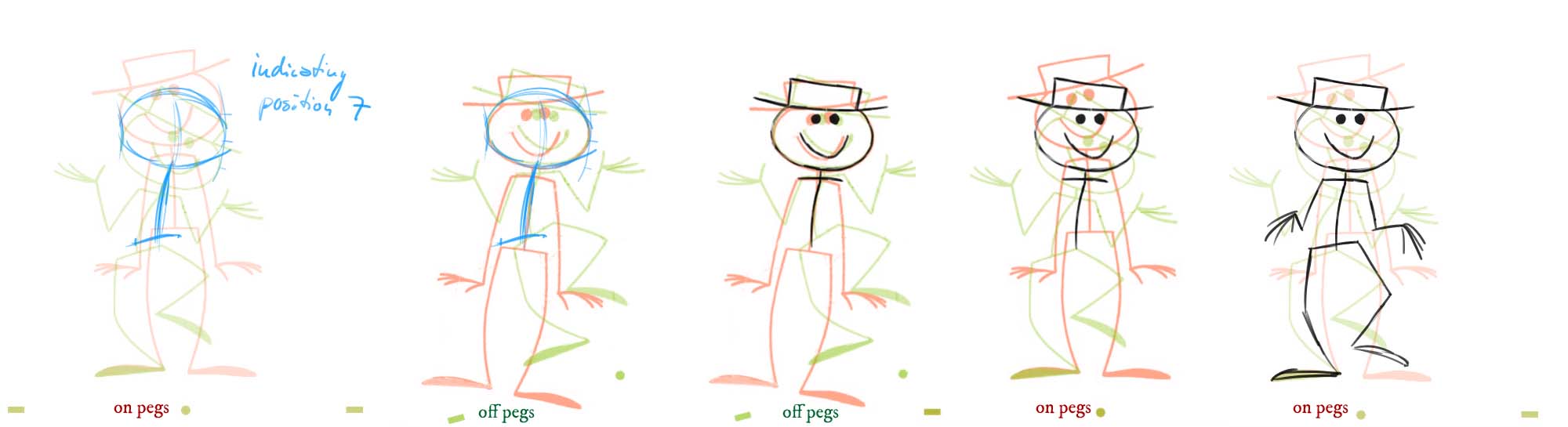

When I do inbetweens, especially those with wide spacing between frames, I first indicate the inbetween position of the character/object, just top and bottom, or a circle for the main mass. This way I mark the path of action and the spacing, before I shift anything off the pegs and do the clean stuff.
As you can see, the blue sketch indicates where I want my #7 inbetween. Then I take frame 1 and 13 off the pegs, draw what I need, and put them on pegs again and add the rest. No need for shifting the inbetween because it never left its place.
(To word it differently: I put 1 and 13 off the pegs, whereas you put 7 and 13 off the pegs and left 1 in place.)
(When I started as assistant animator in 1990, we got some xeroxed pages with basic inbetweening knowledge. Minding the arcs was very important, so it became a habit to first indicate the position of anything, then do the drawing.)

Ah, I've added some drawings in the meantime ...
The thing is that the inbetween is already in its correct position when you have put both outer drawings off the pegs.

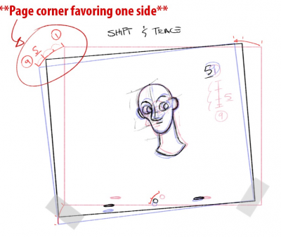

- it will only work for any straight-in-the-middle inbetween
I don't think so , because in what I'm proposing the registration is based on the position of the embedded peg hole marks ... if you favor one extreme or the other in how you position the inbetween drawing between the extremes when it snaps the drawings back into place according to the peg hole positions , then the inb drawing will favor one or the other of the extremes, not be half-way in the middle. Just like in doing it on paper.
