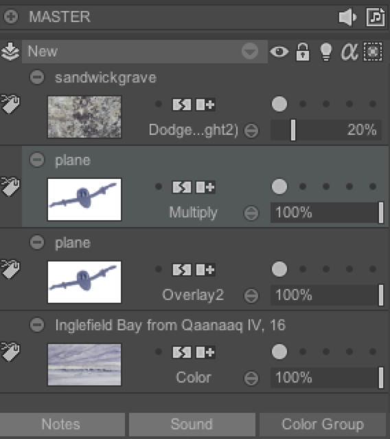

Hi folks
After a break, I have another project, and am trying to figure out my set-up. It's a case of animating on top of pre-existing paintings. The client likes my use of layered textures but I don't think it's right to apply these to the original paintings used in the background. In the attached set-up, the background is being affected. I'm trying to think what's the best way to apply the texture (currently top layer, "Sandwick grave") to my animated elements (here, the duplicated layers "plane") without affecting the background layer?
thanks for any help.
Catriona

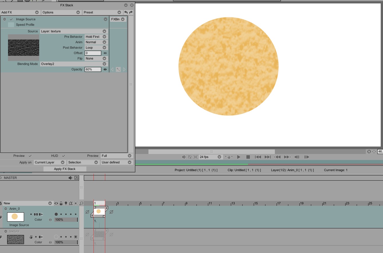

Re: layered textures
Catriona wrote: 16 Jan 2020, 11:32 From a bit of fiddling about, it looks like that only works for drawing you specifically do after putting on the masks? And not for the imported photographs I want to use.
It seems to me this might be something you could do through the FX Stack to apply the texture to your animation drawings. (best to create a dupe layer of the animation and apply texture to that.) Color > Image Source , set the source to your Texture layer, with blend mode Overlay 2 . That could work.
