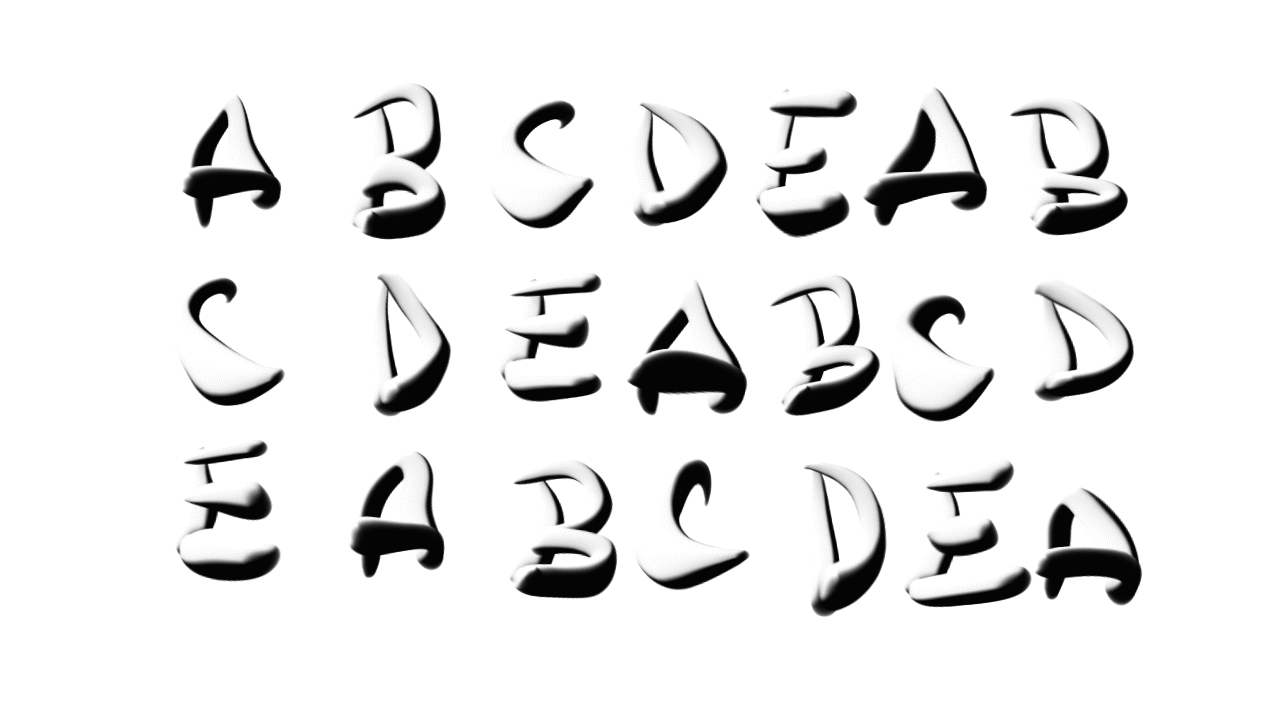

Here is the workflow for creating three random vectored keyframe, source/destination fields, each 5 frames apart, copying the original random vector key to the 21st frame for a smooth loop.
1. Setup a layer with a single image for 20 frames.
2. With cursor on frame 1, select Random. Leave Seed at 123456. Set Length 10. Leave Variance on 10%.
3. Press keyframe icon.
4. Move cursor to frame 6 (keyframe is automatically added capturing new field of random vectors)
5. Move cursor to frame 11 (keyframe is automatically added capturing new field of random vectors)
6. Move cursor to frame 16 (keyframe is automatically added capturing new field of random vectors)
7. Move cursor to frame 21 (keyframe is automatically added capturing new field of random vectors)
8. Immediately select Brush (round)
9. Select keyframe @1, and copy it.
10. Select keyframe @21, and paste keyframe from frame 1.
11. Press play to view random interpolations of the green destination grid and blue vectors.
12. Apply FX Stack
Click to view Example:
Introduction to a Random OpticalFlowDeform FX
