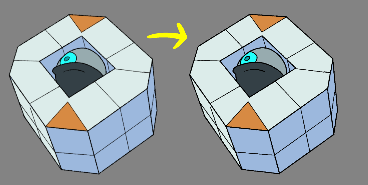

I accidentally forgot to up the project doc to 4K while cleaning
up my animation, still using 1080p like I do for the roughs.
