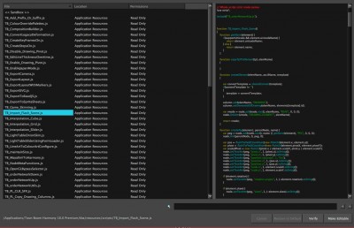

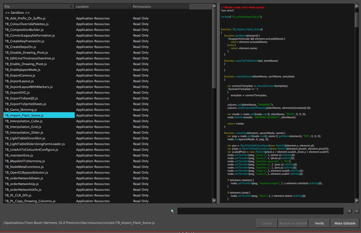

https://docs.toonboom.com/help/harmony- ... pting.html
https://docs.toonboom.com/help/harmony- ... rence.html
"The Harmony Scripting guide contains information to help you use Qt Script, the scripting language used by Toon Boom Harmony Premium.
Qt Script provides access to many of the functions supported in the Harmony interface. With Qt Script, you can automate a number of Harmony functions to speed up the completion of various repetitive tasks."
Here is what the script editor looks like (I have no idea how this works , this is just a list of preset scripts) .
The one shown is for "Import Flash Scene . Description: Import a export.json file generated by the Export to Harmony and recreate the hierarchy of pegs and read."
https://docs.toonboom.com/help/harmony- ... mport.html

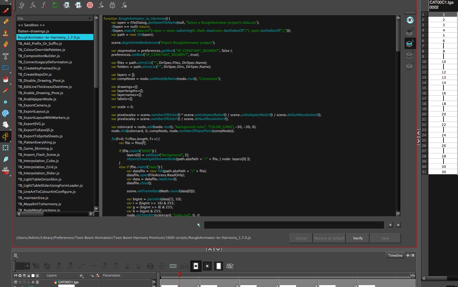

The Rough Animator app also has this function, to export from Rough Animator to Harmony. It's just a script you can download . Then it transfers all drawings and layers from Rough Animator to Harmony.
https://roughanimator.com/toharmony/

Yes, ToonBoom has a scripting language , see my post above with links.
Also notice the link I had posted to the app Rough Animator. Rough Animator has scripts to export/import to both Harmony and After Effects. Rough Animator is not made by a big software company, it's just one guy who wrote the main program and wrote the scripts.
Here is a description of how it works:
I've tried it and it's very easy to use, it perfectly exports the layers from Rough Animator (with all the exposure of the instances intact, on 1's , or on 2's , or held ) to Harmony .
This is what the script looks like :
Of course, to me this is an unintelligible alien language , I don't know scripting at all, I'm only a cartoonist. But this sort of script would be very handy to have, to allow animators to take advantage of TVPaint's user friendly interface and great drawing tools for animation and clean-up , then if the show I'm working for wants to finish up in Harmony for coloring with vector layers (which many do) , I could still use TVPaint to do my work and then deliver it to them as a Harmony file for coloring the drawings. If it was up to me I'd do it all in TVPaint , but as was written by Hilere at the start of this topic many years ago:

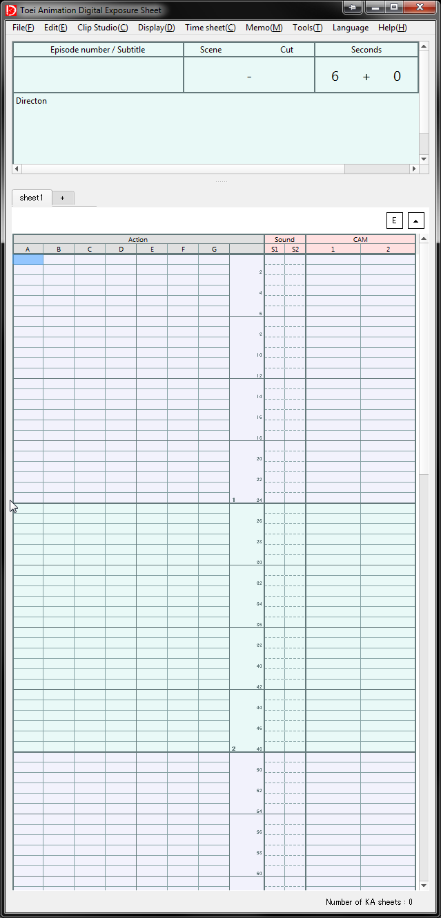

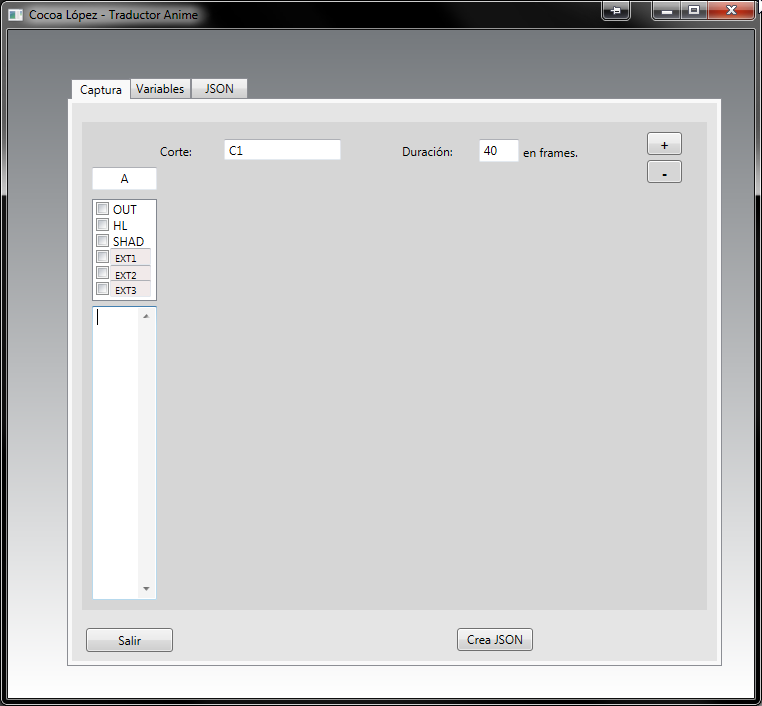

I'm thinking for those into ToonBoom they could have a programmer to script the parser for either json or xdts
(Json) as being the format that tvpaint exports, we created a program to export from 3dsmax /maya animation information to Tvpaint's json then we use a script to import that information onto a tvpaint scene.
I've seen wit studio using xdts to do the same so if there's anyone with knowledge of toonBoom, could have a programmer to write script that imports from an xdts or a .json directly onto toonboom.
xdts btw is the toei animation digital exposure sheet, its basically an xsheet software (what a godsend!)
