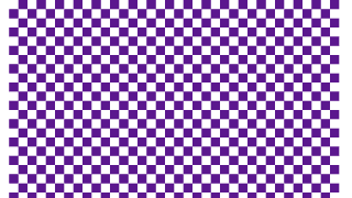

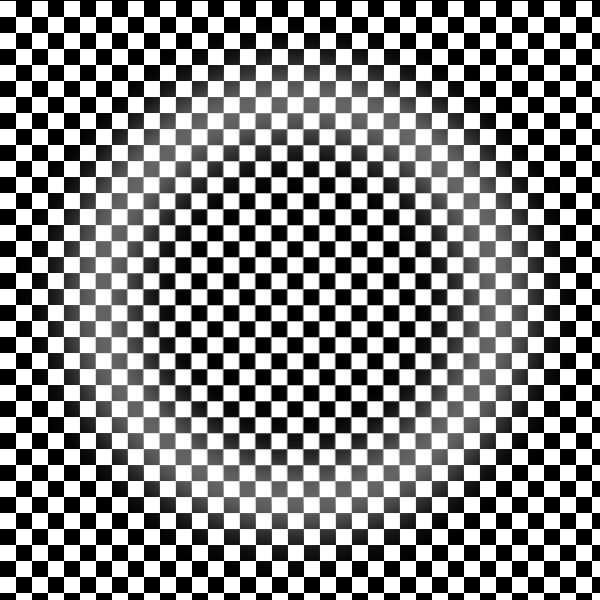

this is a 400pixel diameter circle selection with a smoothvalue of 100, and a transformtoolrotation of zero :
white smudge appears even if the rotation is zero?

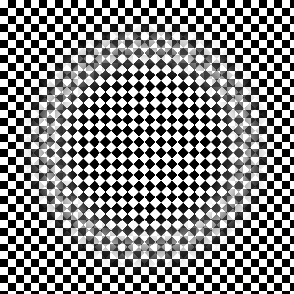

when you make any rotation there will be a smudge (caused by the fading of the smooth setting of the selection)
this is smooth value 100

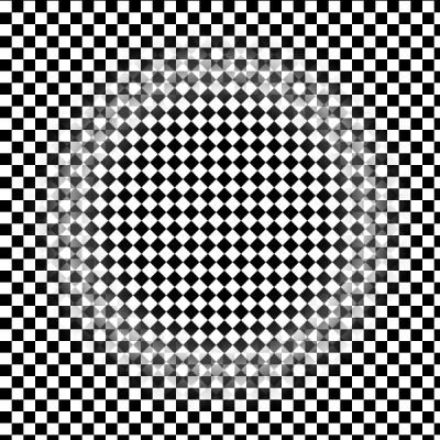

I would like to have a way in tvpaint where rotating part of an image can be achieved with a gradual distortion (rubber), instead of a gradual fade.
and also have a larger fade range then 100, so that i t would be possible to do this:

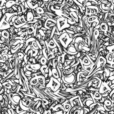

this image was achieved using the warpgrid, it has to be done manually and is quite labor intensive as you cannot create a bounding box on selected gridpoints.
This would be an alternative way of achieving what i want,

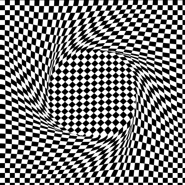

Just did a test with the old wrapping grid:
It's possible, but a PITA. And you can't reuse it other than in the exact same spot since you can't scale it.TVP 10.0.18 and 11.0 MacPro Quadcore 3GHz 16GB OS 10.6.8 Quicktime 7.6.6

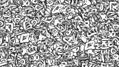

Here's an example which uses multiple circular deforms (also the background has been wrapped and unwrapped)...

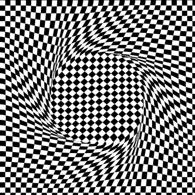

I think this is closer to what you want to do?
It's quick and dirty and rather convoluted, combining a keyframer operation with a flow deform operation (the seam doesn't quite match up but it could, given more care...) sven

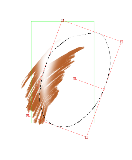

but what i need it for is to make painted strokes line up with a line drawing on a toplayer.
sometimes i only need to adjust a part of the painted stroke.
but when i make a selection with the transform tool i loose the connection with the part i want to remain in place.

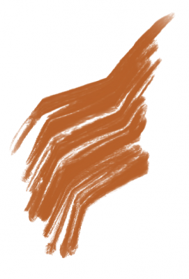

all the above is in search of a way to manipulate in such a way that no cracks appear: you can cover the crack a litttle bit with a feather, but its usually not satisfying... it becomes mist like: it should be rubbery, a bit like this: this was done with the warptool, but he warptool is also very limited in its controls.
You cannot rotate a selection of points, you cannot control the arc of the stretch...
