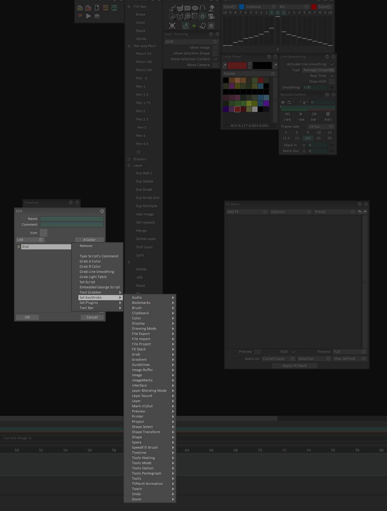

Is there a way to add a New-Anim Layer to a custom panel? I found a shortcut but have yet to figure out where the keystroke is located.

Re: Custom Panel Layers
ctrl-N (is the default i think?)
in the Keyboard shortcut panel its:
Layer Preset:Anim Layer
