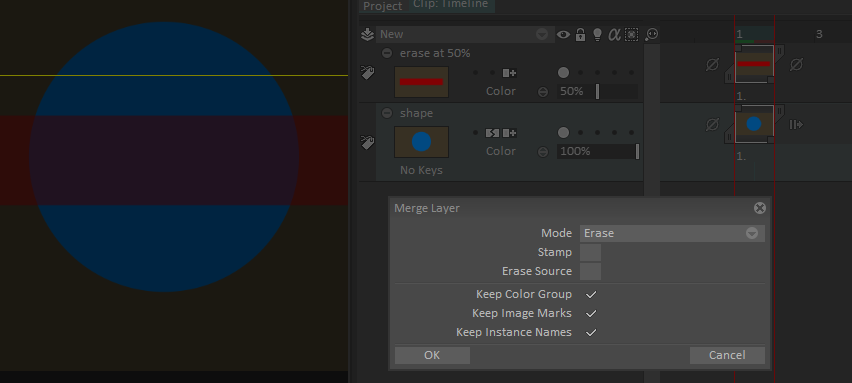

the Stencil function ignores layer opacity when you use CLR.
it will always CLR through the stencil at 100% no matter what layer opacity you have set.
if you want the CLR working at the layer percentage, you can only do that by merging it, using blendmode erase.
This requires a few more steps but its also not logic to me.
Isn't it logic that when you set a layer as a stencil,
that you control its strength (opacity) by the opacity slider?
image: mask is set to 50% but it Clears at 100%
Screenshot 2020-11-16 124601.png (21.69 KiB) Viewed 6186 times

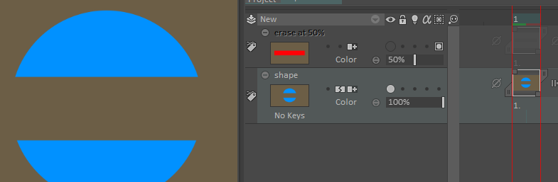

but when you merge with blendmode erase....:
Screenshot 2020-11-16 124750.png (31.55 KiB) Viewed 6184 times
then it does work:
Screenshot 2020-11-16 124807.png (25.42 KiB) Viewed 6184 times

I want to point out that I like to use the stencil with its source layer set to some transparency, or even 0%. If I want to clear something to 50% with a stencil, I use a rectangle fill set to 50% opacity at erase.
