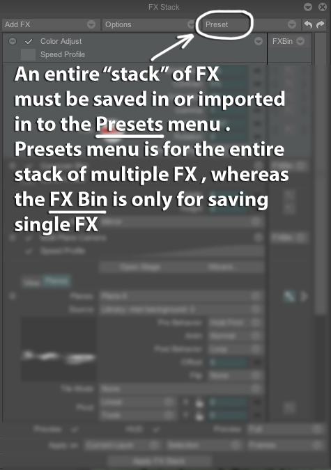

This reminds me of a correction that needs to be made to the User Guide , on this page:
https://www.tvpaint.com/doc/tvp11/index ... ails-reset
There is some confusion between the names of the FX Bin menu vs Preset menu. FX Bin may be used for saving or importing/exporting individual FX parameters , but if you have an entire "stack" of multiple FX you must save it to the Presets menu (or export/import the stack via the Preset menu)

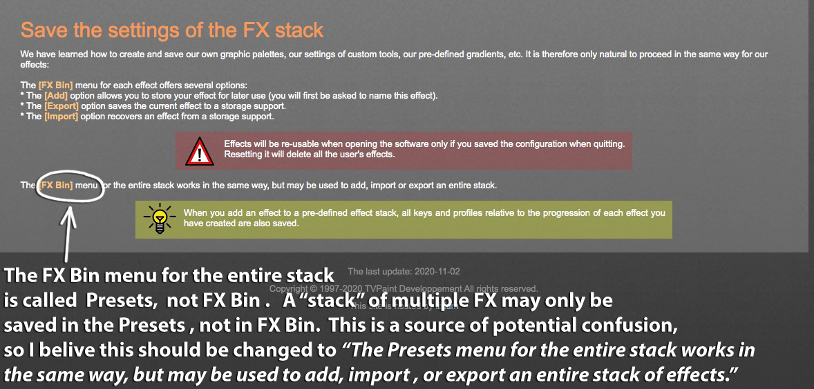

In the user manual it says:
But what is meant by "FX Bin menu for the entire stack" should actually read Preset menu .
"The FX Bin menu for the entire stack works in the same way, but may be used to add, import or export an entire stack."
Re: FX Stack management
You're right, I'll fix this as soon as I can!
Also, the hover prompt for the Preset button and the hover prompt for the FXBin button are the same, implying they work exactly the same, but in reality, the functionality and the bins they manage are totally different. (really, the prompts don't usefully inform in ether case).
