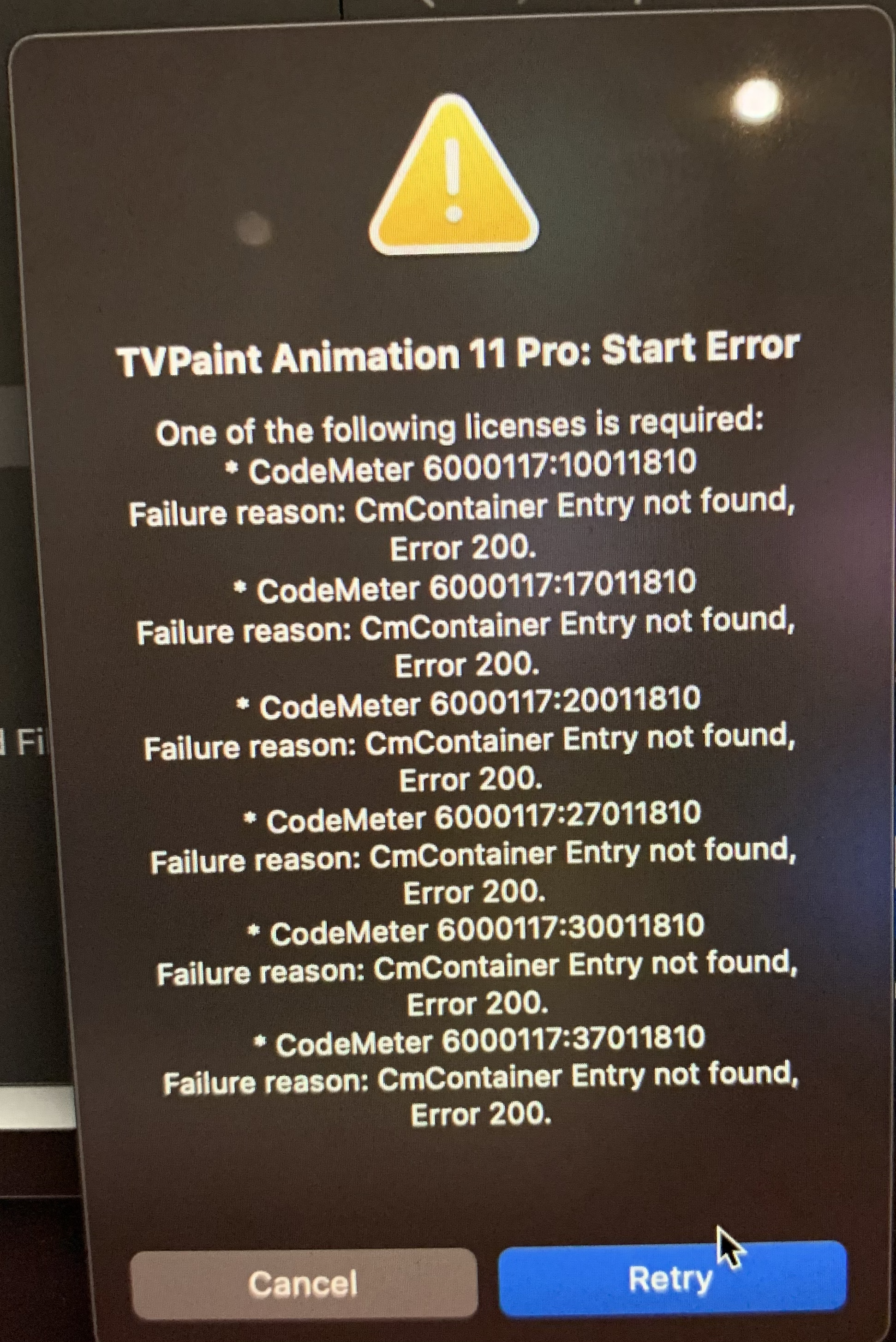

Re: macOS Big Sur and TVPaint Animation 11
This also happened to me, I installed the Post High Sierra.dmg and installed CmInstall.pkg, but once I open TVPaint, this appears:James Parker wrote: ↑30 Nov 2020, 20:56 Hello, I have tried to install the new 'Dongleless' version of TVPaint 11.5 on my Macbook pro compatible with Big Sur, but when I log onto my TVPaint account and download and install the 11.5 software it does not function and errors appear. I believe because the older version of TVPaint 11 dongle needs to be sent back and then I can download a working update or version of TVPaint? Otherwise my account update version is not compatible with my system, I have plenty of memory and I authenticate the download; its the install driver that has errors I believe? Some advice would be appreciated because they email also says I have 30 days to claim the updated version. Thanks -JP
Hello MarierV,
I saw that the license hasn't been activated from your personal link (Webdepot) yet. Also, Codemeter must be running during the activation from the Webdepot.
Thank you! Since I was also passing some emails regarding the driver, I had almost forgotten about that Webdepot email :v
Just installed TVPaint and it's working perfectly ^^
