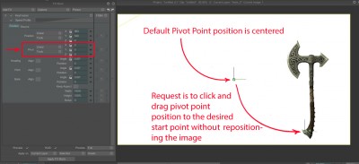

Now , 8 years after the original request I'm inquiring if this request is still on the To-Do List ? Here at the end of 2020 I'm bumping up this topic again to request that the behavior of setting the Pivot Point in the KeyFramer would be improved as requested previously in 2012 and 2015. Many improvements in TVPaint have been implemented since that time, but this requested improvement would still be enormously beneficial to improving the usability of the KeyFramer.
Default pivot point in the Keyframer is centered. The feature request is to be able to click and drag the pivot point to the desired position without changing the position of the image.
To illustrate the problem, see the attached screen capture video. To set the Pivot Point one must adjust the Pivot X - Y parameters in the KeyFramer FX , but doing so moves the image , not the pivot point ! Then after having set the pivot point to the desired position it is now possible to click-and-drag the image back to it's approximate original position (which is not precise, you just have to "eyeball it" to get it back to where it started) It would be so much easier and intuitive if the image stays in place and you click-and-drag the pivot point to set it to the desired position !

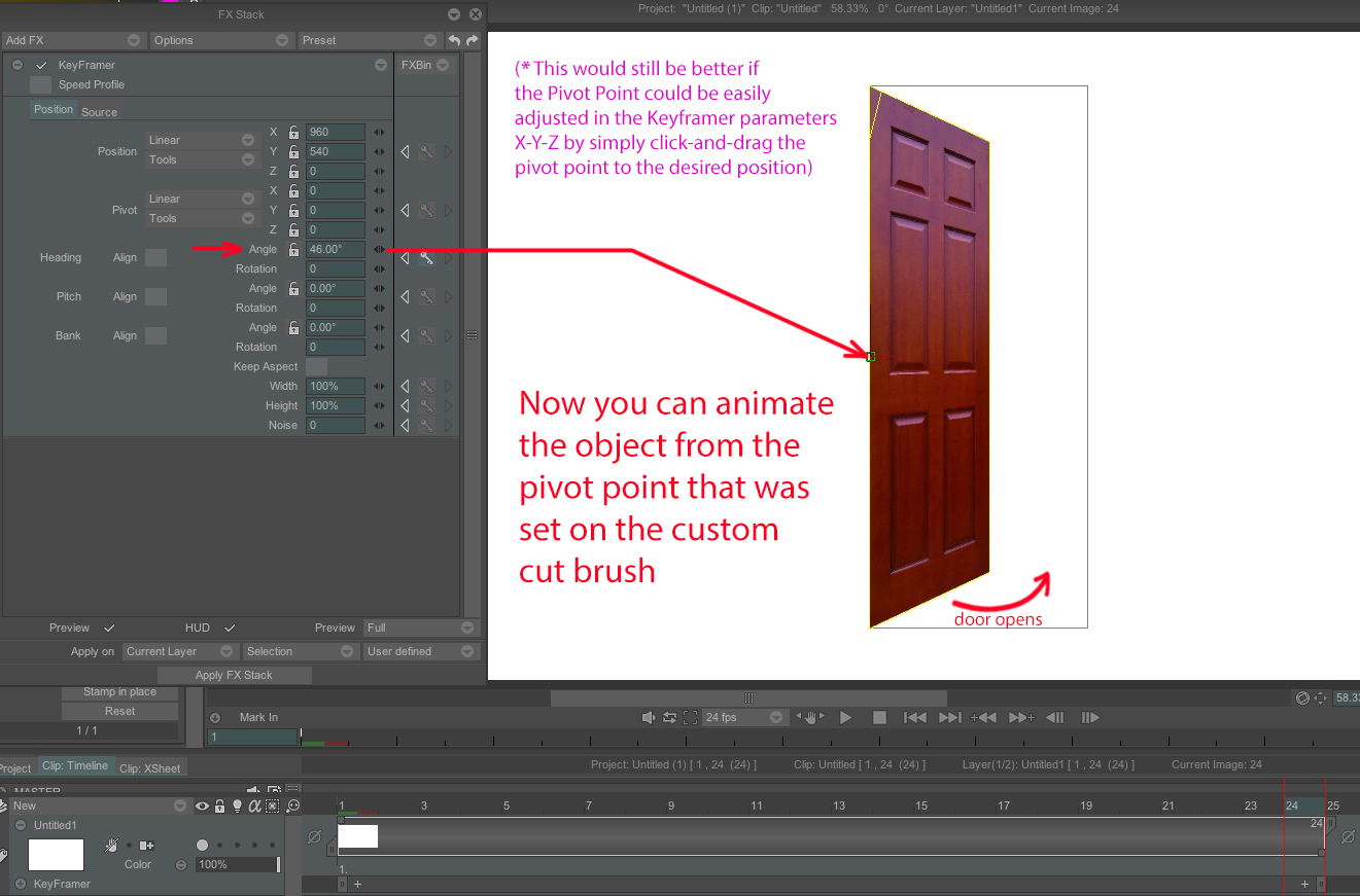

In another forum thread the workaround for setting up the Pivot Point mentioned by Peter Wassink works, so I wanted to mention this workaround for anyone else who happens to come across this topic. See here:
viewtopic.php?t=13627#p121057
This method does work, but I contend it would still be better if the Pivot Point could be easily adjusted in the KeyFramer parameters X-Y-Z by simply click-and-drag the pivot point to the desired position, which would allow using a Layer as the Source or an Image in the Image Library as the Source in the KeyFramer, if the Pivot Point could be set without having to shift the image around when setting the pivot point, then try to reposition the image back to it's original position after the pivot point is set.

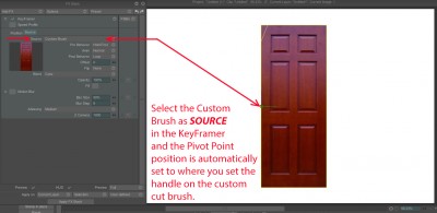

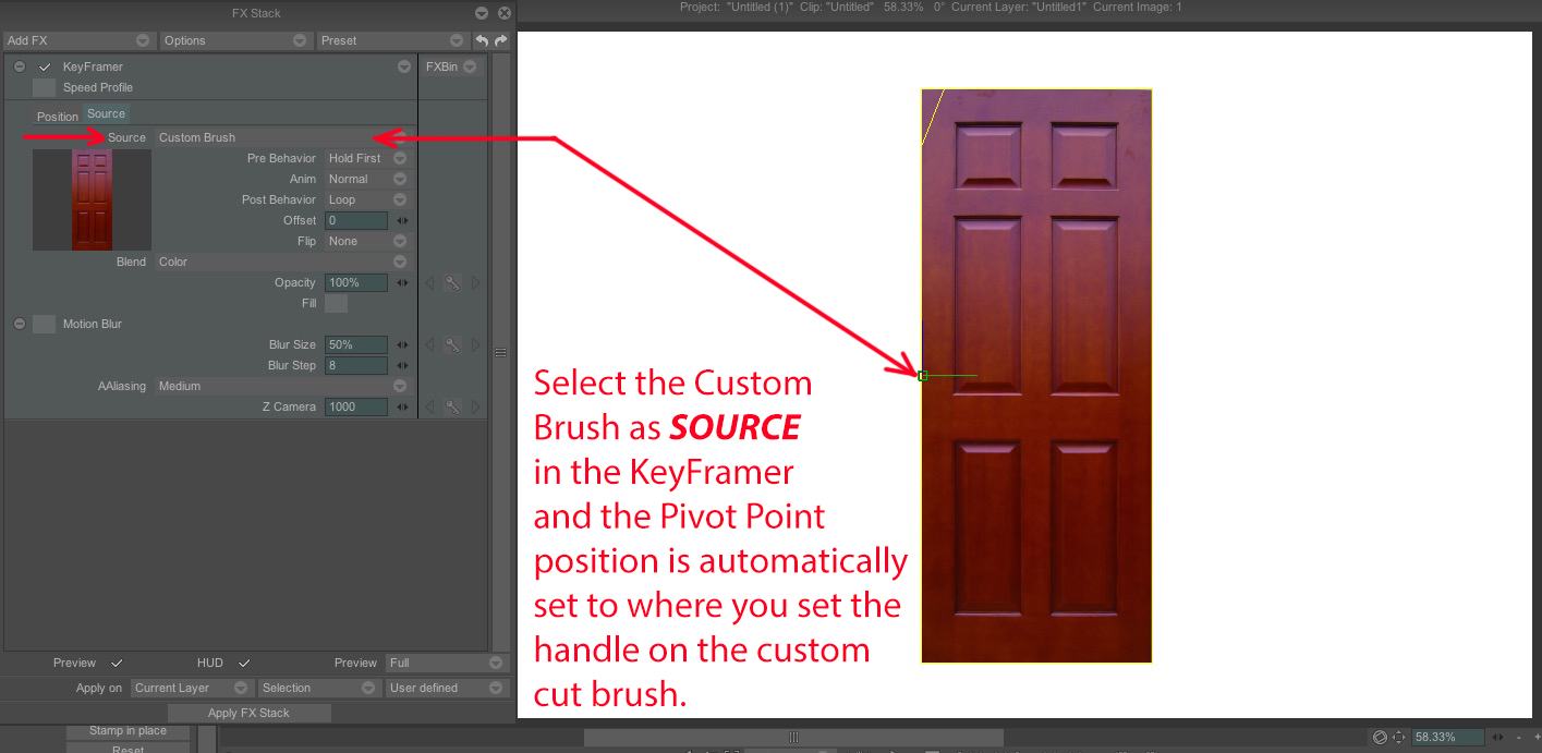

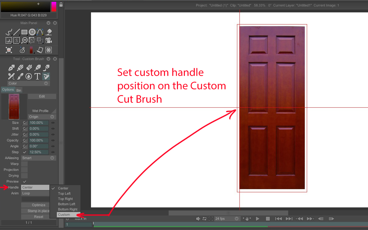

If your FX Stack Source is a custom brush you can adjust the pivot point by creating a custom handle in the Custombrush tool panel.
That is relatively quick, albeit not pixel precise. I sometimes even go so far as to load a complete animation as a custombrush, just for this purpose.
