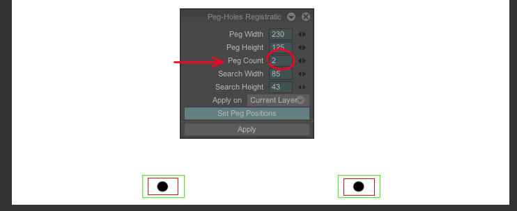

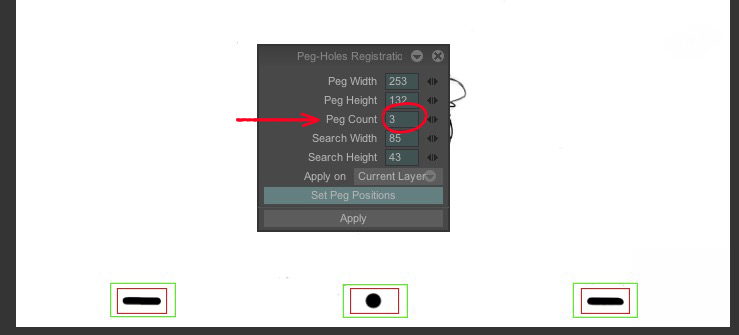

I wanted to mention the new Peg Holes Registration in TVPaint 11.5 is working fine. I'm glad you added the feature to specify the number of peg holes to register, so it works better with either the standard 3-hole Acme Pegs (one round peg, two oblong pegs) or , a two round peg system or three round peg system.
TVPaint Peg Hole Registration 3 pegs.jpg (47.33 KiB) Viewed 17243 times
TVPaint Peg Hole Registration 2 pegs.jpg (41.92 KiB) Viewed 17243 times

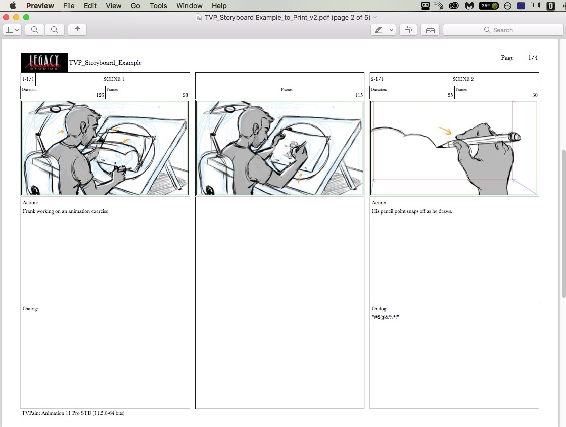

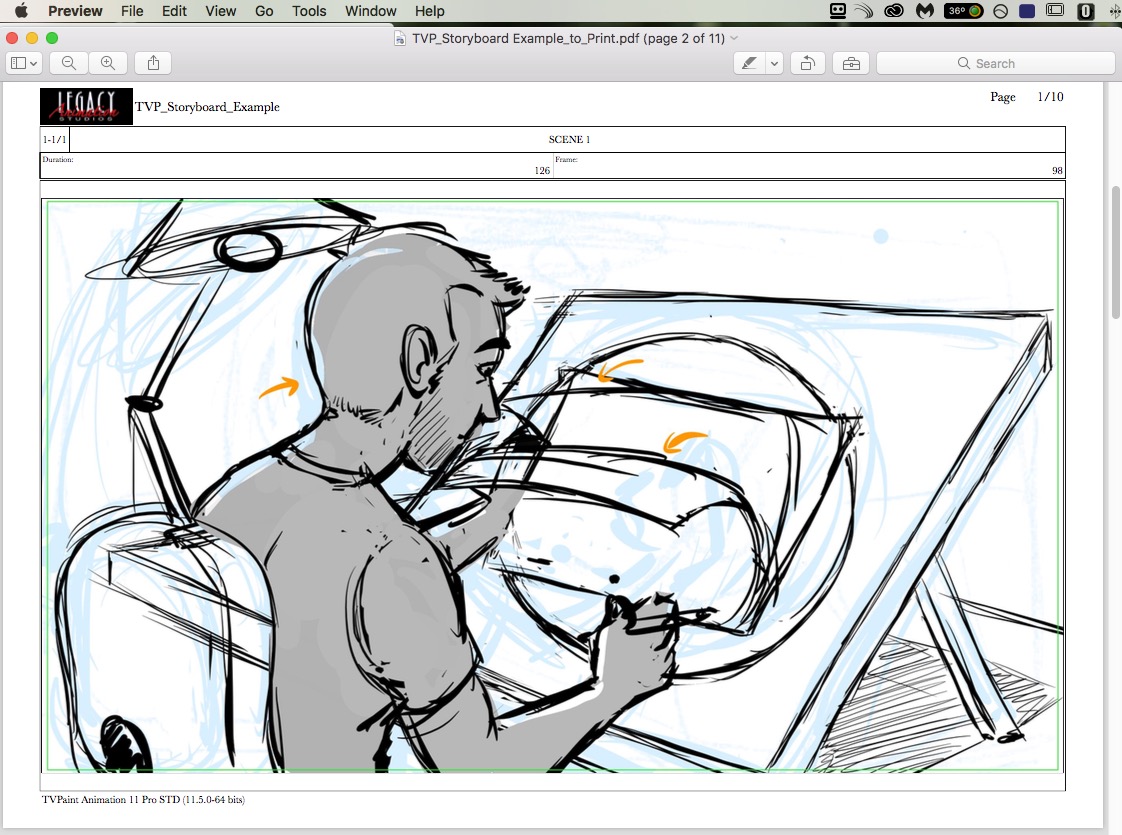

Another new feature I enjoy in TVPaint 11.5 (although I think it actually made it's debut in version 11.0.9 ) is the Export storyboard to PDF with only 1 storyboard panel (clip) per page. This is a feature I had wanted to have for quite some time (and a number of colleagues have mentioned it to me as something they would like to have) because believe it or not there are still some of us oldtimers who like to pin up our storyboards for display and for "pitching" the storyboards to a group. Being able to export to PDF and print out only one storyboard panel per page means the storyboards can be displayed at full size when pinned up on a corkboard for presentation.
1 Storyboard Panel (clip) per page -
instead of this presentation with multiple panels per page-
