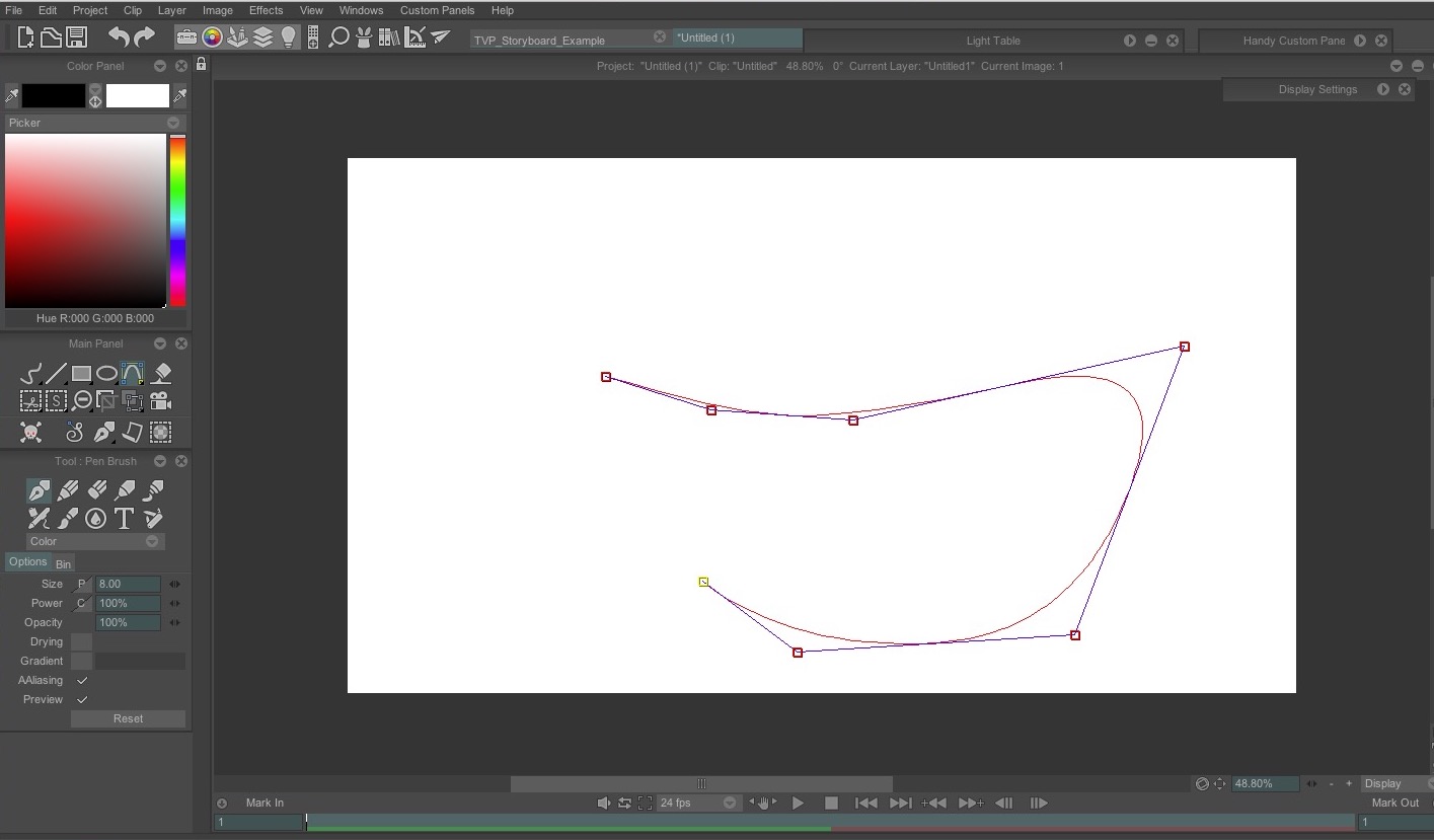

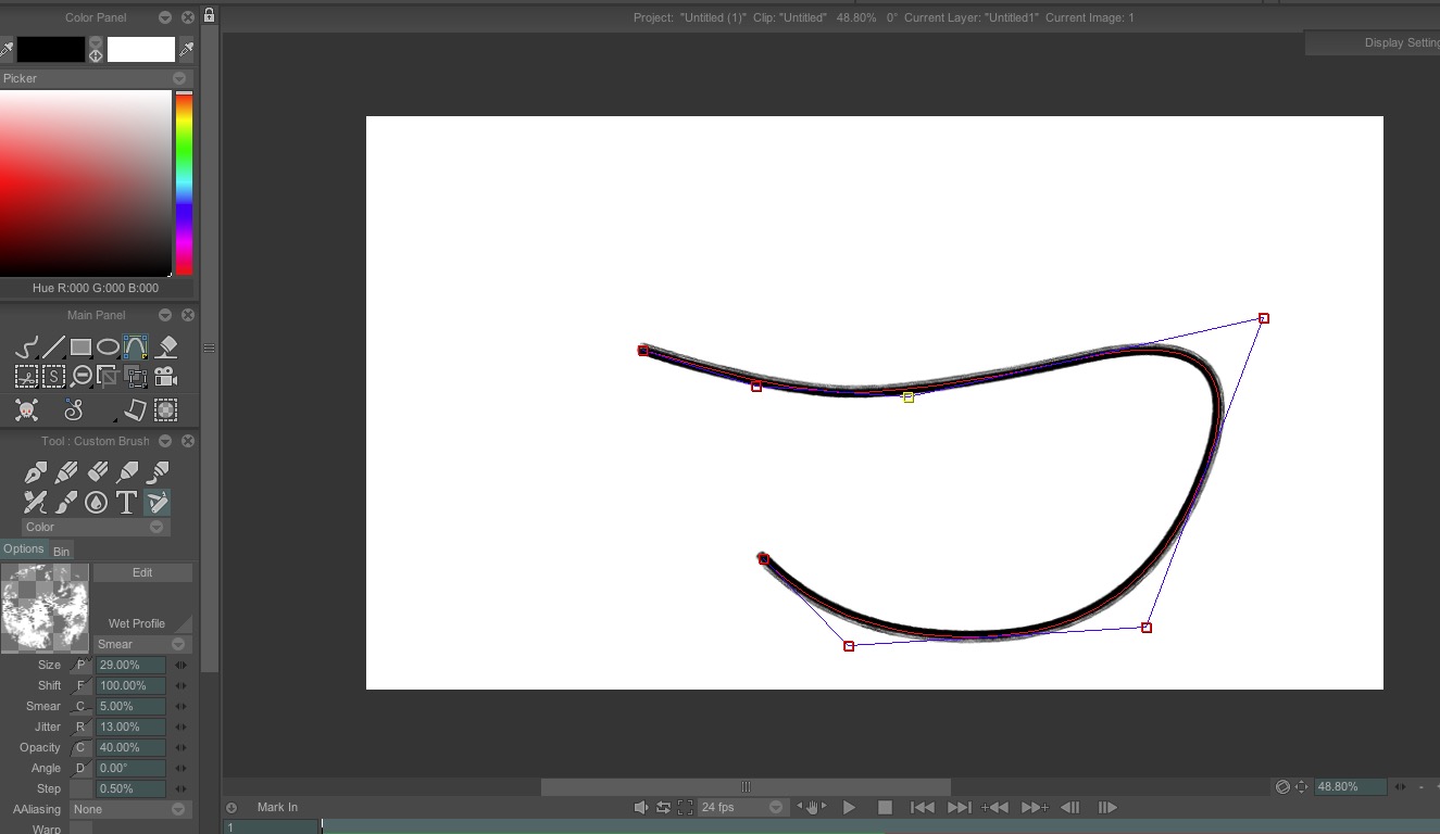

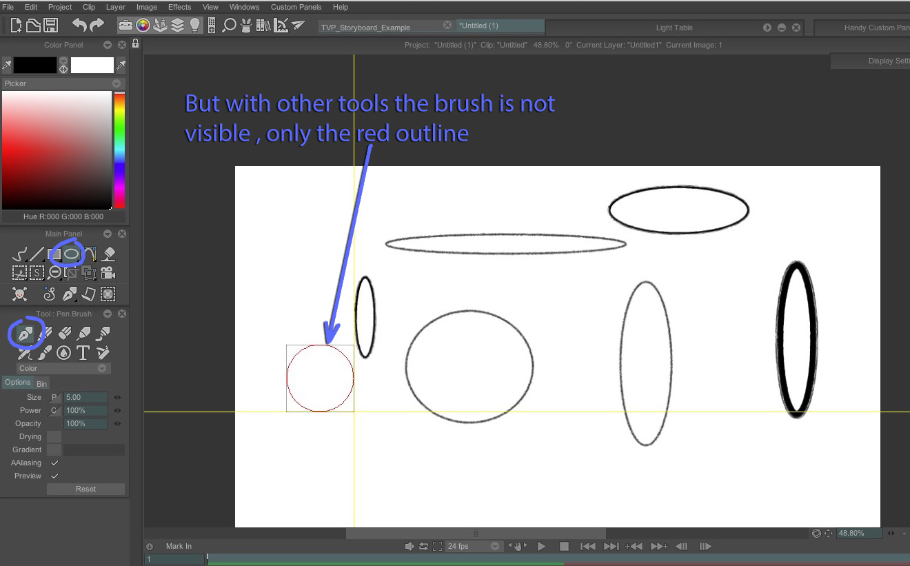

When I use certain drawing tools (brushes or pencils) with the Ellipse drawing mode or B-Spline drawing , I can see a preview of what the line looks like as I draw the ellipse or line , but with other tools there is no preview of the brush/pencil lone , only a thin red line showing the shape of the ellipse or the spline shape. The actual line only appears after applying the ellipse or spline by hitting the Enter/Return key.
Is there any way to allow for all drawing tools to have this preview mode when using Ellipse or Spline tools ? Screenshots show examples of the current behaviour.
It is easier to use Ellipse or Spline drawing mode if we can see the line as above ,
rather than only the red outline as shown in the image below.
