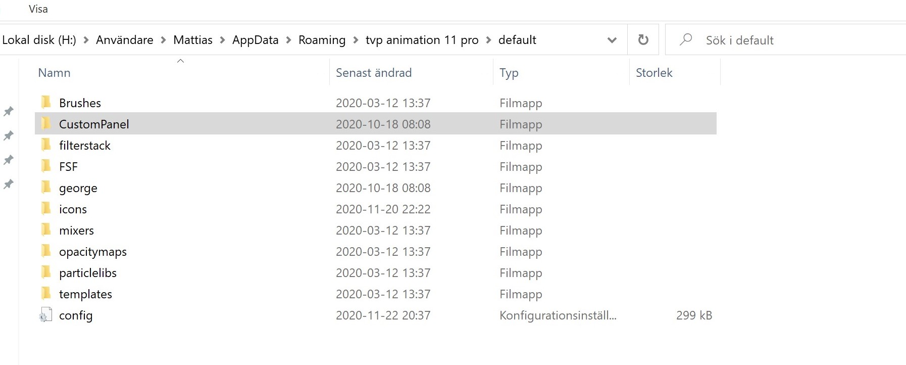

Hi,
My computer os id crash (based in old computer ) so I updated it into a fresh one.
All the files from the old computer i have on a harddrive so I am thinking of it I could copy in some of the old settings into the new installations.
Including cusstoms panels and short cuts.
Which files and folders should I replace?
/ Mattias

Have you tried to pick all of them ?
The config.ini file defines your settings, but it may reference external brushes or custom elements that are inside the subfolders.
hellofilms
Posts: 163
Joined: 12 Nov 2012, 12:13
Location: Älvkarleby, Sweden
Re: load config from crashed computer
Post by hellofilms »
That worked fine, Thanks!
