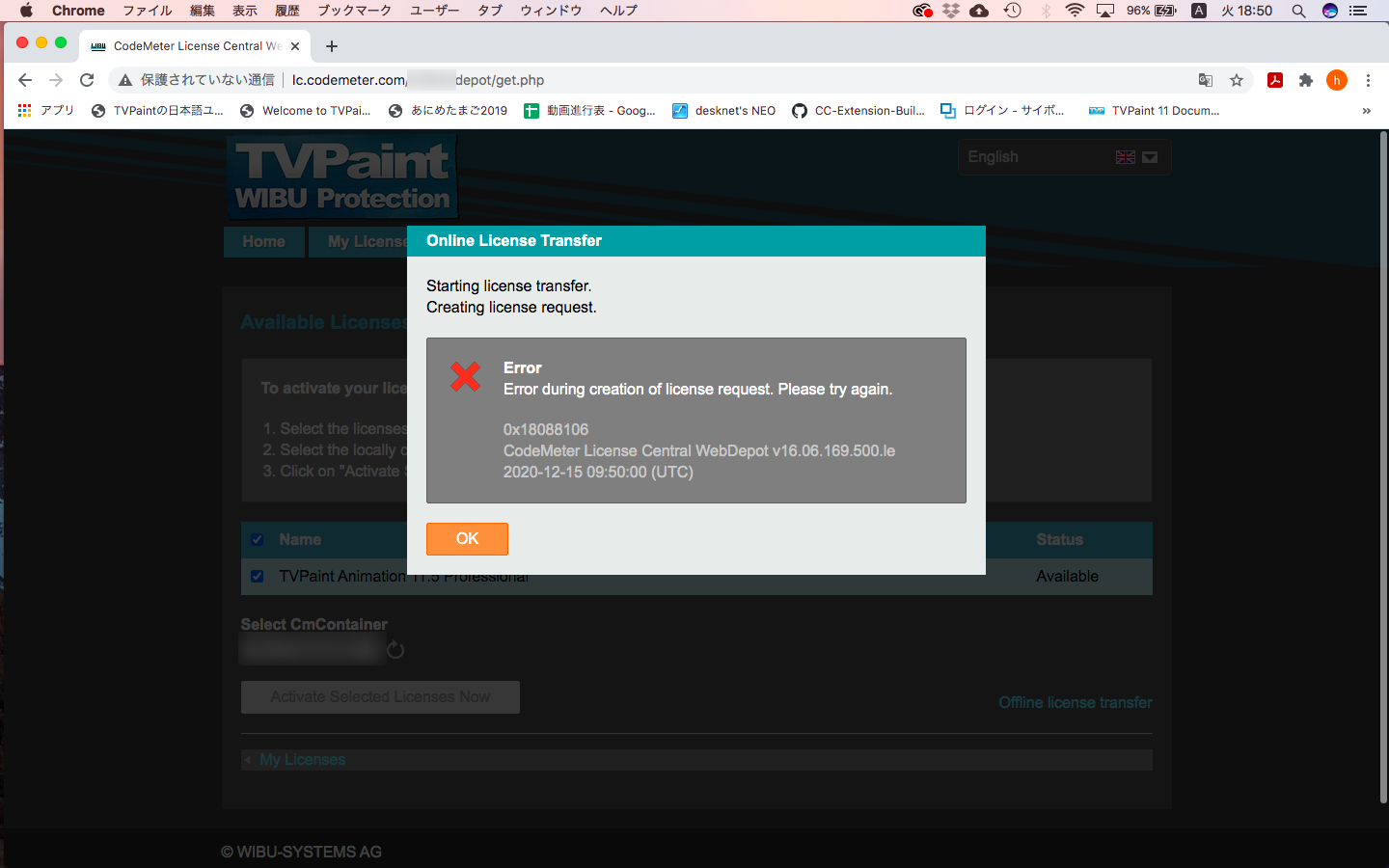

I have a MacOS 10.15 machine and a 10.12 machine,
so I tried to see if WIBU works on 10.12,
but the license container failed to move.
Do you know the cause?
CodeMeter Licenese does not work on MacOS 10.12

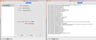

Thanks for advice.
I installed attached file and version, but not activate.
I attached condition and log of CodeMeter.
