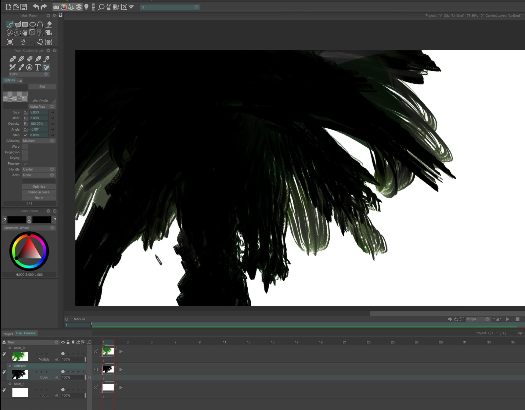

Hello. I recently started using different layer options. I have a question. What's up with the color? Is this a program error or am I not using the program's features correctly?
I have attached a video. Look here please.
color.mp4
(27.62 MiB) Downloaded 787 times

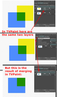

I think the issue you are describing is related to a longstanding problem with how TVPaint handles merging different blend modes, especially multiply blend mode layer with a normal color blend mode layer. This has been brought up several times in the past. For example , see this topic:
viewtopic.php?f=10&t=8738

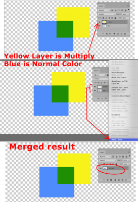

In that thread it was suggested that TVPaint's way of merging a multiply blend mode layer with color blend mode layer is the correct and expected behavior , but as far as I know only TVPaint behaves this way. If you try it in other programs like Photoshop, Autodesk Sketchbook , Artrage then you get a different result. In Photoshop, Autodesk Sketchbook , Artrage when you merge a multiply layer with a normal color layer it looks like this:
But in TVPaint this is the result:
I wonder why is it the same result when merging layers in Photoshop, Autodesk Sketchbook , Artrage (and other programs as far as I know ... those are three programs I am familiar with), but only in TVPaint it gives this result ?

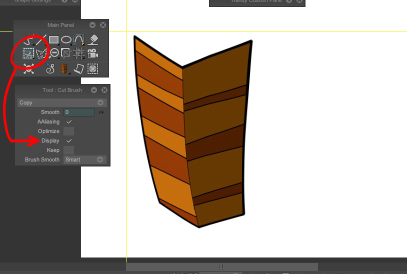

slowtiger wrote: 22 Feb 2021, 18:51 Custom Brush mode "display".
Oh, very nice ! I never noticed that on the Cut Brush. Thank you.

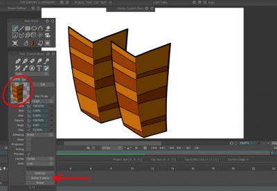

This Display image consists of four layers: Line with normal Color Blend Mode , Shadow layer with Multiply Blend Mode, Color tint layer with Soft Light Blend Mode, and normal Color fill layer.

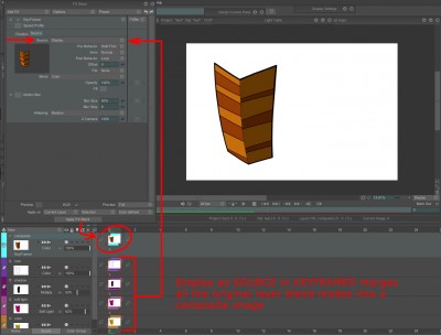

And now I see another way of merging a composite image with the blend modes intact: Use the *KeyFramer , with source set to DISPLAY.
(*Sadly, this method of compositing with the KeyFramer does not work if the source images do not include at least one layer (on the bottom layer under the blend mode layers) which is a normal Color blend mode image. If the images are only in blend modes such as Multiply they do not appear in the KeyFramer . See this topic for more discussion of the issue: https://www.tvpaint.com/forum/viewtopic ... 21&t=13271 )

It works fine. - - EDIT: Well, unfortunately, it does not work (at least not for all cases). See my follow-up post HERE with a further explanation. - - See the post above this one. Slowtiger supplied the crucial information: use the CutBrush with the mode set to Display. It will pick up all the layers with the blend modes intact. ( EDIT: IF the blend mode layers are over top of a normal Color layer, as in the example I posted. Otherwise blend mode layers will be clipped if they are outside of the Color layer)

In that case only TVPaint has the merged results where the merged image is clipped . When merging layers with different blend modes (multiply, etc.) in Photoshop, Autodesk Sketchbook, ArtRage , the merged image is the whole image , it is not clipped as in TVPaint.
