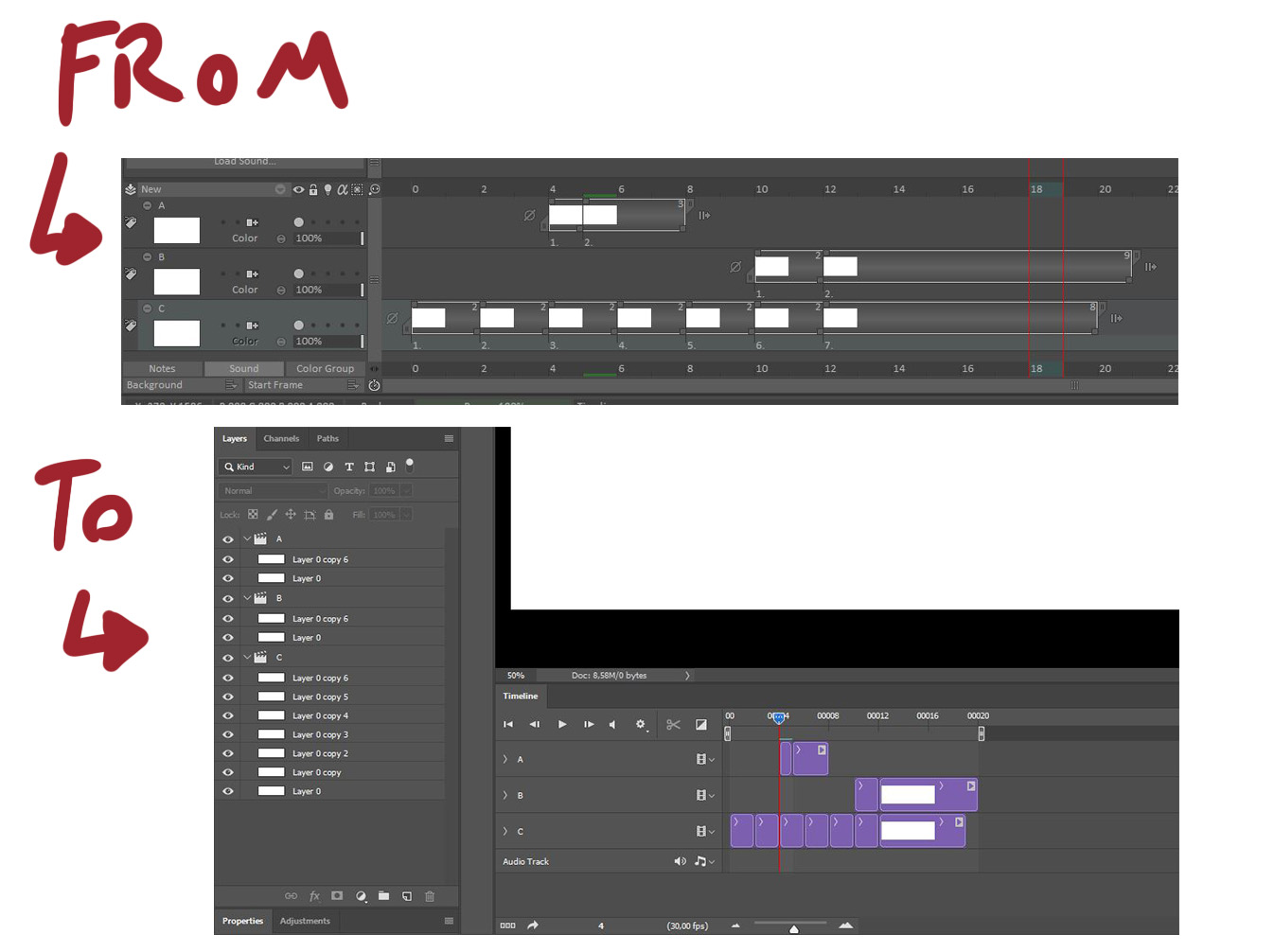

It would be great to have any way to export a Tvpaint project to a PSD file with the same layer composition.
For those cases when you want to make the clean up or color with photoshop, but you still want to animate in tvpaint

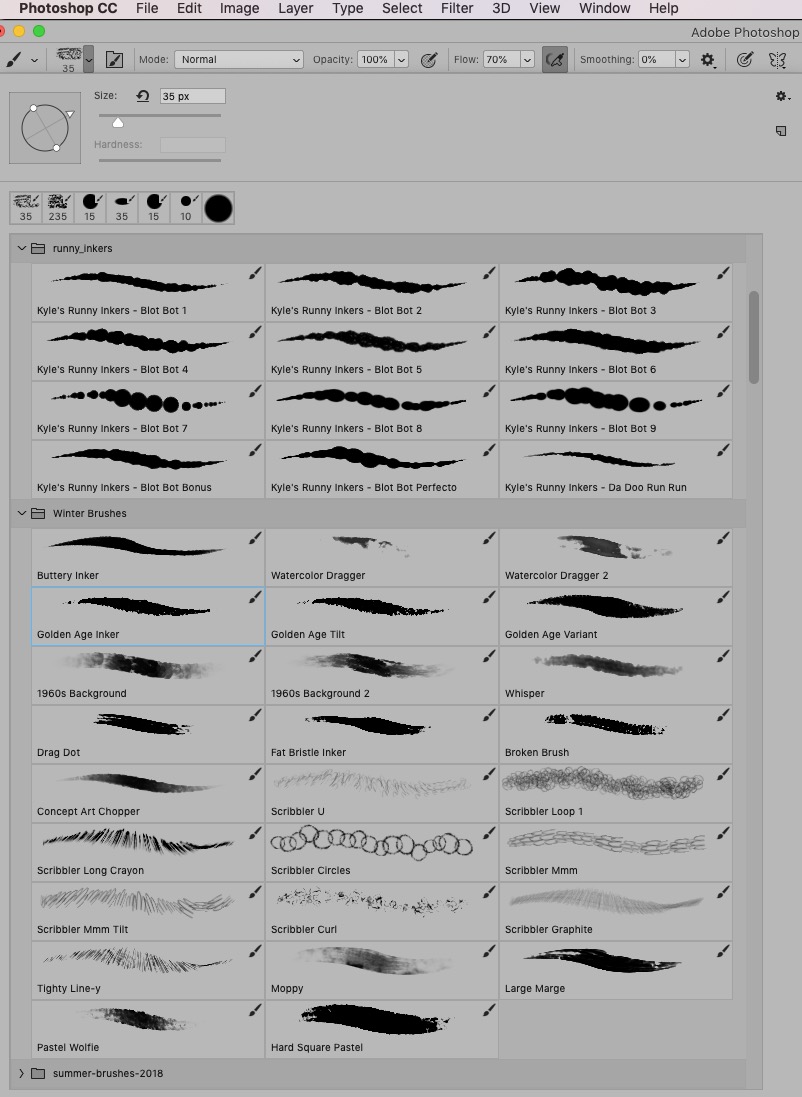

Which one of Kyle's Brushes (a few shown here) are you using to get the line quality shown above ?

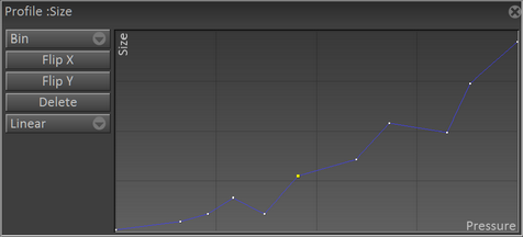

Another suggestion for customizing brushes: Experiment with the Profile Editor curve for SIZE. zigzagging the value for multiple Y points along the curve can vary the line thickness in interesting ways based on Pressure.
Profile Size - Y axis.png (20.27 KiB) Viewed 20777 times
