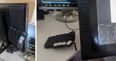

A few years ago I wished for some buttons on the back of my cintiq companion to use my index finger and ring finger to flip faster between the last and the next frame. Since I couldn't find something except of the overpriced X-keys I made the (bad) decision to build something myself and dived way too deep in the mechanical keyboard community rabbit hole. Currently I use the left half of a bluetooth split keyboard on the back of my Mobile Studio and another splitkeyboard on my regular Cintiq. But I probably dived already way to deep in this topic.
A much cheaper and more versatile option than one of the long X-keys would be a "Butter Stick", which can be bought ready to use for $55 and can be configured with this online configurator or with Controllermate

In this case butterstick is probably the better choice. It runs a software called QMK, which is the most popular in the keyboard community. You can use the web configurator to map the keys, download the file, press the tiny reset button and then load the downloaded file onto it using a little tool called QMK toolbox. If you really choose the butterstick make sure you buy the Butterstick ready 35g and feel free to send me a message if you stuck somewhere in the process.

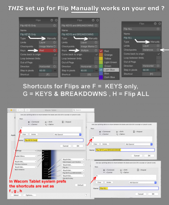

Re: Assign FLIP shortcut keys to Wacom Express Keys
Xavier wrote: 05 Mar 2021, 18:17
D.T. Nethery wrote: 05 Mar 2021, 17:48 Yes, it is only Flips shortcuts that are the problem. If I assign f to "TVPaint Animation: About" (or any other function) it will work when the Wacom Express Key button is pressed.
Xavier wrote: 05 Mar 2021, 17:40 But what now if you assign another button, like J or K to the Flips shortcuts ?
Ok, I assigned J and K to Flips shortcuts. It is the same result as with F or G. It works from the keyboard when pressing J or K , but when pressing the Wacom Express Key button it does not work.
It would make me crazy too :shock:
That said, we tried to reproduce the behaviour you describe, without "success" : the keyboard shortcuts worked when pressing the tablet buttons.
The keyboard shortcuts worked when set up for Flip Manually ? It worked for you with F key for Flip KEYS only (i.e Red Image Marks only) , G key for Flip KEYS and BREAKDOWNS (Red Image Marks and Blue Image Marks ), H key for Flip ALL (flips manually through all drawings on the timeline) ? Was the test done on Mac OS or Windows ? (or does the operating system make no difference with regard to how shortcuts are triggered by Wacom Tablet Express Keys ?)
For me the Basic Flips works , Directional Flips works , but Manual Flips does not work when pressing the Wacom Tablet Express Key buttons. User schwarzgrau confirms that my Flips shortcuts also do not work for him with Wacom Express Keys:
schwarzgrau wrote: 05 Mar 2021, 16:46 By the way I tried It and it doesn't work for me too to use the flip shortcut on the Expresskeys.

To summarize what I know from my own tests with my Wacom Cintiq 21UX and Macbook Pro running Mojave (supplemented by tests run by schwarzgrau on both a Windows computer and Mac computer) -
  • It does not seem to be a hardware issue. The Wacom Express Key buttons work to trigger their assigned shortcuts in every other software I use , including Harmony, Photoshop,
    Autodesk Sketchbook , and ALL other TVPaint shortcuts , except for Flip Manually shortcuts.
  • Flip Basic works with the shortcut assigned to Wacom Express Key.
  • Flip Directional works with the shortcut assigned to Wacom Express Key.
  • Flip Manually does not work with the shortcut assigned to Wacom Express Key on Mac,
    but does work on Windows.
  • All three Flips modes , Basic, Directional, Manually work fine when executed from pressing shortcut keys on the keyboard (on both Mac and Windows)
    but Flip Manually shortcut will not work when the shortcut is triggered by pressing Wacom Express Key button on Mac (but does work on Windows).
