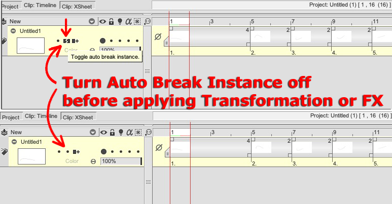

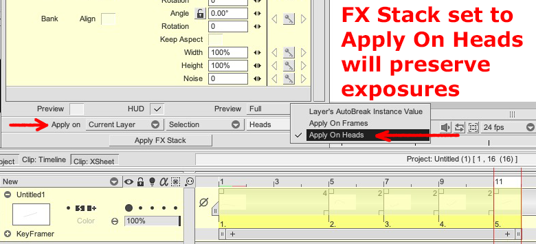

Before you apply the transformation toggle off Auto Break Instance . Also, with FX Stack you can set it to Apply On Heads instead of Apply On Frames.

Thanks for the reply D.T., it gave me extra insight in the use of the auto break instance functionality. But it only shifts the problem over to another place. There still needs an extra manual action to be done.
I tried to create an action by:
1. toggle auto break instance. or alternative: inactivate auto break instance
2. transform.
3. toggle auto break instance. or alternative: activate auto break instance
But it did not work. Apparently when executing actions TVP neutralises 1 and 3 (since they oppose each other) instead of following the order of the script.
Without step 3 it leaves me with the auto break instance option in the wrong position which then has te be reset manually.
2. transform.
